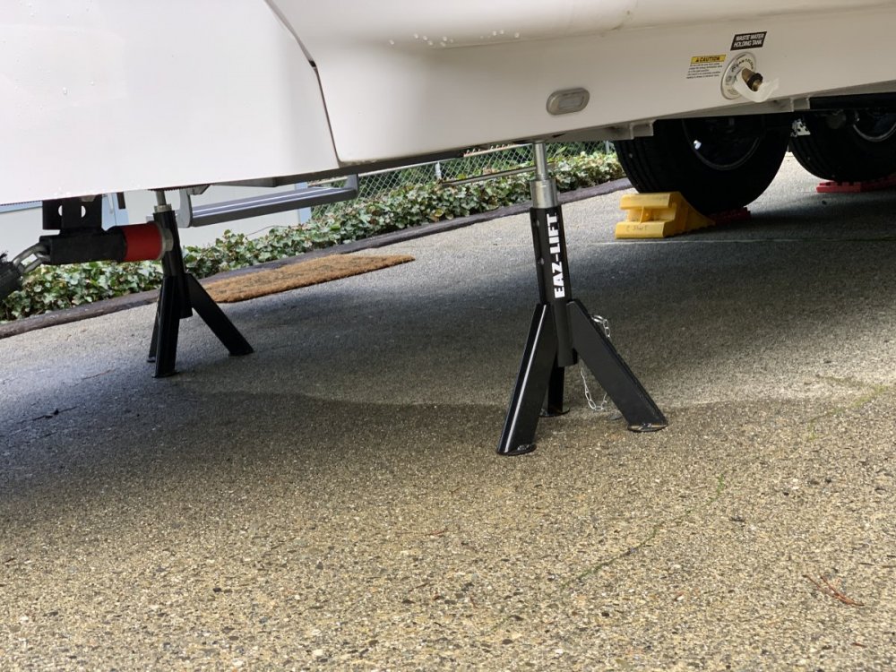

Galway Girl Posted February 12, 2020 Share Posted February 12, 2020 (edited) I don't normally use these in the field as the 3 point jack system works very well for stabilization along with the X-Chocks. Since we have several visitors a month to our Oliver, I began using these Eaz-Lift Screw jacks on the front frame to help with movement while 4 people are crammed in and walking around our Oliver EII. They work well... I've added them to the Amazon list we've created for all of the Oliver Outfitters in the forum: Link here: Oliver Trailer Outfitters List on Amazon Craig & Rose Hull 505 -Galway Girl Edited February 12, 2020 by ctshort09 1 2019 Elite II (Hull 505 - Galway Girl - August 7, 2019 Delivery) Tow Vehicle: 2021 F350 King Ranch, FX4, MaxTow Package, 10 Speed, 3.55 Rear Axle Batteries Upgrade: Dual 315GTX Lithionics Lithiums - 630AH Total Inverter/Charger: Xantrex 2000Pro Travel BLOG: https://4-ever-hitched.com Link to comment Share on other sites More sharing options...

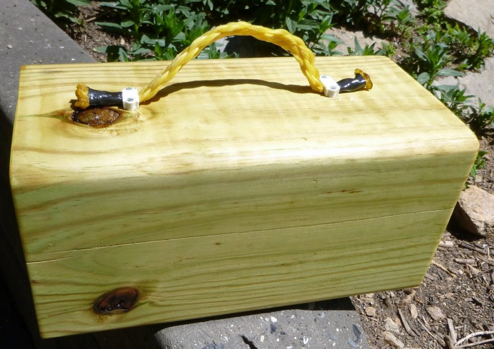

Nan Posted February 13, 2020 Share Posted February 13, 2020 1 hour ago, Mike and Carol said: It’s not a big deal for us. For those that are bothered by it carrying extra jack stands is probably worth having. The more we camp the more we go with “less is more”. I’ve got two sets of the the yellow legos (20) and three homemade 6X6X8” blocks that are carried in the aluminum tongue box. This has been enough to fix almost all leveling situations. Mike Mike, how do you set the blocks? Do you put the leveler on the 6" side or the 8" side? Thanks, Nan Link to comment Share on other sites More sharing options...

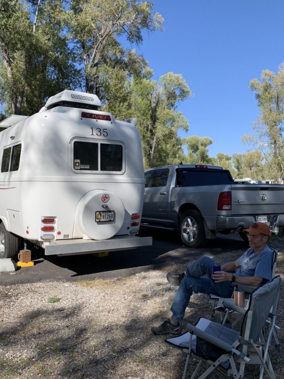

Moderators Mike and Carol Posted February 13, 2020 Moderators Share Posted February 13, 2020 I use the legos under my homemade wood blocks. The blocks are 6X6X8”, so they stand 8” tall. I use as many legos as needed to lift the block to within an inch or two from the jack. That saves wear and tear on the jack and reduces battery drain when we’re boondocking. Here’s a picture when we were at Grand Teton National Park in September, you can see the back jack with legos and my block. 1 Texas Hill Country | 2016 Elite II #135 | 2020 Ram 2500 6.7L Link to comment Share on other sites More sharing options...
Moderators topgun2 Posted February 13, 2020 Moderators Share Posted February 13, 2020 Nan - Of course, in situations where the height of the 8 inch block that Mike uses might be too tall, he can always simply turn that block on its side thus reducing its height by approximately 2 inches. Probably that is the reason he's smiling in the picture? Bill 2023 Ford F150 Lariat 3.5EB FX4 Max Towing, Max Payload, 2016 Oliver Elite II - Hull #117 "Twist" Near Asheville, NC Link to comment Share on other sites More sharing options...
Moderators Mike and Carol Posted February 13, 2020 Moderators Share Posted February 13, 2020 6 hours ago, topgun2 said: Probably that is the reason he's smiling in the picture? He’s smiling because it’s the middle of September, the weather in Wyoming is beautiful, we snagged a very nice site at Gros Ventre campground and I’m sipping a nice wine. Oh yeah, and because of the versatility of the blocks. 😆 1 Texas Hill Country | 2016 Elite II #135 | 2020 Ram 2500 6.7L Link to comment Share on other sites More sharing options...
Nan Posted February 13, 2020 Share Posted February 13, 2020 Thanks, because my grandson said he didn't think I needed to put the leveler pushing down with the grain of the block. He said I should put it on the 6" side. Not going to argue with him, but I just didn't know.🙂 Link to comment Share on other sites More sharing options...
Moderators Mike and Carol Posted February 13, 2020 Moderators Share Posted February 13, 2020 2 hours ago, Nan said: Thanks, because my grandson said he didn't think I needed to put the leveler pushing down with the grain of the block. He said I should put it on the 6" side. Not going to argue with him, but I just didn't know.🙂 My blocks are not a solid piece. I had an old pressure treated 2X6 that I cut into 6” squares and then stacked them with screws and glue. I drilled through to add the yellow rope that makes grabbing them easier. Then I put on some outdoor stain. They’ve been pretty durable. Texas Hill Country | 2016 Elite II #135 | 2020 Ram 2500 6.7L Link to comment Share on other sites More sharing options...
Moderators topgun2 Posted February 13, 2020 Moderators Share Posted February 13, 2020 Nan - I assume that you are just using your jacks for stabilization and not for lifting the trailer to change a tire. If that is true then you should not have to worry about 6x6 blocks splitting no matter if you are with or against the grain of the wood. I rarely use my rear jacks. However, I almost always use one of these 6x6 blocks under my front jack. 1 2023 Ford F150 Lariat 3.5EB FX4 Max Towing, Max Payload, 2016 Oliver Elite II - Hull #117 "Twist" Near Asheville, NC Link to comment Share on other sites More sharing options...
