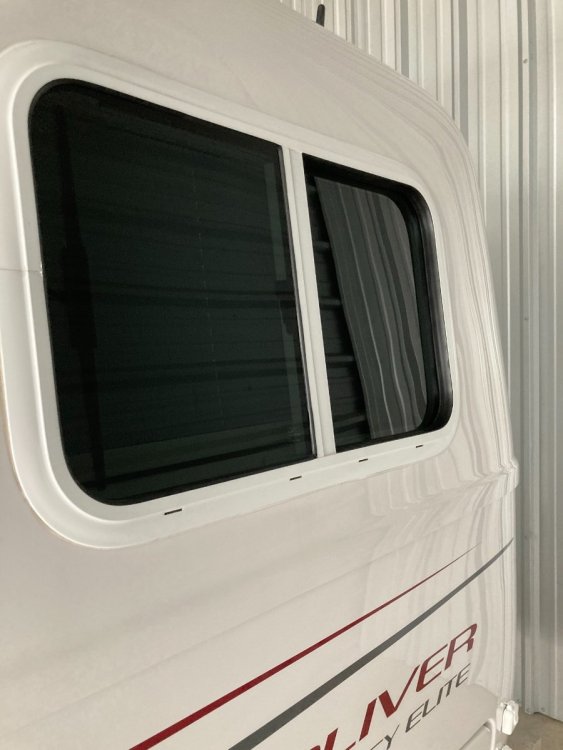

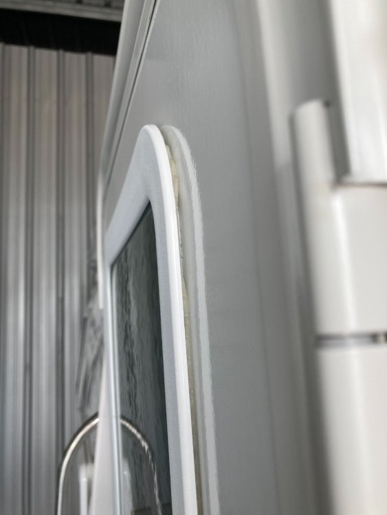

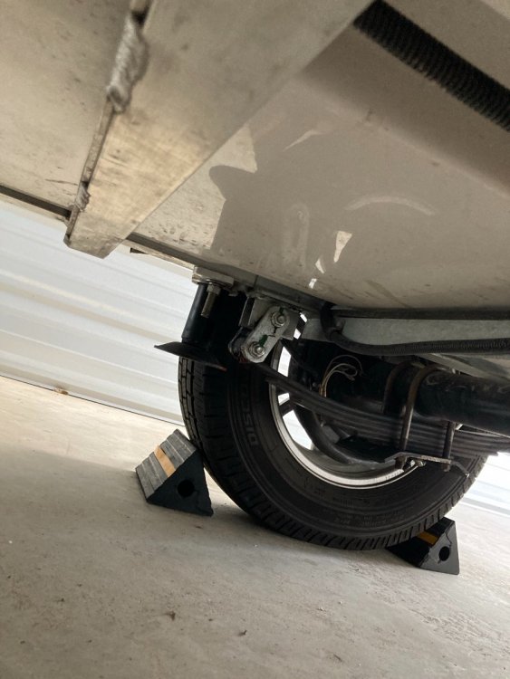

Popular Post QuestionMark Posted December 1, 2020 Popular Post Posted December 1, 2020 (edited) Oliver Owners, We picked up our new trailer (Legacy Elite I #664) on Sept 16, 2020 and have been using it on/off since this date. Overall, our experience has been wonderful and the quality of the trailer has been much better than what we have read about other manufacturers. In an attempt to help others with our recent learnings, I am listing some of the items were have learned about, fixed, and/or submitted a tickets for: Initial Pickup: - The bathroom interior window frame was bent due to being over tightened - Jason and the person showing us the trailer located a new frame and installed. - Window shade over the rear driver's side window had damage to the felt liner at the bottom of the night shade. - Orientation team replaced. First Night Camp @ Davy Crockett State Park: - Noticed that the propane alarm was not on. - Contacted Jason via telephone and he walked me through installing the 1A fuse that was included in the box of spare fuses provided. The fuse holder is located under the dinette seat and is somewhat hard to find as it is black and not easy to see. - Upon opening the rear compartment door, the bracket where the wire attaches to keep the door from swinging down came unglued. - Contacted Jason to let him know and he said they would send me some epoxy to fix. Ended up purchasing some a few weeks after getting back home as it never arrived. I let Jason know we no longer needed as I had fixed per his recommendation of Gorilla 2 part epoxy. - Shower floor squeaks a lot - Contacted Oliver Service and have a ticket for them to repair when we take the trailer back to TN for its annual checkup. According to Jason, the squeak is most likely from the shower tub not being cut correctly or the padding under it not installed correctly. No biggie for now as we have learned to live with it knowing that it will get fixed. If your spouse decides to use the bathroom at night, It will wake you up. No liquids right before bedtime. 🙁 First Long Drive from TN to AR: - Had someone flag us down and let us know that the rear compartment door had come open during travel. Upon pulling over and inspecting, we noticed that the screws had come loose on the latch and allowed the door to open with the latch locked close. I was lucky enough to have some blue lock-tight with me to use on the screws when retightening. No further issues experienced. We let Oliver know that this happened and they indicated that lock-tight should have been added to the screws at the factory. I am confident they put new procedures in place to keep this from happening again. First Time Back Home: - Spent time learning about the solar system, inverter, appliances, etc.... - Realized that both the Solar Controller and the Inverter were both set to flooded batteries vs. the AGMs we had installed. Changed both to AGM. No issues noted so not sure if it really mattered. Texas State Park Close to Home: - Noticed a small gap at the top of the external door window frame. - Contacted Oliver and was told that the frames are designed to click together but requires special plastic keys to take the frame off to inspect. From my reading this is a common thing from the door factories with the tabs getting broken. We tried several time to get the internal frame to snap together with the external frame. No luck. Contacted Oliver again and Jason said he would have a new frame (and plastic keys) sent to us so we can repair/replace. The suppliers are backed up, so it has now been two months with the door window frame and glass loose. I was successful in learning that there is a supplier zarcor.com that has the window frames (Lippert) in stock and can be purchased/delivered within a couple of days. We will most likely end up just ordering and replacing as they also offer a clear tinted glass and window shutter for the door. There is another post in this forum with pictures if you are interested. Being that this repair is taking a long time to get resolved, I would recommend anyone picking up their trailer inspect this and have it repaired before taking delivery. Arkansas State Park (Crater of Diamonds): - Upon arrival at the State Park we noticed that the trailer was squeaking loudly with every small bump in the park. Upon inspection, I did not notice any lose bolts, nuts, fittings on the suspension. We contacted Jason at Oliver and he had not heard of anyone having this problem before. We ducked our heads down and slowly made it to our campsite without disturbing the other campers throughout the park. We did get some stares tho with the squeaks. Once setup, I made a quick trip to the local hardware store to purchase a small grease gun/grease, 90-degree zerk fitting as the zerks are not accessible without having the pull the tire off, and some dry lube spray. Utilized to the stabilizers to take some weight off the trailer and utilized the grease gun. Fun fact - the top zerk fitting (wet bolt) that attaches to the frame bracket actually serves no purpose as the bolt is not contained within a bushing (Only on the single axle trailers). I would not recommend you go to town putting grease in this wet bolt as the grease will just exit the bolt and make a nice stream of grease falling on the lower spring eye. Not sure why dexter/oliver designed it with a wet bolt in this location. Sad part is that, the squeak we had was between the shackle and the trailer frame bracket and without the trailer bracket having a bushing there is no real way to get grease between the two. Only option at this point was to use the dry lube spray. Happy to say that this resolved most of the squeak until we could get back home (~400 miles). Upon getting home, I used a spray can of Fluid Film to spray down the area between the shackle and trailer bracket. No more annoying squeak! I have some pictures on another computer that I can attach at a later time if you are curious. Other trips - Nothing new to report beyond what has already been said above. Improvements - As recommended by others on this forum, we did go ahead and install the black window seals available on pellandent.com due to some of the white window seals had stains on them from the factory and were cut about 1" too short. I must say that the black seals look much better and should eliminate an excess amount of water needing to travel through the window drains due to them now being long enough. If you do a search on this forum for pellandent you will see some pictures posted by others. Once again, the point of this post is to inform others of our experience and to share some of the things we have learned. As with anything, enjoying life comes with opportunities to improve oneself and help others on their journey. Mark Edited December 3, 2020 by QuestionMark Added Elite I to title and fixed a couple of typos. 6 12 2020 F250 Lariat Supercrew 6.7 Diesel 4x4 2020 Oliver Legacy Elite I * Hull #664 (April 2, 2022 Incident) 2017 Oliver Legacy Elite II * Hull #293 (Purchased Used April 16, 2022) Located SE Texas Region

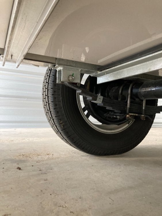

bhncb Posted December 1, 2020 Posted December 1, 2020 Regarding your rear spring hanger picture: Are the hangers both sides missing the bushing between the ears?

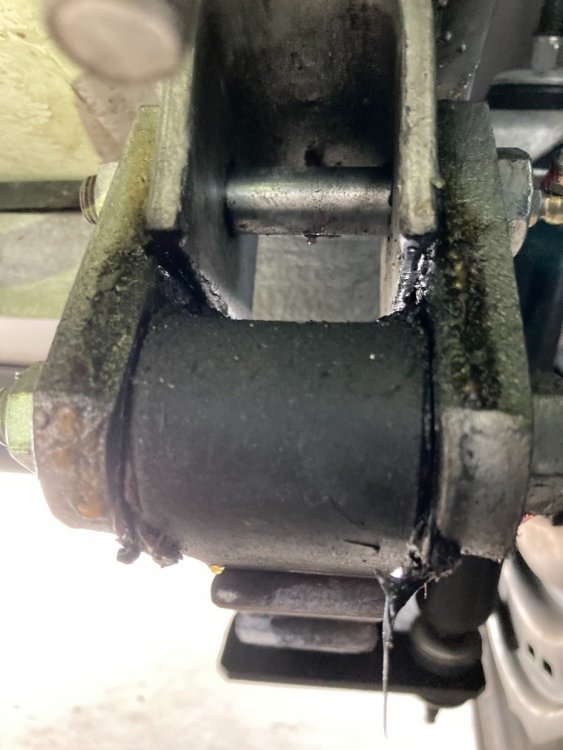

QuestionMark Posted December 1, 2020 Author Posted December 1, 2020 Yes, Neither side was designed with a hanger that has an integrated bushing. Dexter sells rear hangers with and without bushings. Not sure why Oliver went with the one without the bushing. Biggest concern is that the bolt and/or the bracket will experience some significant wear in the near future. I will be keeping an eye on how much wear occurs over the next few thousand miles. In the meantime I am in the process of purchasing some spare bolts to have just in case the bolt fails out on the road. 2 2020 F250 Lariat Supercrew 6.7 Diesel 4x4 2020 Oliver Legacy Elite I * Hull #664 (April 2, 2022 Incident) 2017 Oliver Legacy Elite II * Hull #293 (Purchased Used April 16, 2022) Located SE Texas Region
John E Davies Posted December 1, 2020 Posted December 1, 2020 (edited) You need to have your shackle bolts fixed, what you have described is not right or normal. All my wet bolts accept grease properly and all have bright cad plated bushings, so the grease squirts out to where it needs to go, between the moving springs and the shackles. Without a bushing the hole is open to the sky, as you discovered. Plus you cannot achieve correct bolt torque with no bushings, the nut threads will bottom out (damaging the nuts and the bolts) and the shackles can pinch the springs. As shown here, the bushings for the equalizers are pressed into those parts. You need to open a service ticket and have all your hardware inspected and replaced if necessary. At the very least all the nuts have to be replaced. If the shackles or springs are worn from contact, they also should be replaced. Oliver should pay for it. You can get a mobile RV tech to do it if possible, rather than leaving it at some idiot dealer. This is not something you should let slide at all, it needs to be correct. Ollies do NOT squeak and groan, it is a warning sign, a cry for help. The axle ubolts can and will bang hard against the frame, but the other parts, if greased properly, should be dead silent. OTH old style Andersen hitches can sound like the Spawn of Satan if the friction cone gets wet/ contaminated. Please keep us posted. John Davies Spokane WA Edited December 1, 2020 by John E Davies 2 5 SOLD 07/23 "Mouse": 2017 Legacy Elite II Two Beds, Hull Number 218, See my HOW TO threads: Tow Vehicle: 2013 Land Cruiser 200, 32” LT tires, airbags, Safari snorkel, Maggiolina Grand Tour 360 Carbon RTT.
QuestionMark Posted December 1, 2020 Author Posted December 1, 2020 (edited) Overland, On the single axle (my case) the shackle is installed on the rear hanger and the shackle then attaches to the spring eye. On the tandem axle the spring eyes attach directly to the hangers and therefore have the bushing. Here is a YouTube video of what I am talking about. Here is a photo of my front and rear hanger from the side. Edited December 2, 2020 by QuestionMark 1 2020 F250 Lariat Supercrew 6.7 Diesel 4x4 2020 Oliver Legacy Elite I * Hull #664 (April 2, 2022 Incident) 2017 Oliver Legacy Elite II * Hull #293 (Purchased Used April 16, 2022) Located SE Texas Region

bhncb Posted December 2, 2020 Posted December 2, 2020 1 hour ago, QuestionMark said: Yes, Neither side was designed with a hanger that has an integrated bushing. Dexter sells rear hangers with and without bushings. Not sure why Oliver went with the one without the bushing. Biggest concern is that the bolt and/or the bracket will experience some significant wear in the near future. I will be keeping an eye on how much wear occurs over the next few thousand miles. In the meantime I am in the process of purchasing some spare bolts to have just in case the bolt fails out on the road. Okay, there is no way to sugar coat this. The wrong hangers were used and your concern will be realized, on schedule. The only acceptable remedy is to replace these hangers. I'm confident OTT will be receptive to this. 1 2
Moderators SeaDawg Posted December 2, 2020 Moderators Posted December 2, 2020 I'm really sorry to read your list of troubles. Most items should have been sorted out before or at delivery . The single axle should not make noises. Ours doesn't, even after 100,000 miles. I'm sure Jason and his crew will get it all sorted out, but it's disheartening, I'm sure. 1 3 2008 Ram 1500 4 × 4 2008 Oliver Elite, Hull #12 Florida and Western North Carolina, or wherever the truck goes.... 400 watts solar. DC compressor fridge. No inverter. 2 x 105 ah agm batteries . Life is good.

QuestionMark Posted December 21, 2020 Author Posted December 21, 2020 (edited) Just a quick note to let everyone know that our new door window frame came in today. Happy to report that it was easy to replace and is now as good as new. Please note that you have to have special plastic "keys" to get the old frame to release and install the new one. Oliver had the "keys" sent with the new frame so I could replace without having to take the trailer anywhere for repair. After removing the old frame it was clear that the initial install at the door factory did not have the frames lined up correctly when pressing together, thereby breaking a few of the clips. As for the squeaky suspension, Jason is sending me some new bushings for the springs and new u-bolts/nuts as the factory installed ones were not "balanced" between the two sides. I will report back once I replace both and see if I am successful in eliminating the annoying squeak. On a lighter side, I think my wife and I have somewhat agreed to nickname the trailer as "Squeaky" due to the suspension and shower floor. Edited December 23, 2020 by QuestionMark 2 2020 F250 Lariat Supercrew 6.7 Diesel 4x4 2020 Oliver Legacy Elite I * Hull #664 (April 2, 2022 Incident) 2017 Oliver Legacy Elite II * Hull #293 (Purchased Used April 16, 2022) Located SE Texas Region
