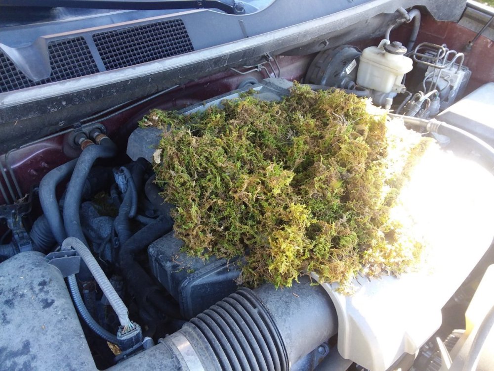

We live about 15 miles from Mcb.  Here is what I found under the hood of my 2008 Tundra in October of 2018.  Good luck settling things.
