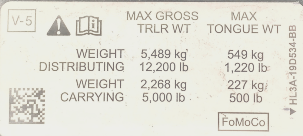

Welcome!   There are several critical towing capacity numbers you need to look at on your Ranger.  You mentioned one of them and that is your towing capacity of 7,500 lbs., but you also need to find out the following info, which you should be able to get from the Ford Towing Guide for the Ranger (link below), and from stickers/labels on your truck.    And the Andersen hitch is both a weight distribution hitch (WDH) and an anti-sway hitch.
- The tongue weight limits (both with and without a weight distribution hitch).  Look for a label on your hitch receiver on your truck.  See photo below from my F-250 for example.   Tongue weight is typically about 10% of the trailer weight.

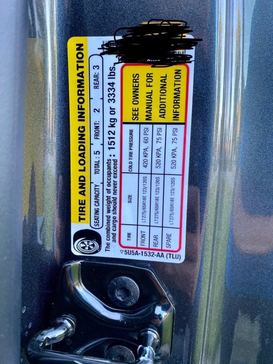

- Payload/cargo capacity limit (this will be on a yellow & white sticker on the door frame of your Ranger.  See photo below from my F-250 for example.  That number has to include your tongue weight, weight of driver and passenger and any luggage, the weight of any bed liner, bed cover or cap that you have, etc   Most people with smaller tow vehicles will exceed the payload limit without realizing it.

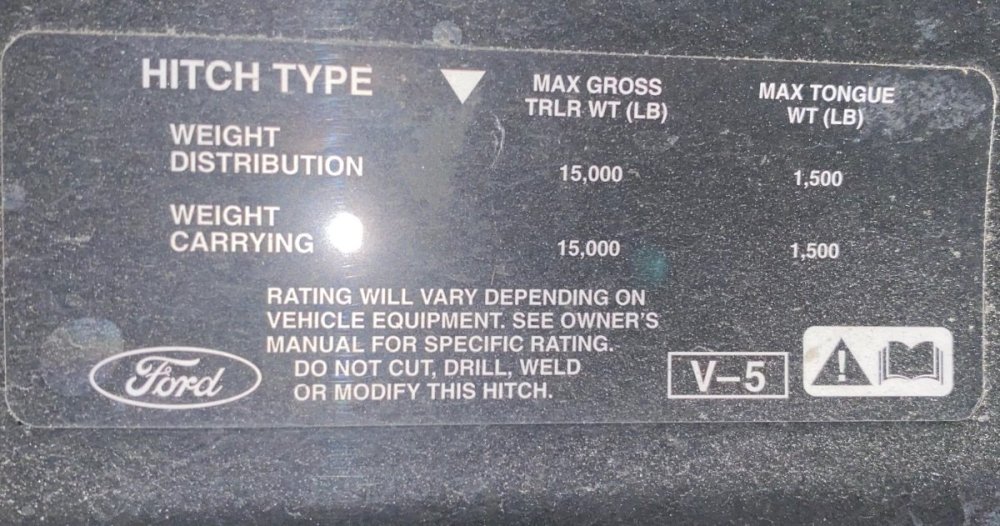

The Ford Ranger Receiver bolted into the frame will have a sticker stating two weights it can handle : Weight Distributing, and Weight Carrying:
Here's the example below from our  F150 Hitch:
The Weight Distributing number is the "MAX" you can have as a tongue wt. while using a wt. distributing hitch.
The Weight Carrying number is the "MAX" you can put on the hitch as 'dead weight' while not using a wt. distributing hitch.

As a practical matter, we upgraded from an F150 to an F350....not because of 'Towing Capacity' but because of the Payload Number.
Our F150 had a door jam payload sticker rating of 1557 lbs and a tow rating of 12,700 lbs.
We found after subtracting the Tongue Wt of our trailer we only had about 800lbs payload left for people, tools and cargo in the truck.

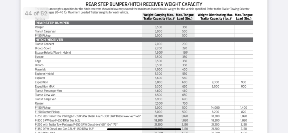

From Ford’s published 2022 towing guide.  The F-150 requires a weight distribution hitch for a trailer weight over 5,000 lbs. and/or a tongue weight over 500 lbs.   You will exceed both of those numbers with an Elite II.   Link attached to the full document.  Anyone towing a trailer should find and read the guide for their tow vehicle to fully understand the limits and risks.   And some hilarious assumptions that the manufacturers use to make their specs look better, like assuming a 150 lb. driver and passenger  😂.
https://www.fleet.ford.com/content/dam/aem_fleet/en_us/fleet/towing-guides/2022_Ford_RVandTrailerTowingGuide.pdf
