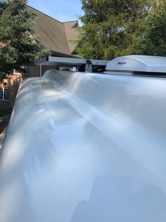

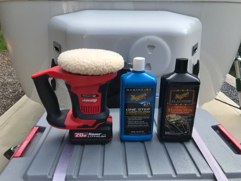

Yesterday evening I purchased this HF cordless buffer/polisher and honestly was very skeptical about how well it would work despite the very solid reviews. I thought for $30 why not give it a try?
I had light to medium oxidation beginning on the street side front roof top corner and all along the top of the street side roof which I wanted to remove. I have to admit my wife and I were both really surprised and pleased at how well this 4.83# buffer removed ALL the oxidation with ease using Meguiars #67. Our Ollies roof top now looks as good if not better than the day we took delivery. Note-  I never needed to replace the lithium battery during use.
As mentioned I used Meguiars #67 with a terry cloth polishing pad on this little buffer which easily removed areas of oxidation. I then followed up with a buffing pad after applying Meguiars Premium Marine wax. 💯 % satisfied and happy with the final results. Letting the buffer do the work, I really prefer to work smart not hard.😎
The buffer is light weight enough that you can actually use it with one hand (perfect). The ergos of the handle felt very comfortable as I never got tired of using it while working up on the ladder. Another thing I liked is I was able to use the buffer under the solar panel over hang a plus.
A 💯% keeper. Thanks to everyone’s buffer thoughts and suggestions, I have found what works really well for me at  a very reasonable price. I would not hesitate to purchase this buffer again as it really brought the shine and beautiful luster back to our gelcoat and saves a ton of elbow grease.
Happy Camping and Happy Polishing! 😊
A few photos -
This area had the beginnings of oxidation…it’s gone now. The shadows are reflected shade from our trees.
Very happy with the luster of the gelcoat completely restored to our Ollie.
Just clears the solar panel. 👍🏻
Terry cloth pad -
