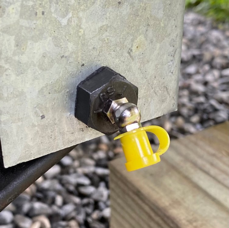

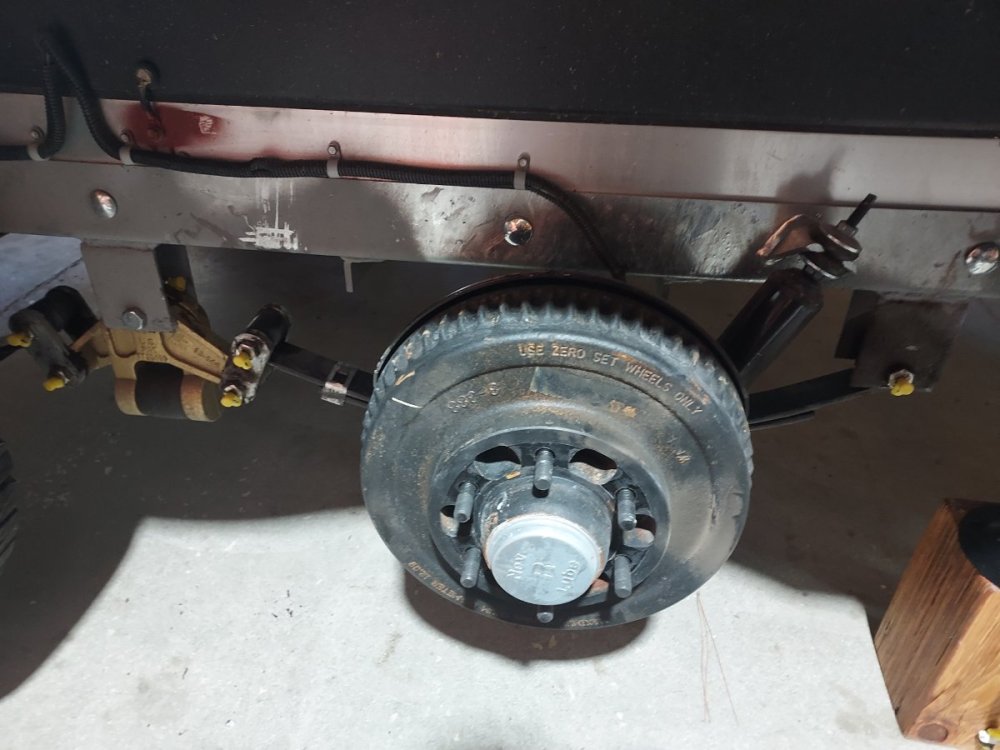

Those who do their own maintenance may wish to simplify periodic greasing of the suspension by installing zerk caps.  The caps keep road grime from coating the grease zerks, so you don't have to wipe them off each time you grease them.  The zerk caps on my tractor have saved a bunch of time, so I installed them on my Elite II suspension as well.
1609639448_RearZerkCaps.thumb.jpg.4af142dcaaec7d8c88087fe751251f6c.jpgYou must remove the wheels to install the caps, so they are most easily installed when already doing regular maintenance.
Zerk caps are available for $11 from Amazon, or from the manufacturer, LockN Lube.  Amazon link below:
https://www.amazon.com/dp/B0779K66DW/ref=dp_iou_view_item?ie=UTF8&th=1

I’ve been using Zerk caps for quite some time.  Cheap and effective.  I didn’t have to remove wheels to put them on or to lube.  Mike

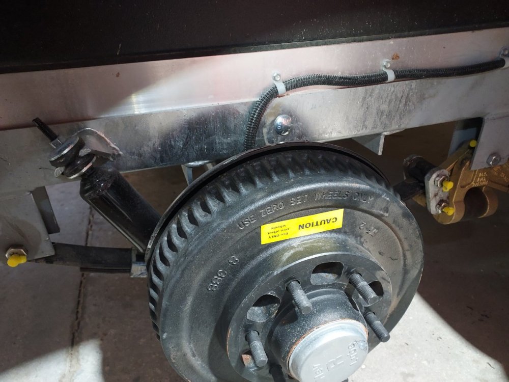

Definitely a simple worthwhile addition to keep the fittings clean to prevent dirt contamination.  I added the caps shortly after our Ollie purchase, and I also changed to angled Zerk fittings to make re-greasing easier.
I put mine on almost seven years ago.
I really didn't think that given the "cheapness" of the plastic they would last very long - so - I bought a full set of extras.
Fortunately, I've not had to use a single one of those extras - yet.
Like @Frank C we also changed our zerk fittings. Adding the zerk caps seems to make greasing a much easier task to .
Thanks @topgun2 for the suggestion at the time on the caps.
-Patriot 🇺🇸
You must have much better manual dexterity and body flexibility than I do!  I can't get a grease gun, even with a Lock N Lube fitting on the end of a flexible hose, on to the two zerks inside the central bracket that holds the EZ flex assembly, without removing my wheels.

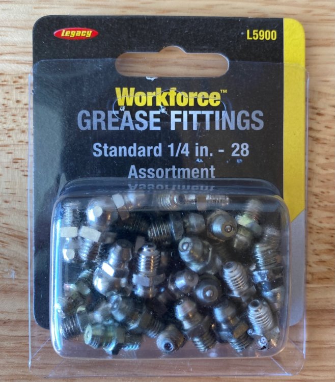

Seems like a worthwhile addition. What size angled Zerk fitting do I need and can the caps be purchased in smaller quantities?  Looks like Amazon has only a 50 count of the yellow ones.  I have the Elite I and as far as I can tell, I only need 6 caps.
Thanks
2021 Legacy Elite I , Hull #765
2021 Chevrolet Silverado 3.0 Diesel
Navarre, Fl
Our Oliver had 1/4-28 thread size Zerk grease fittings but this may not be the same for all Olivers.  I think some owners have found that their Dexter suspension assemblies have a 6mm-1 metric size Zerk.  Best to remove one of your existing Zerk fittings to confirm the thread size.

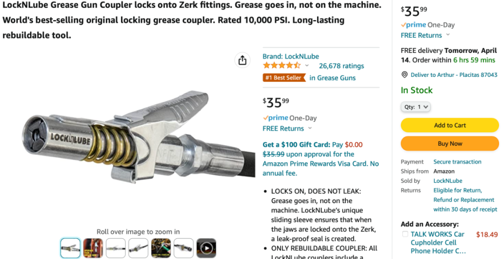

Anyone tried this grease gun?  Looks promising....
2141852382_Screenshot2023-04-13at06_16_37.thumb.png.903b8963e6ac75874a93c1d57daff037.png
Yep, it is worth twice that, you can buy the fitting direct too, ships free.
https://locknlube.com/products/locknlube-grease-coupler?variant=32586284204116
I have used one for years, I have been reluctant to recommend an attachment that costs more than most grease guns. But OTH I also use an expensive pneumatic gun. Just buy it and enjoy it.
Thanks for the vector, John.  Getting one today....
  • 2022 TUNDRA
We have one also. Works great! Definitely worth the money.
