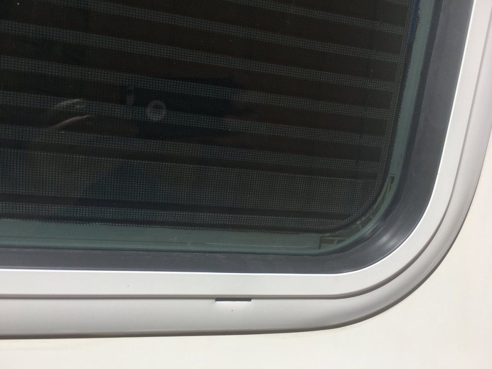

We received the replacement rubber from Pelland quickly and they sent an extra foot+ in length. Installed it last week, starting from the bottom, pushing hard to compress as much stock as possible. I used an automotive hose cutter tool. Cut it 1/4" longer at end and pushed in the extra length, so that when it shrinks, we should be good. The black does look so much better, as it is recessed, and the white frame is still prominent. Thanks all for your help! 🙂

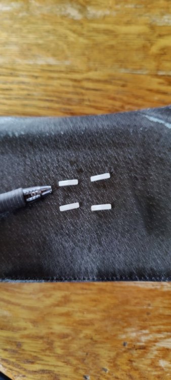

I'm missing two black weep hole plugs, but I had completely forgot about them as I blocked them with white Gorilla duct tape, strong stuff. They blend in too well to remind me.  I just now looked at them, after nearly 2.5 years outside, and they're still perfect. Maybe I should pull the other two plugs to match. I'm getting a bit of water inside with heavy rains. Or, like my walk-in door, maybe the frames are leaking. Since I pulled off the door fame off the hull and resealed, it's been perfect, no more leaks.  Super easy job. I have a post somewhere in the forums. No vid yet, not sure how to organize content.

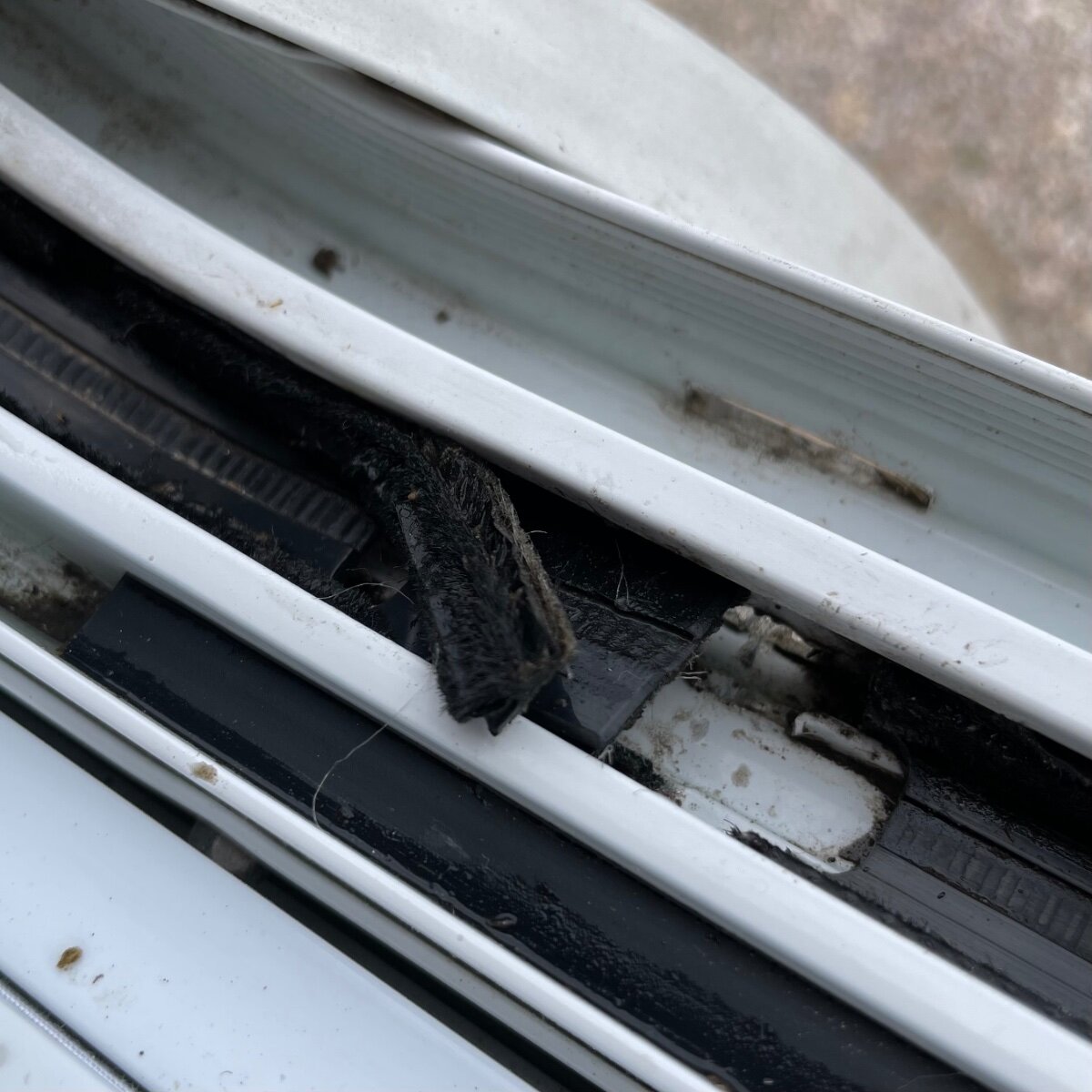

My rear window is as described by Chris and was pretty straight forward as he shows in the video.  My side windows are not.  The slotted rubber piece on each side have a felt rubbing strip on either side of the channel and prevent the rubber piece from being extracted, unless you use quite a bit of force.  The felt strips are an H shape and fit over the edge of the rubber strip.  I'm not sure if the pictures are of any help.  I quit as RoadKingsofGa did and am unable to fit the H shape of the felt strip back over it edges.  So I quit at that point and finished cleaning as best I could.  I don't think it matters much if I don't get the felt strip back perfectly as the window still slides smoothly and none of the weep holes are blocked.  I'll search out the window experts at the rally.
BTW, there are 2 of those felt strips, 1either side of the rubber strip.  I did not attempt removal of the outboard strip.
John
John, have you figured out how to remove/install the side window window black tracks with the felt rubbing strips? My windows are the same as yours, I cleaned the rear window but like you and @RoadKingsofGA I couldn't remove the side window black tracks with the felt strips!

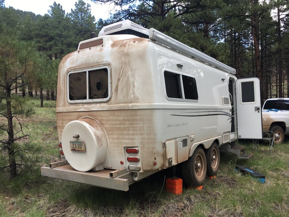

All I do is when we return from camping trips, I pressure wash all the dirt off our trailer (and there’s so much dirt out here)! I hit the windows straight on with 3000 PSI water pressure and you see the dirty water come out of the drain holes first, followed by clean water. If I do not see this out of EVERY drain hole I would address this afterwards. As I am blasting the windows, Chris is inside with a towel to collect any sprayed water to the interior and there is generally little to none.
And our Ollie can get very dirty!
I can just see those guys at CGI having their way with #113! 😇
John, now that's camping to the full! 😄
5 hours ago, topgun2 said:
I can just see those guys at CGI having their way with #113! 😇 Bill
Chris and I are OK with our "Dirty Ollie." After a wash it goes from dirty to pasty, but not paying the big bucks for a shine.
That picture is from our very first Oliver camping trip, July 2023 to Kendricks Peak AZ, after 26 miles of dirt road. Ever since that trip, I've brought our Dewalt leaf blower which gets a lot of it off if blown as soon as we get to our campsite.
Just got back from 12 days to NM and back. We hit snow then fog and rain and it's not quite as dirty this time but it is sure stuck on now. Bought gas for the pressure washer yesterday and today it's a beautiful sunny 72F day and I should be getting wet and dirty after lunch today~!
That just looks awesome and assaults my OCD at the same time.  Especially the finger swirls on the back windows.

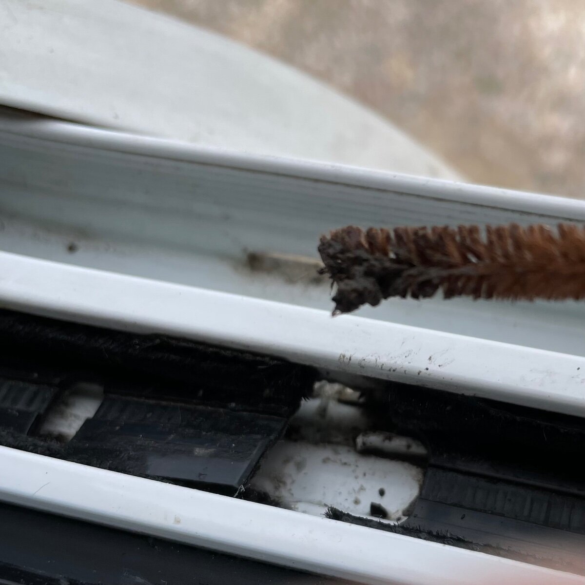

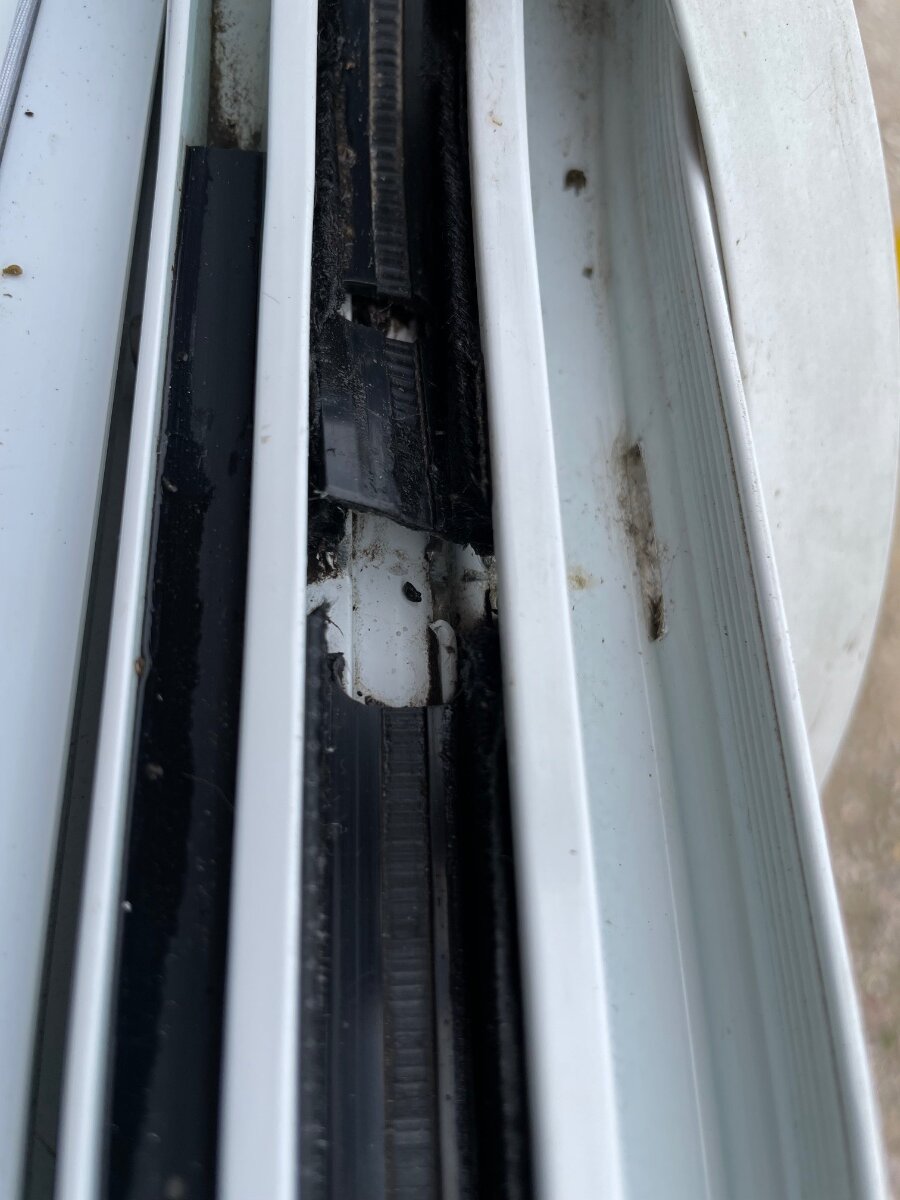

Here's an update on the LE2 sliding vent window tracks.
I believe the correct Hehr part numbers are H109-602 (for the curved sections) and H109-599 for the straight pieces.  These can be ordered from Pelland.
There is an update for these vent tracks.  The tracks having the wooly fuzz on each side vertical section were replaced by flexible track made of TPV.  I do not have part number or supplier information for that, at least not at this time.  The TPV track is flexible enough that a separate radius-ed part is not required.
The sliding portions of the 5600 / 7600 windows are not designed to be removed (the only Hehr window sold up to this point which is designed this way), so replacing the vent tracks can be tricky.
I understand the vent tracks were made by an (unidentified) outside supplier and not by Hehr.   I further understand that the window model number is 5600.  Hehr 7600 windows are identical to the 5600 with the exception of the outer trim, meaning 5600 and 7600 series parts should work on Ollies with 5600 series windows.   Neither the 5600 series nor the 7600 series are shown among Lippert's current product offerings.
The story is a lot longer than this, but the important information is above.
