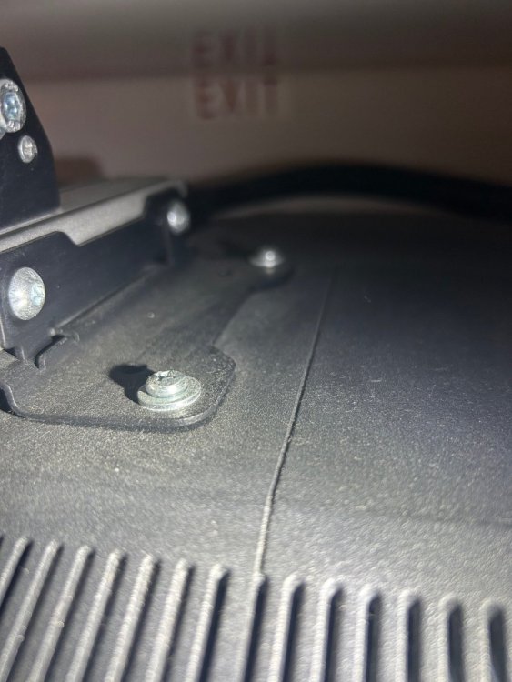

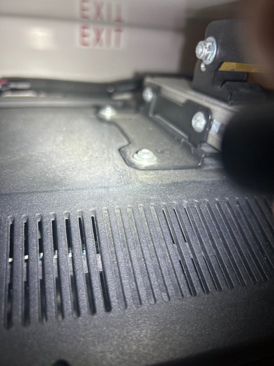

Failure cause found. I've installed a few TVs and the mounts often come with some spacers to go between the mounting plate and the TV - to account for obstructions, curvature, etc. Careful examination of our TV and mount reveals that the wings of the mounting plate itself are bent slightly upward. Look carefully at the TV back and the plate mounting screws in this picture and you can see it.
Tightening the screws at installation pulled the center of the TV against the center post, causing two of the mount points to pull out through the plastic TV back on the left of this photo.
Two possible solutions for the new TV: disassemble and try to flatten the mount plate, or install nylon washers or rubber spacers between the plate and the TV to stand it off away from that center post.

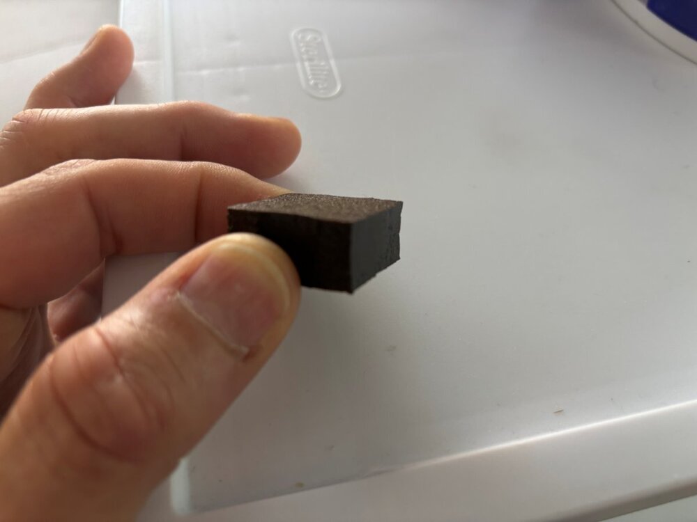

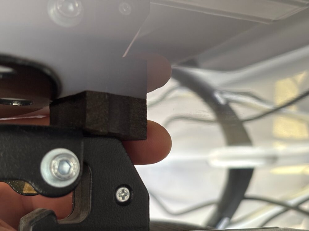

This is what I did, cut a 1"x1'x1/2" piece of rubber or dense foam and squeeze it in here, see pic.

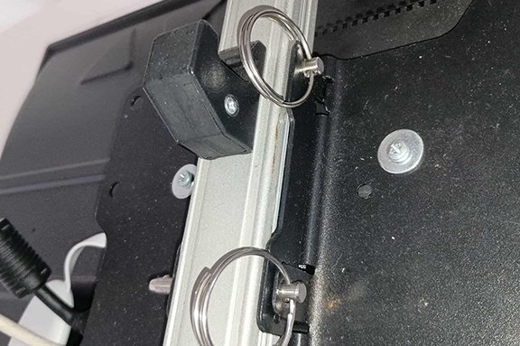

To prevent this from happening, I removed the bolts that hold the TV bracket to frame and drilled 1/4 holes to accept quick release pins. Takes seconds to remove the TV and cables and then I lay it flat on one of the beds before travelling. Also makes it easy to remove and bring indoors while we're not camping.

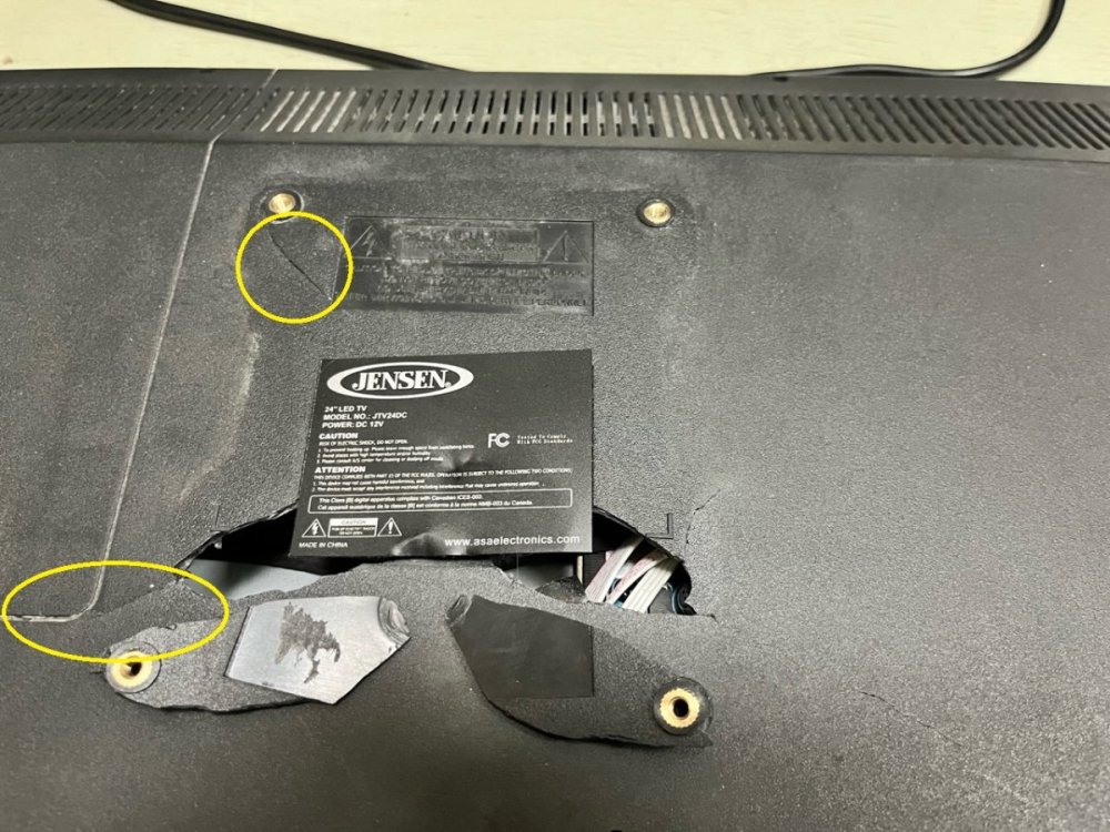

Our original 2019 Jensen tv cracked.  We reported it to Oliver with no feedback given other than to adjust tire pressure down (which is set at 50psi)
We then bought  replacement of same size/brand Jensen that also cracked (yet the tV works fine).
I McGivered together a solution on the road using a stiff thin cutting board and a bunch of JB Weld to beef up the back.  Its ugly but has held for two years.  I also use a chunk of foam between the arms when closed.
Once I get back to my shop in July I plan to take the back off the original TV and fabricate a sandwich of stiffener inside and outside the back paying attention around the mount points.
