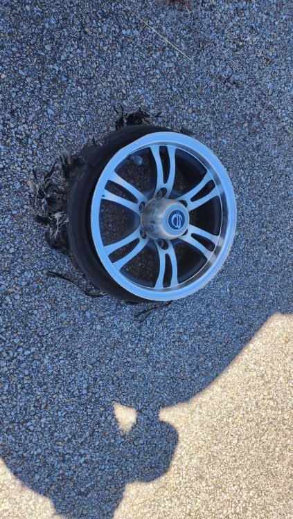

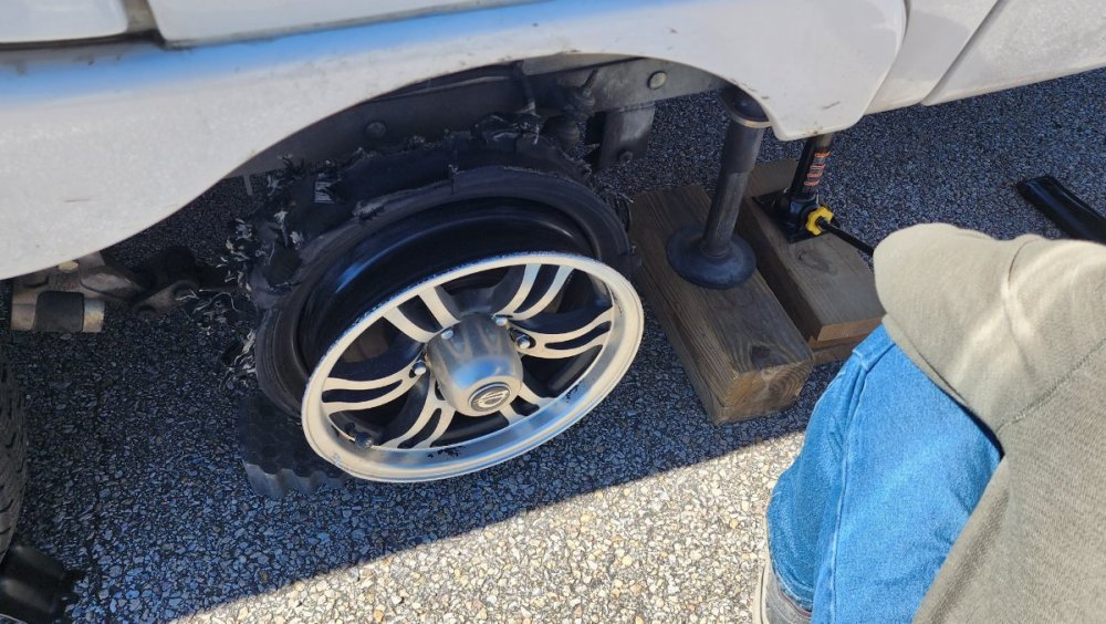

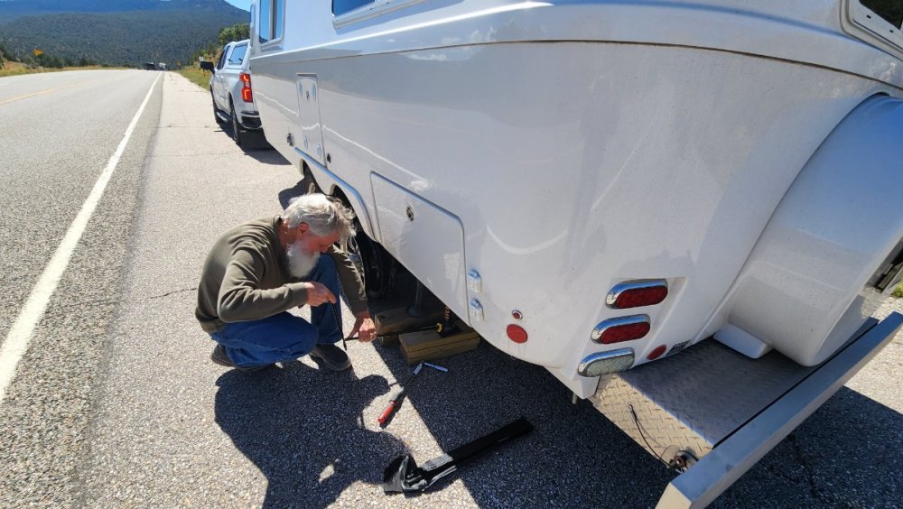

johnwen Posted September 18, 2023 Posted September 18, 2023 We've been at altitude with cool temperatures for the past 3 months between Montana and Colorado. 2022 Oliver with 27000 miles on it and the original tires. We had a blowout on the aft driver's side. I travel at 61 or 62 mph but have very seldom approached 70 mph when descending on the back side of a mountain. I'm only posting this because I did not realize we had a blowout until I heeded a following motorist's flashing headlights, signaling me to pull over. He probably followed me for 5 or so miles and I thought he just wanted to know more about the trailer. We inspected what we could view from the side view mirrors and could not see anything wrong or out of place. I could only see the front tire with my standard sized Silverado side view mirror. We finally pulled over when we came to a place where the road became wider. We did not notice any odd noises, vibrations, or any visual clues that anything was wrong. Our normal 60-62 psi was indicated that morning via our ProSmart, smart tire pressure sensors with our smart phone app. We have no way of checking pressure while we're driving as the bluetooth range is very limited. So, lesson for me.....I will install internal pressure/temp sensors that can be read through Chevrolet's "driver information center". Again, I had no idea anything was wrong until someone notified me to pull over. The aluminum wheel was also damaged beyond repair and while I found the correct sized tire, Discount Tire had to install it on, what appears to be, a trailer rim. 2 1 4 4 2022 Oliver II #996 "Bessie", 2019 Silverado LTZ 5.3, Veterans https://wenandjohnsadventure.com/
Moderators topgun2 Posted September 18, 2023 Moderators Posted September 18, 2023 I assume from your post that other than the wheel rim there was no damage to the Oliver - wheel well, tire fairing, brake lines, brake wires, etc.? If that be the case then consider yourself to be very fortunate. Certainly there is a margin of safety in having two axles versus only one. And, a big thanks to that driver who alerted you to the problem. When purchasing my 2023 F-150 I too considered getting Ford's trailer TPMS. But even though it would be nice not to have yet another of these screens in the cockpit of the truck, the price was much higher than simply getting a stand alone TPMS. Also, I've found that having the stand alone TPMS I tend to monitor it more often. There are numerous brands on the market that do a great job of monitoring both pressure and temperature for the trailer and the spare tires on the truck and Oliver. I simply went to YouTube and Amazon, looked at features, size, reviews and price to get the one I liked best. Glad that you are OK. Bill 1 5 2023 Ford F150 Lariat 3.5EB FX4 Max Towing, Max Payload, 2016 Oliver Elite II - Hull #117 "Twist" Near Asheville, NC

johnwen Posted September 18, 2023 Author Posted September 18, 2023 3 hours ago, topgun2 said: I assume from your post that other than the wheel rim there was no damage to the Oliver - wheel well, tire fairing, brake lines, brake wires, etc.? If that be the case then consider yourself to be very fortunate. Certainly there is a margin of safety in have two axles versus only one. And, a big thanks to that driver who alerted you to the problem. When purchasing my 2023 F-150 I too considered getting Ford's trailer TPMS. But even though it would be nice not to have yet of these screens in the cockpit of the truck, the price was much higher than simply getting a stand alone TPMS. Also, I've found that having the stand alone TPMS I tend to monitor it more often. There are numerous brands on the market that do a great job of monitoring both pressure and temperature for the trailer and the spare tires on the truck and Oliver. I simply went to YouTube and Amazon, looked at features, size, reviews and price to get the one I liked best. Glad that you are OK. Bill Just a few rubber marks on the outside of the fender, and yes to "very fortunate" :) 2 2022 Oliver II #996 "Bessie", 2019 Silverado LTZ 5.3, Veterans https://wenandjohnsadventure.com/

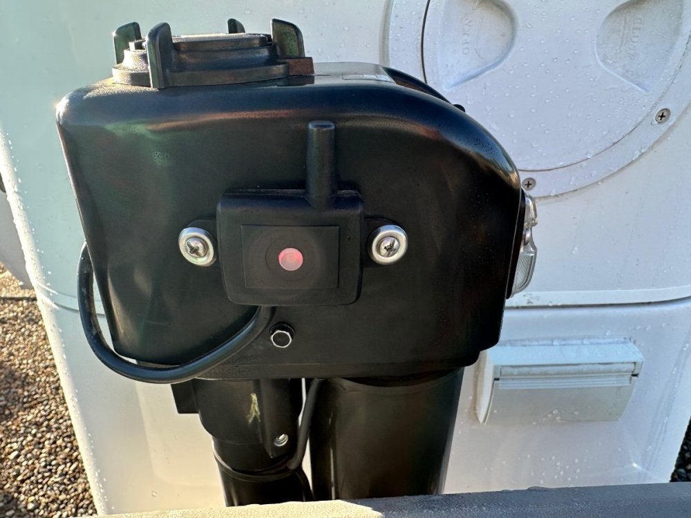

Galway Girl Posted September 19, 2023 Posted September 19, 2023 I mounted our TST transmitter on the side of the front jack case. Been working well for 4 years. 2 3 2019 Elite II (Hull 505 - Galway Girl - August 7, 2019 Delivery) Tow Vehicle: 2021 F350 King Ranch, FX4, MaxTow Package, 10 Speed, 3.55 Rear Axle Batteries Upgrade: Dual 315GTX Lithionics Lithiums - 630AH Total Inverter/Charger: Xantrex 2000Pro Travel BLOG: https://4-ever-hitched.com Lower 48 + Alaska Achieved in Maine in Aug 2024 on way to Nova Scotia.

BBL Posted September 23, 2023 Posted September 23, 2023 On 9/19/2023 at 9:01 AM, Galway Girl said: I mounted our TST transmitter on the side of the front jack case. Been working well for 4 years. Nice mount there, do you have pictures of how you wired that in? Would love to copy this one but didn't see a good route for the wires and want to learn from a good setup. Thanks! Brian 3

johnwen Posted September 23, 2023 Author Posted September 23, 2023 3 hours ago, Brian and Brandelyne said: John/Wendy - so happy to hear you are both ok brother! Seems like little damage as well. I see everyone is assisting with their TPMS solutions and I would like to share something a little different that we have used many times on the road to help others. Thankfully, we have not had to use it on our own trailer(s). Anderson levelers makes a "Rapid Jack" and you essentially just roll up on it with your good tire and change your bad tire. Saves all the blocks and jacks that most of us are familiar with. Thanks, Brian, I appreciate the well wishes :) John 1 2022 Oliver II #996 "Bessie", 2019 Silverado LTZ 5.3, Veterans https://wenandjohnsadventure.com/

MAX Burner Posted September 27, 2023 Posted September 27, 2023 On 9/23/2023 at 2:17 PM, Brian and Brandelyne said: Anderson levelers makes a "Rapid Jack" Been carrying a similar device as the Anderson Rapid Jack since we had a blow-out on our AS back in 2012. Its not light, but like @Brian and Brandylyne noted, it saves time and the rear jacks. Cheers, GO NAVY beat AF! 1 Art, Diane, Magnus & Oscar (double-Aaarrf!) (SOLD) 2022 TUNDRA (SOLD) 2017 LE II; Hull #226 "Casablanca" HAM call-sign: W0ABX
