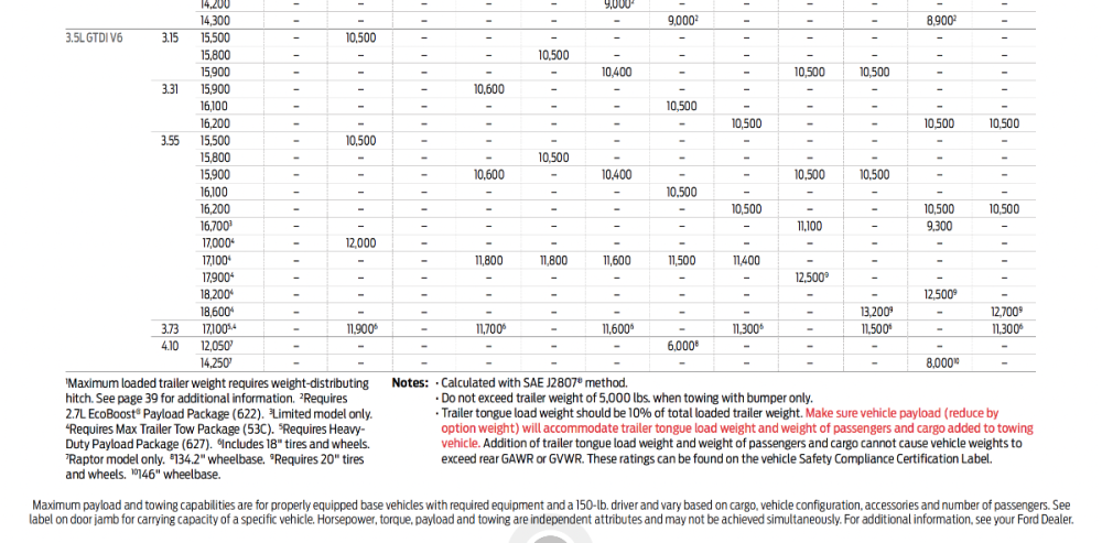

11 hours ago, Rivernerd said:
1/2 ton truck owners manuals do not address tongue weight, but trailer weight.
7 hours ago, ScubaRx said:
Pay attention here, light duty truck owners. This is absolutely true.
Not true - at least in regards to Ford.
Perhaps, technically, this statement IS true since I've not recently looked at my Ford Owner's manual.
But, there Is a Ford sticker on the hitch assembly that states that a weight distribution hitch IS REQUIRED if the hitch weight (tongue weight) is over 500 pounds.
I am quite interested to learn if your Ford owner's manual refers to tongue weight rather than trailer weight when addressing weight distribution hitches.  If it, in fact, refers to trailer weight, then in the event of an accident when towing your Oliver, your insurance company still has an opportunity to deny coverage based on failure to comply with the owners manual.
I also don't like the idea of shifting load to the rear to reduce tongue weight.  Trailers handle much better when loaded a bit tongue heavy (60% forward of the axles, 40% aft).  A "6000 lb. LEII"  should have tongue weight around 600 lbs. when properly loaded.  I am much more comfortable loading the trailer a bit tongue heavy, and using the Andersen WD hitch.
Finally, having now adjusted to the quirks of using the Andersen hitch after 1 year of ownership, I prefer the way our rig handles with it attached.  So, I don't mind the minimal extra time and effort required to hook and unhook it.  We "don't leave home without it."
Here's a clip from the 2020 Ford RV And Trailer Towing Guide regarding F-150:
