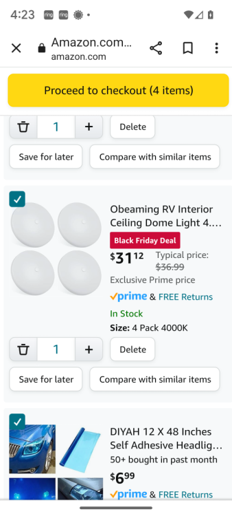

Dave and Kimberly Posted November 21, 2023 Posted November 21, 2023 Here is are some I'm considering for our replacement. I have had one of the touch lights go our almost every trip. (Ok...just three times) I've never really liked that the OEM touch lights seem a bit more yellow than the other Oliver lights. These are 4000K (instead of about 3200K) and think the mechanism might not be so inclined to fail as the tiny OEM spring-contacts. https://www.amazon.com/dp/B093G9KFFB/ref=sspa_dk_detail_0?pd_rd_i=B06ZZDM19W&pd_rd_w=2zJDd&content-id=amzn1.sym.0d1092dc-81bb-493f-8769-d5c802257e94&pf_rd_p=0d1092dc-81bb-493f-8769-d5c802257e94&pf_rd_r=AA9JC71TZA2WYECYSY4Y&pd_rd_wg=nbZUW&pd_rd_r=b8cd43aa-08e1-4b47-a826-58d019991397&s=automotive&sp_csd=d2lkZ2V0TmFtZT1zcF9kZXRhaWwy&th=1 1 2022 Elite II, Hull #1097 Elli Rose 🌹 and she has the solar panels with the 390Ah lithium batteries. Our tow vehicle is a 2019 Ford Lariat F-150 4wd, 3.5L Eco-boost, 3.55 rear end, with the Max tow package. Elli Rose also has the street side awning and several walnut and cherry mods on the inside.
Moderators SeaDawg Posted November 21, 2023 Moderators Posted November 21, 2023 That's a nice looking light, @Dave and Kimberly. After 15 years, I have one dead puck light (chrome) in the bath, and replacement is tough to find, and about $50. Maybe I could swap out the light over the stove, and in the closet and pantry, with these, and reuse my original switched fixtures. Hmmm. 1 2008 Ram 1500 4 × 4 2008 Oliver Elite, Hull #12 Florida and Western North Carolina, or wherever the truck goes.... 400 watts solar. DC compressor fridge. No inverter. 2 x 105 ah agm batteries . Life is good.
John Dorrer Posted November 21, 2023 Author Posted November 21, 2023 I have maintenance scheduled at the Mothership for late February There are a number of owners that have replaced their failed touch lights with something similar that also has a blue night light. I going to buy a 4-pack and have Oliver replace the 2 bad ones. No negative reports on these. By the way I asked about having the new lights (2024 Oliver's) with toggle switch installed, but the lights are larger, requiring moving them slightly and doing some fiberglass repairs. Bummer. John & Susan Dorrer, 2013 F250, 6.2 gasser, 4x4, 2022 Legacy Elite 2, twin beds, Hull #1045, Jolli Olli -
