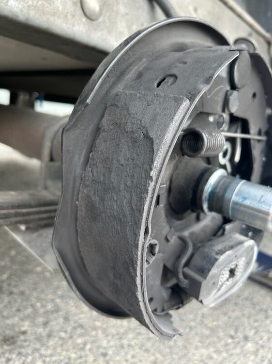

Galway Girl Posted May 11, 2025 Posted May 11, 2025 (edited) This spring I ordered new Dexter Nevr-Adjust brake assemblies and new pre loaded drums for a 60k mile tune up. Since the trailer was at a dealer for the truma recall had the dealer install them. We had some smoke early on during break in drive was expected, stopped checked temperature of hubs and all was ok. Set gain to 5 and drove on. After the break in period at about 300 mi we were feeling really strange tugging braking. Stopped at our daughter’s ranch, pulled the drivers side hubs and found the brake pads had just disintegrated. The service centers best guess is that the self adjusters over adjusted and caused brake lining failing or we unfortunately got a bad batch. Lucky we were near a local shop that got us in Saturday and replaced all 4 assemblies with regular assemblies (not never-adjust) . They also inspected, turned the drums, repacked bearings and installed new seals. We’re working with e-trailer to get a refund as the assemblies had a 5 year guarantee. Now I’ve added an item to our 3k inspection which includes lubing Zerks, and now adjusting brakes as needed. I’ve heard of, but never experienced, failed never adjust, but now I’m in the camp that they are not welcome on our trailer. First pix note the crumbling shoes curb rear. Second pix- shoe all gone to bear metal. Had to turn drums (which were brand new). Street rear. Safe travels. Craig Edited May 12, 2025 by Galway Girl added dexter to title for search purposes 10 1 2019 Elite II (Hull 505 - Galway Girl - August 7, 2019 Delivery) Tow Vehicle: 2021 F350 King Ranch, FX4, MaxTow Package, 10 Speed, 3.55 Rear Axle Batteries Upgrade: Dual 315GTX Lithionics Lithiums - 630AH Total Inverter/Charger: Xantrex 2000Pro Travel BLOG: https://4-ever-hitched.com Lower 48 + Alaska Achieved in Maine in Aug 2024 on way to Nova Scotia.

Steph and Dud B Posted May 11, 2025 Posted May 11, 2025 Lots of people, including us, have had issues with Dexter self-adjusting brakes. You were wise to return to standard manual-adjust assemblies. Stephanie and Dudley from CT. 2022 LE2, Hull #1150: Eggcelsior. Tow vehicle: 2016 GMC Sierra 6.0 gas dually 4x4. Our Oliver journey: Steph and Dud B's RV Screed Where we've been RVing since 1999:
CRM Posted May 11, 2025 Posted May 11, 2025 7 hours ago, Galway Girl said: This spring I ordered new Dexter Nevr-Adjust brake assemblies and new pre loaded drums for a 60k mile tune up. Since the trailer was at a dealer for the truma recall had the dealer install them. We had some smoke early on during break in drive was expected, stopped checked temperature of hubs and all was ok. Set gain to 5 and drove on. After the break in period at about 300 mi we were feeling really strange tugging braking. Stopped at our daughter’s ranch, pulled the drivers side hubs and found the brake pads had just disintegrated. The service centers best guess is that the self adjusters over adjusted and caused brake lining failing or we unfortunately got a bad batch. Lucky we were near a local shop that got us in Saturday and replaced all 4 assemblies with regular assemblies (not never-adjust) . They also inspected, turned the drums, repacked bearings and installed new seals. We’re working with e-trailer to get a refund as the assemblies had a 5 year guarantee. Now I’ve added an item to our 3k inspection which includes lubing Zerks, and now adjusting brakes as needed. I’ve heard of, but never experienced, failed never adjust, but now I’m in the camp that they are not welcome on our trailer. First pix note the crumbling shoes curb rear. Second pix- shoe all gone to bear metal. Had to turn drums (which were brand new). Street rear. Safe travels. Craig Ouch, I'm surprised the drums were salvageable. 1 2010 Elite II Hull #45, the first LE2 sold. 2020 Toyota Tundra TRD Off Road 4WD 5.7 with 38 gallon tank, 4.30 axle and tow package.
Galway Girl Posted May 12, 2025 Author Posted May 12, 2025 15 hours ago, CRM said: the drums were salvageable. They were new drums and only had minor scraping so turning them was a reasonable option. I’m mostly upset with myself for not just doing the work myself in the first place . Waiting to hear back from etrailer in a claim. 2 2019 Elite II (Hull 505 - Galway Girl - August 7, 2019 Delivery) Tow Vehicle: 2021 F350 King Ranch, FX4, MaxTow Package, 10 Speed, 3.55 Rear Axle Batteries Upgrade: Dual 315GTX Lithionics Lithiums - 630AH Total Inverter/Charger: Xantrex 2000Pro Travel BLOG: https://4-ever-hitched.com Lower 48 + Alaska Achieved in Maine in Aug 2024 on way to Nova Scotia.

Galway Girl Posted May 13, 2025 Author Posted May 13, 2025 Etrailer is saying I pay to ship bad parts back , they ship 4 new parts to me. I’m going to try and get them to be manual adjusting units so I’ll have spares. 2 2019 Elite II (Hull 505 - Galway Girl - August 7, 2019 Delivery) Tow Vehicle: 2021 F350 King Ranch, FX4, MaxTow Package, 10 Speed, 3.55 Rear Axle Batteries Upgrade: Dual 315GTX Lithionics Lithiums - 630AH Total Inverter/Charger: Xantrex 2000Pro Travel BLOG: https://4-ever-hitched.com Lower 48 + Alaska Achieved in Maine in Aug 2024 on way to Nova Scotia.

Galway Girl Posted May 14, 2025 Author Posted May 14, 2025 2 hours ago, jd1923 said: Maybe they didn't get the top of the shoe on the post correctly. These were complete dexter assemblies, so the RV Service Bay only had to bolt on the assembly, re-attach wires, and set initial adjustment. Maybe something wasn't right. In any case, I'll get a return address this week from E-Trailer and ship the mess back for replacment. CS 2 2019 Elite II (Hull 505 - Galway Girl - August 7, 2019 Delivery) Tow Vehicle: 2021 F350 King Ranch, FX4, MaxTow Package, 10 Speed, 3.55 Rear Axle Batteries Upgrade: Dual 315GTX Lithionics Lithiums - 630AH Total Inverter/Charger: Xantrex 2000Pro Travel BLOG: https://4-ever-hitched.com Lower 48 + Alaska Achieved in Maine in Aug 2024 on way to Nova Scotia.
