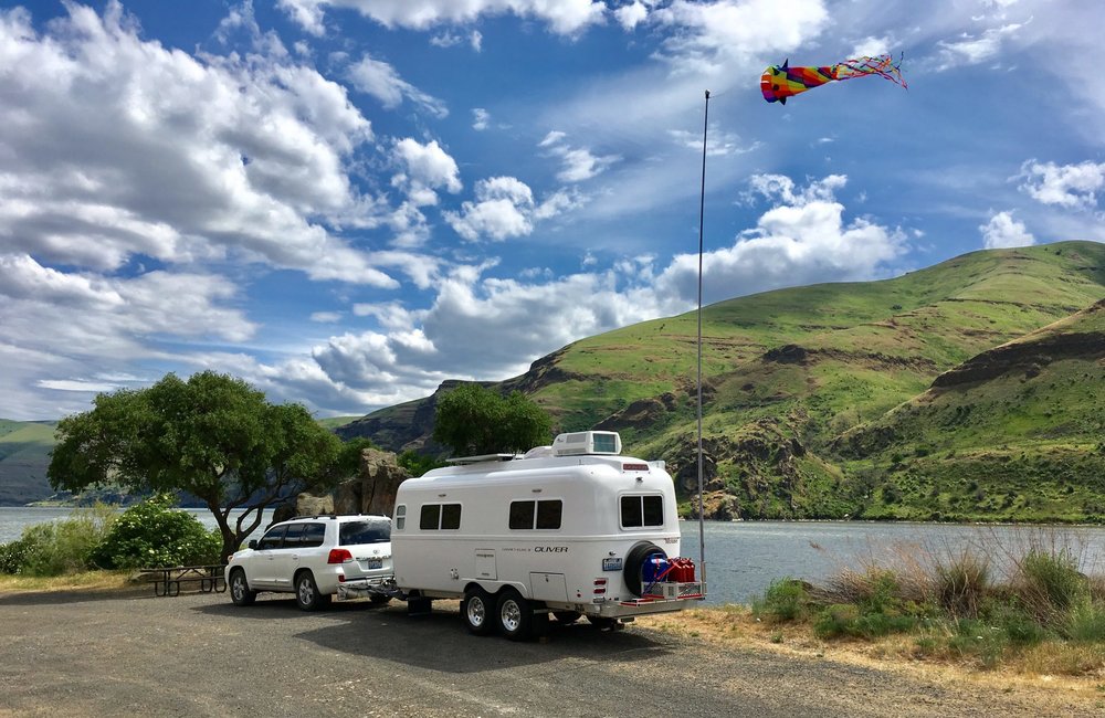

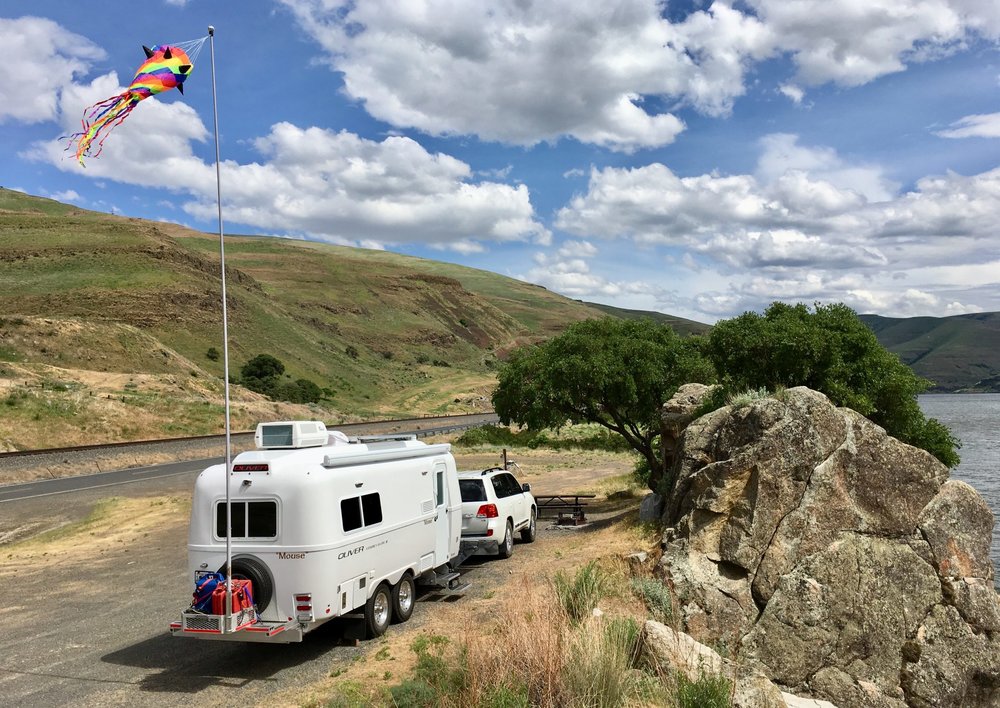

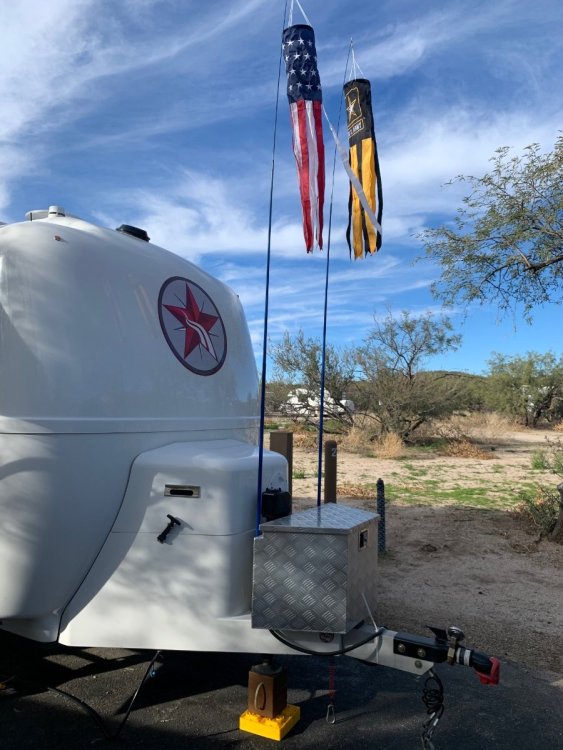

Bought this HD telescoping adjustable 22 ft flagpole, which comes with a 3x5 US flag: ... https://polesandholders.com/PNH-22-Deluxe-**NEW**-and-MOST-Popular-Flag-Pole-p206298627

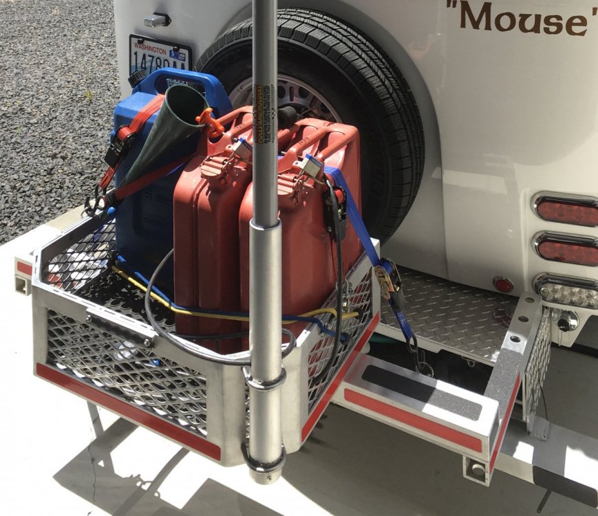

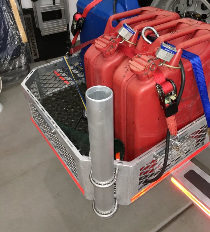

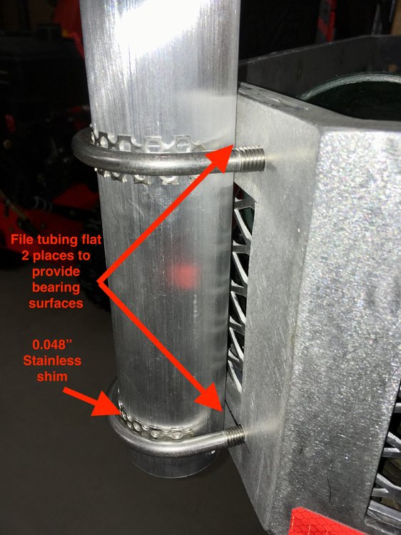

And built a holder for my cargo tray, which is now mounted in back.
The ID of the tube is larger than the pole OD, so I wrapped the pole in vinyl tape (0.015" thick) The pole can be lowered to around rooftop height if you don't want the flag or art to be in the upper atmosphere. Stored in its carry bag the package is around 4 ft long and fits in the closet.
EDIT 12/19/19:
Tube ID: 2.065”
Pole OD: 1.855”
Clearance 0.210”
The spinner shown is 6 ft long with a 3 ft harness, from here:  https://www.gkites.com/store/
I haven't actually flown the flag yet, but I can attach it at the top and hang wind art below it.

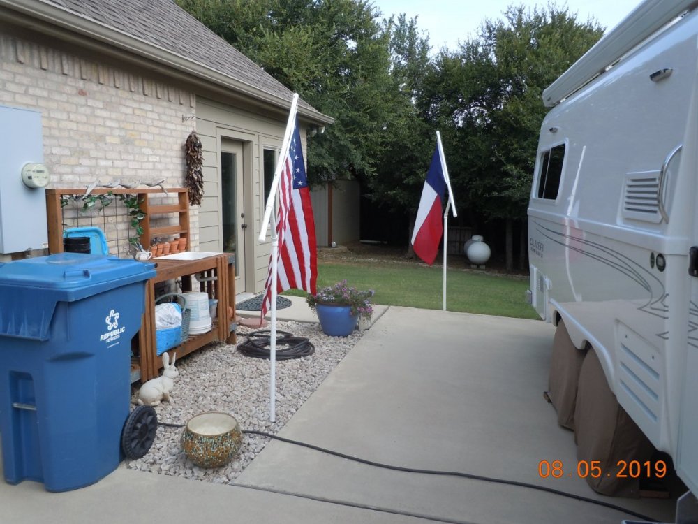

I plan to put a socket in the ground in my front yard, so I can fly stuff from this pole and not have a permanent installation, which my HOA does not like, for some reason...

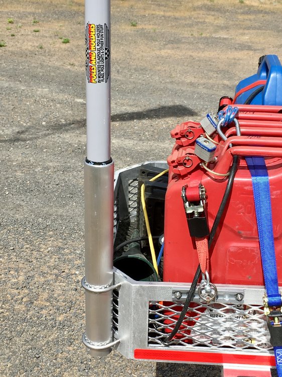

I was pretty worried about leaving the pole set up while unattended. It would be a matter of a few seconds for a nasty person to lift it up and carry it away. I normally keep my jerry cans secured with a Master Python cable lock, so I just drilled a pair of 1/2” holes through the tube and the lowest section of pole. Now the pole can be left in place for longer periods of time, either fully extended, part-way extended or retracted, as in the second picture.

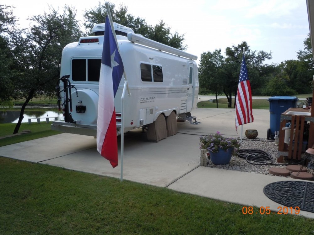

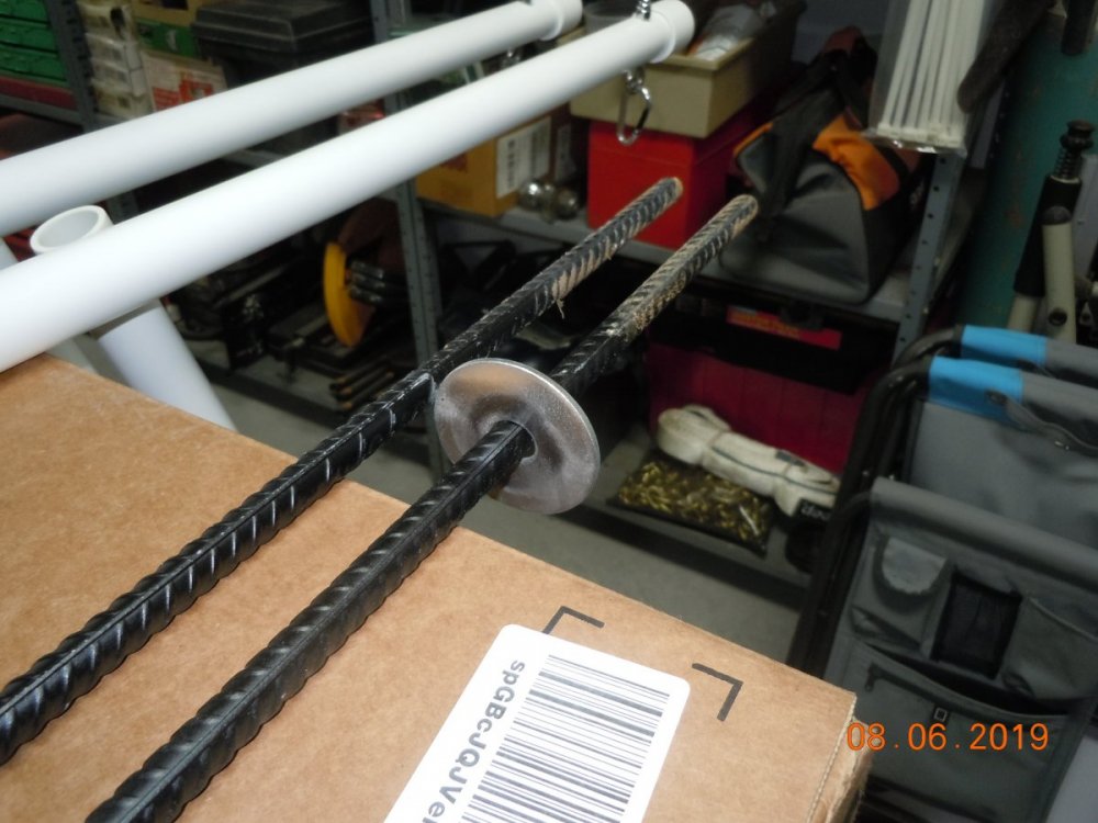

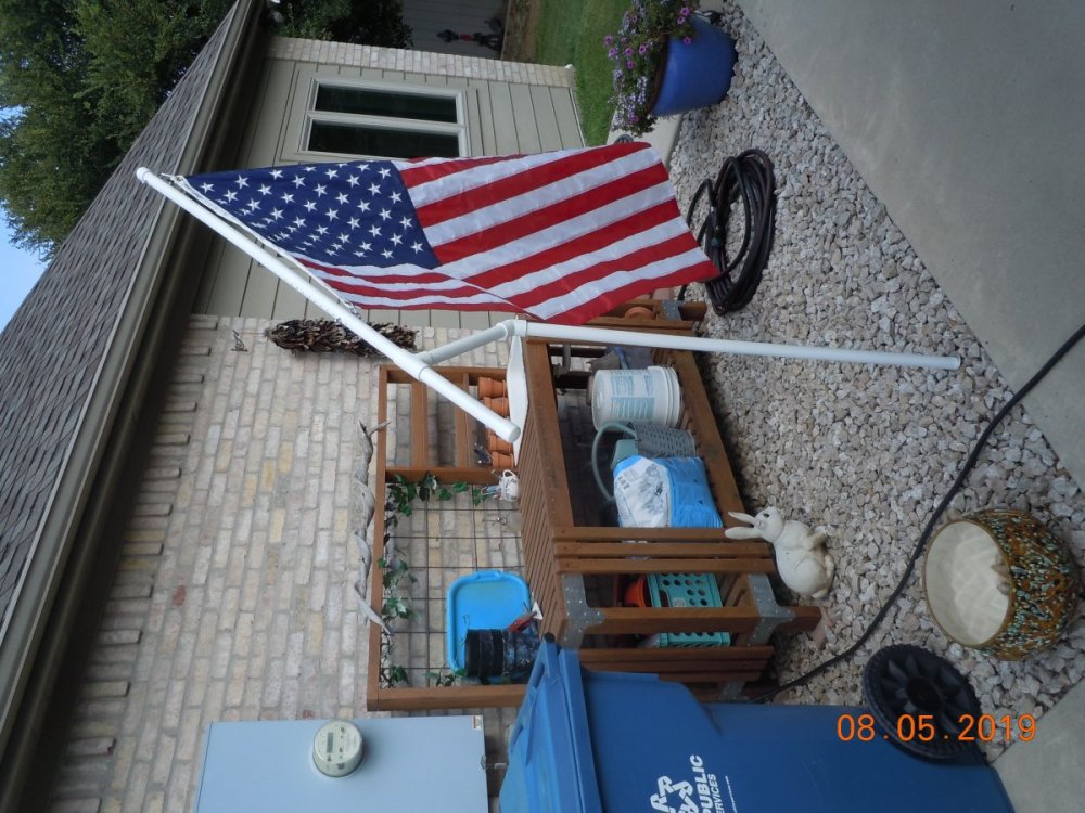

I opted for this style, PVC that comes apart and probably less expensive which we know it's not the price as much as getting what we want. I made two from 1" schedule 40 PVC, stainless hardware, and at a cost of around $30.00 for two, this does not include the price of the flags. I did purchase a flag light from Home Depot that mounts on the PVC flag pole, it it solar powers to recharge the battery, and goes on and off with the daylight, $22.00. This poles is mounted in the ground by a 3' x 1/2" rebar and it swivels in the wind to keep the flag from twisting up on the pole. One 10' PVC makes one pole, plus the other items needed. This pic was taken at home just after I finished the flag pole setup.
trainman
Trainman, those are petty nifty. What do you do when they are stored inside? Do you have a cover for the rebar? I would worry about tripping and getting impaled..... Do they rattle in wind gusts?
My wife would kill for that potting bench, can you PM me some pictures?

To answer some of the questions that John asked, I do carry the re-bar in the bed of my pickup (4' lengths) and the potting bench was a free lance design, made from old cedar 2x4"s and ran through the table saw to remove the outside paint that was on them (approxmently 1/16" to make them look new. I also installed an old porcelain sink for potting, my wife really enjoys it. Sorry for not answering, I just over looked this post.

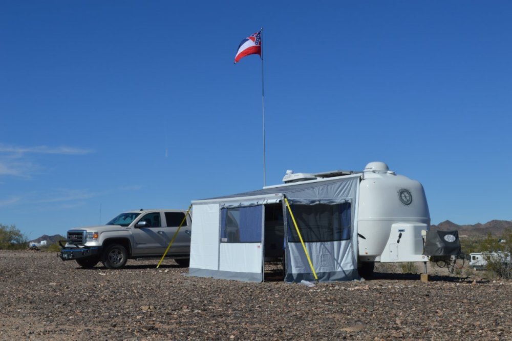

This our flag pole setup.
Upper Bracket
Lower Bracket

@ScubaRx, do you "just" thread the pole up, and then attach to the lower mount? Do you have to break out the ladder? Telescoping pole?

All you do (after extending the pole and attaching the flag) is lean the pole to the left and place between the two "hooks" in the upper bracket, straighten the pole and drop into the bottom bracket. Quick and easy.
We have two different poles, both are extendable. The big one is used to fly a flag (or two) and is 23 feet tall. The smaller one is used for spinners or such and is 18 feet. We store them inside the trailer one under each of our bed risers.
@ScubaRx,  did you fabricate the mounts yourself? Or, could you tell us where you found them?
That is one solid pole mount!
