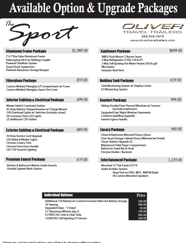

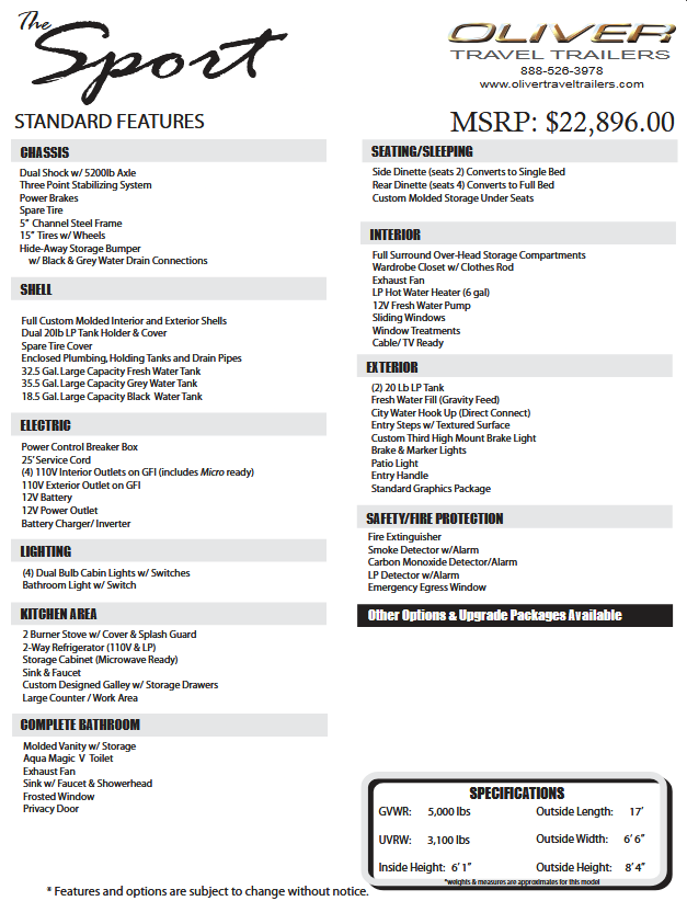

  • 2 years later...
On 12/15/2019 at 10:57 AM, SeaDawg said:
Sport model was only made for a very short time, probably less than a year. A version of original legacy to reduce the starting price, with a steel frame and fewer features included in the base model.  Same great hull. Only a very few built, maybe not even a half dozen. Oliver went into production hiatus not long after introduction of the sport.
The concept was not revived when Oliver went back into production with the Elite II.
Actually, there was only one made.
Here are the brochure spec sheets for them.
