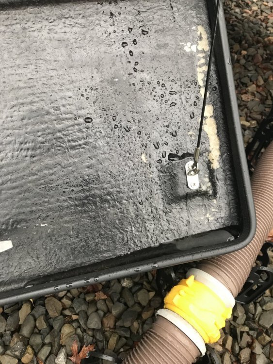

Townesw Posted June 20, 2020 Share Posted June 20, 2020 (edited) I’ve said this before and I’ll say it again: it’s absolutely asinine that, as manufactured, you have to open the basement door to pull the dump valves and if it’s raining water runs off the roof onto the open basement door. I know you can add auto drain valves and do other mods to get around this but this design should never have made it into production. And yes, it’s raining right now and I’m having to dump my tanks. Edited to add: Even though this is bothersome, I still wouldn’t trade my Oliver for another RV 🙂 Edited June 27, 2020 by Townesw 1 1 Bill and Martha 2018 LEII Hull 313 Original owners 3/14/2018 2019 Chevrolet 2500HD Duramax Link to comment Share on other sites More sharing options...
Landrover Posted June 20, 2020 Share Posted June 20, 2020 I did this simple mod Access port only for the grey valve to keep open while parked instead of having the entire basement door open. I thought of a small access door for both valves. So far this set up is working great. Sorry i deleted the photos from my phone. I believe they are still posted under mods. Somewhere? Grant 2022 GMC Denali 2500 HD 2019 Elite 11😎 Link to comment Share on other sites More sharing options...

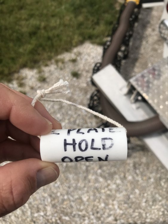

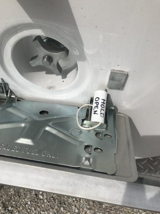

Overland Posted June 21, 2020 Share Posted June 21, 2020 (edited) I think this is the thread you’re talking about - An additional trick that I thought of before doing mine - if you tape a thumb tack to the center of the handle and pull the handle out just enough, then you can close the hatch and the tack will mark the center of the handle in the insulation on the back of the door. Then you can drill a small pilot hole from the back and your hole will be perfectly centered on the handle. Edited June 21, 2020 by Overland 2 1 Link to comment Share on other sites More sharing options...

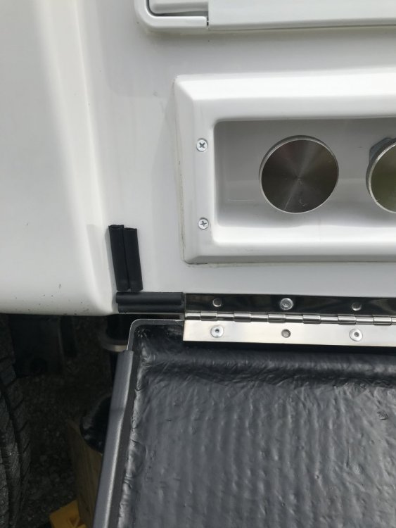

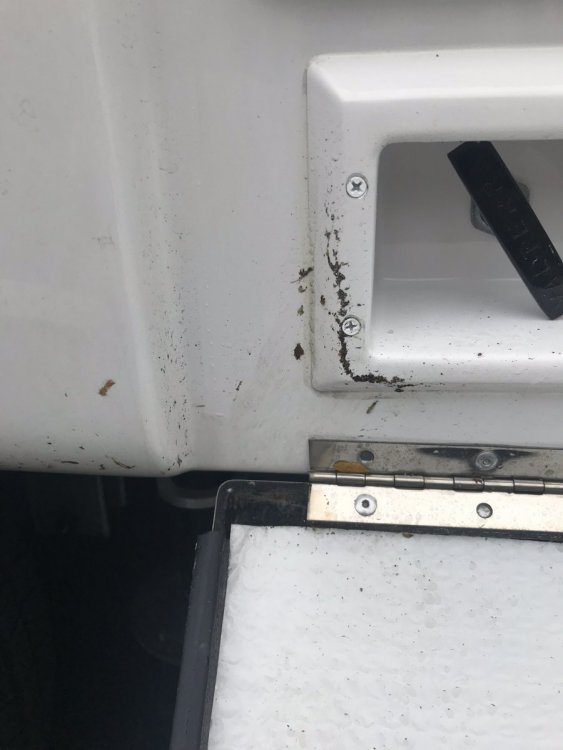

Townesw Posted June 26, 2020 Share Posted June 26, 2020 (edited) The whole basement area could stand some additional development, from the door to the placement of the valve knobs to the way it’s finished out. You’ll need to get some EPDM foam and seal the front lower corner to prevent road spray from entering. This won’t keep all of the spray out, or keep road grit out of the door hinge, but it will help. Before After Go ahead and remove the insulation and repaint the inside of the door. The insulation keeps the water that gets behind it from drying quickly. The Valterra handles were rubbing the bottom of the recessed handle box and I had read where a couple of people had broken the original handles so I went ahead and replaced mine with stainless steel knobs. Also cut a piece of something like this, I used a piece of PEX tubing And keep it handy to use to hold the license plate door open when you need to remove the spare tire cover or wash behind the license plate. I keep mine just inside the basement door. Back when the gas cap on cars was located under the license plate you would put the gas cap here to hold the plate open while you filled the gas tank. I hope these tips are useful. Bill Edited June 27, 2020 by Townesw 2 Bill and Martha 2018 LEII Hull 313 Original owners 3/14/2018 2019 Chevrolet 2500HD Duramax Link to comment Share on other sites More sharing options...
