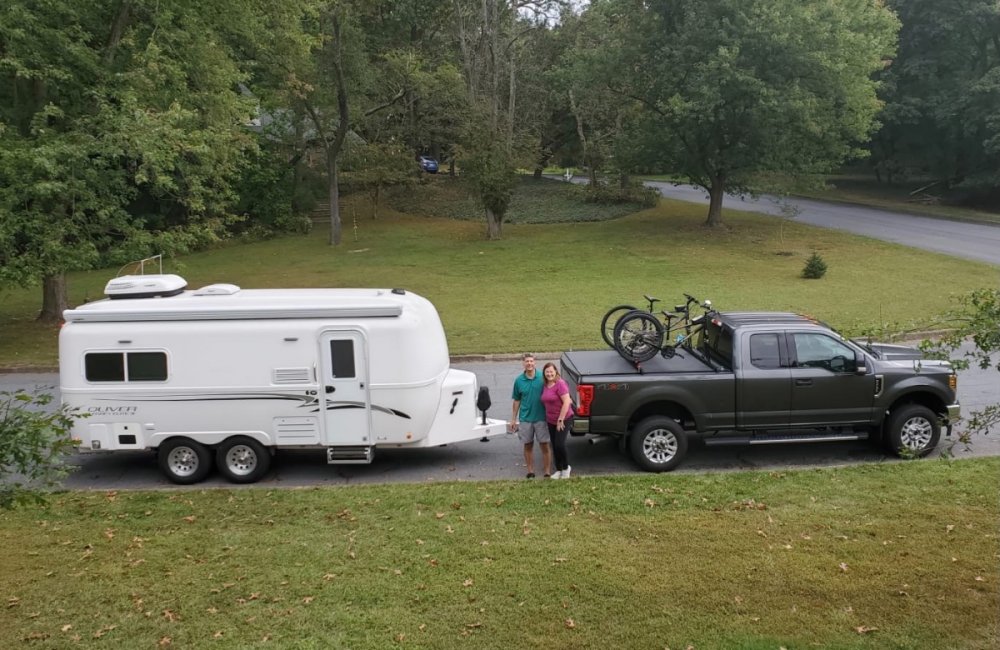

We tow our Elite II with a 2019 F-250 with the factory upgraded tow package, 6.2 gas engine.  12,500 lbs. towing capacity, 1,200 lbs. tongue weight capacity, 3,334 lbs. payload.   We haul a lot of stuff when camping.  The bed of the truck is full of stuff like camp chairs, Andersen jack buckets, portable solar panel setup, portable 3 stage water filtration system, toolboxes, 9’ x 12’ outdoor rug, folding tables, plus the weight of the Rock Tamer mudflap system, a rigid bed cover, over the bed cover bike rack, bikes, etc. so having the high payload capacity is a must for us.  The ride is pretty stiff when unloaded/not towing.  But I’m used to it now.  I do use the truck as my daily driver.

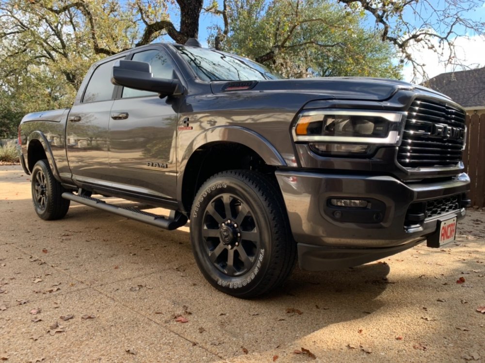

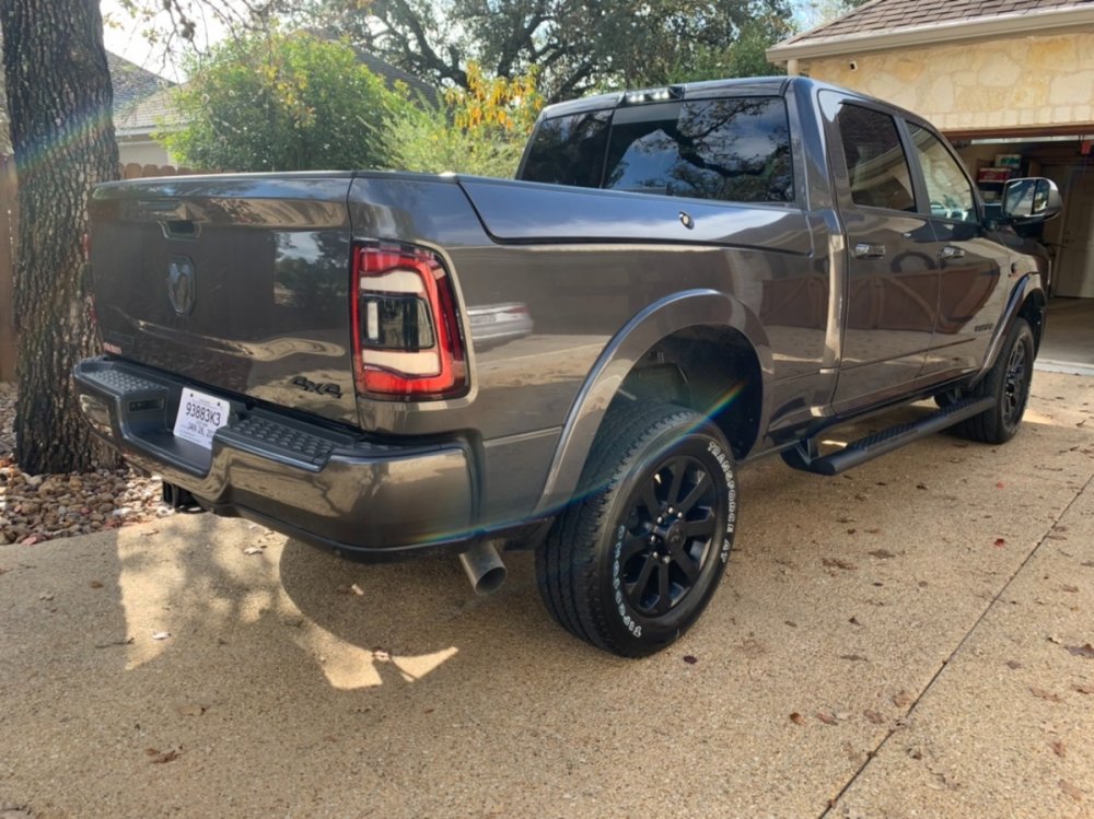

We traded our 1500 Rebel last month for a 2500 diesel.  I was tired of always being at or above payload capacity and wanted a more relaxed towing experience in the mountains.  A gas V8 at 5,000 RPM in the Colorado mountains isn’t fun.  Mike

+1 on the F250 with 6.2 gas motor. We “test drove” an EII with an F150.  For that setup, I was going to need an Andersen hitch to level.  Personal circumstances changed and we bought the current F250.
The Oliver will pull great behind either truck but, the F250 allows for more junk for the adventure.  With a Decked Drawer system and a bed rack, we can carry tools, kayaks and bikes on the truck.

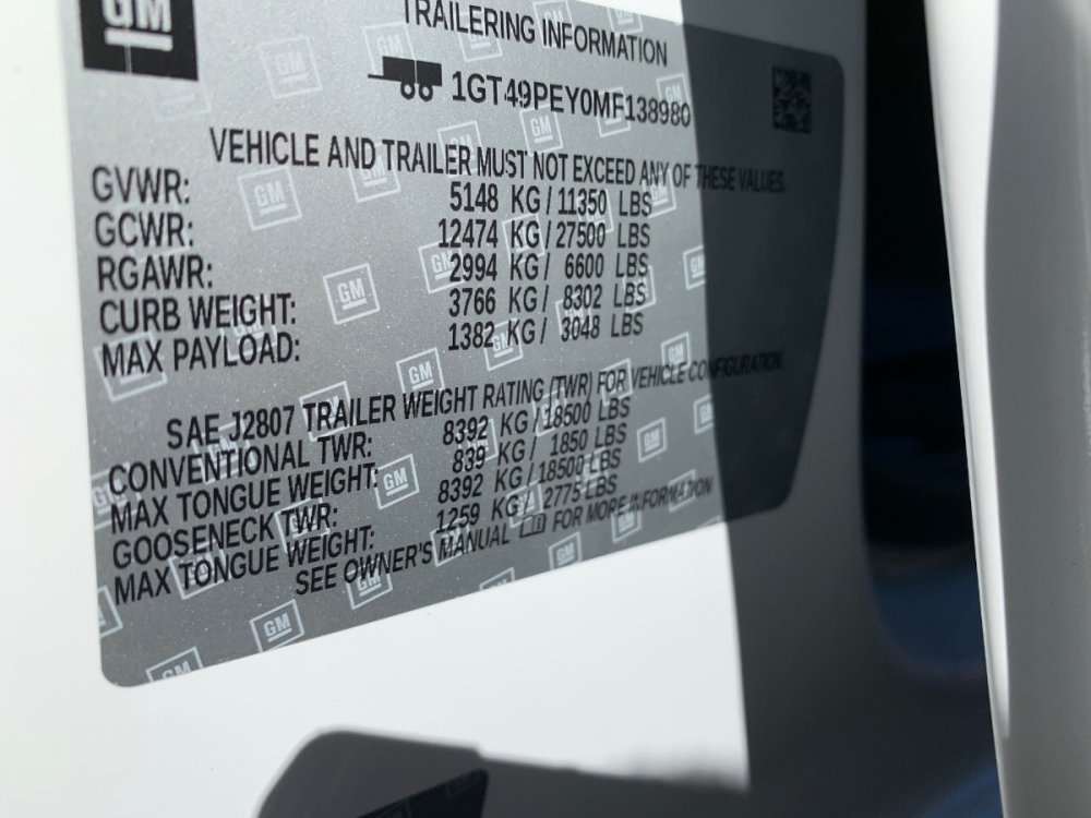

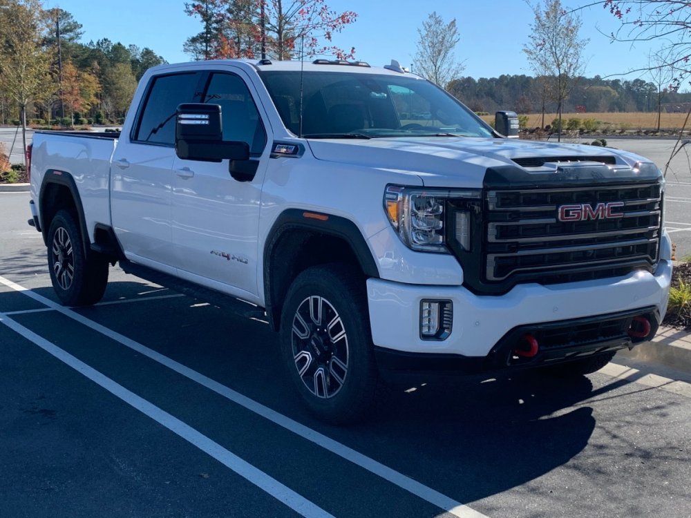

Just picked this up yesterday for a soon to be ordered Oliver EII.  Great deals on GMC and Chevy right now with the employee discount (and more if you know how to negotiate).  As everyone has said, the key to the HD trucks is the payload.
Edited by Jps190
John and Kim
Great looking truck!

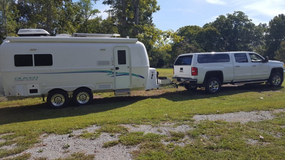

Well we all have opinions. I towed with a 1/2 ton, and now with my 2500 (19,000 miles towing, 43K overall), overkill is not what I'd call it,  more appropriate - it performs better in every situation except tight parking lots. As has been mentioned - the most capable statistic of the larger TV is payload. I also believe the added power of the diesel is well worth the upgrade. As they say, I've been with and with out - I'll take with every time.
I drove all the competition in 2018 - the Ford was much rougher ride unloaded. The GMC has decent manners unloaded and is really good loaded. I once had  a 2007 HD GMC - now that was a stiff suspension!! Worlds apart from the trucks of today.
If I were in the market today - I would seriously look at the Ram and the GMC - I'd want to drive the gas versions of each of the HD's - even try to talk them into letting me haul the Ollie around a bit. I'd even try the 1/2 ton ones if the payload was appropriate - I believe I saw one in the 23oo lbs. area,  Not sure however.  But now that I have the requisite chips, scrapes, and depreciation on the current one - I'll probably just drive it for a good while -.like forever 😉

BoB, from your picture above it looks like you're using the Anderson WDH with your GMC 2500... am I seeing this correctly?  If so, do you do this for the weight distribution, or ride quality, or...?

Ram 2500 diesel

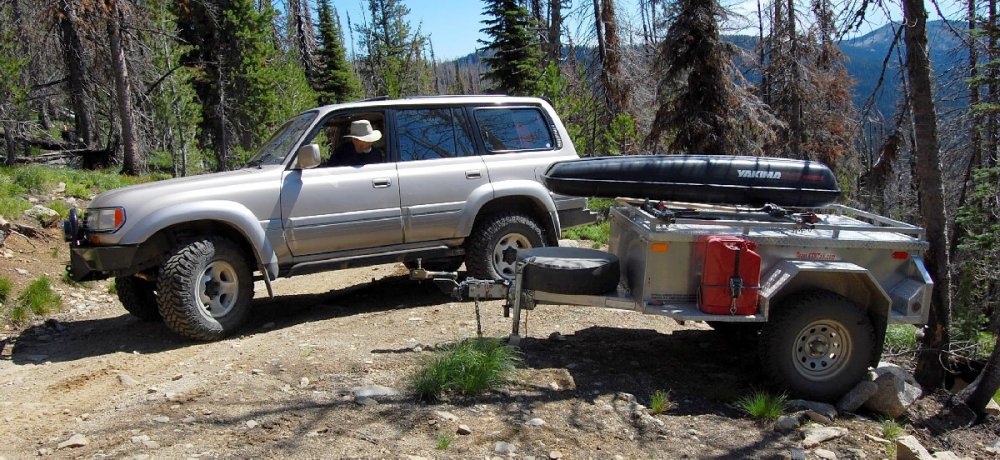

MontanaOliver, I drive the same rough, narrow high altitude forest roads as you do, and those endless washboarded ranch roads, but I cannot imagine doing so in a massive dually with that long wheelbase....  You must be a whole lot tougher than me. The reason I tow with a Land Cruiser is so I can park the Ollie and I can drive those roads without getting physically beat up, or high sided, or broken down, or forced to back several miles down a dead-end road.
Love the Magruder Road scenery! I drove about a mile up that exact rough side road in your second pic, with my old LX450 and a 10 ft trailer, and turned around after a mile. It got too ledgy. I had to unhitch it and back and fill, and dodge a long stream of upset ATVers coming down from Burnt Knob lookout. Great memories of a once in a lifetime route.

Agreed, a Magruder road trip is not for the inexperienced, faint of heart or those afraid of dirt/dust and scratches/dings to the body work. I've travel this route (it is my backyard area sort of) so many times I can't keep track. Started back in the 60's with Grandpa/Grandma dragging us brats along to pick huckleberries or hunt bear...hated some of those forced outings. Of course, now days, I'm guilty of the same punishment on the youngsters. I've hauled horses in stock trucks and trailers over the Magruder for years. It's just a matter of what you know and are used to, I guess. These type of roads are not a big deal to me, but yes you had better know how to use your mirrors and be very comfortable backing up your rig, to include around switchbacks. Big cities and traffic...that's my Rubicon. Every time I hit Denver traffic headed south on I-25, I wonder why I'm here and if I'll make it across the US interstate parking lot mess to visit the kids.
The posted photos are from this last summer. A buddy had never been across Magruder and wanted a guide. So off we go...spent two nights at the top of the world and as I'm totally done with the tent camping, the truck camper was my rig of choice: from the USFS brochure...#10 - Observation Point Observation Point Campground has nice camping spots and toilets. The elevation is 7620 feet and visitors can view the southern portion of the Bitterroot Mountain Range, especially El Capitan. The point also offers breathtaking vistas of subalpine/ alpine wilderness.
As to long wheel bases and bigger sized TVs. It's all relative I guess. Your four door Yota would be considered big and cumbersome on many roads, but it appears you at least know how to get yourself out of a mess. Our two door Jeep (and really, do Jeeps need four doors...errr) is the right sized 4x4 for our needs. But compared to a Suzuki Samurai we are huge.
Sorry for the slight thread hijack...back to tow vehicles and the endless discussion of what is the best rig. In my experience, you either use what you already own or can afford or move on to obtaining the correct vehicle matched to the task at hand. Me, I use what I already own which was purchased to tackle my taskings. Would I haul Ollie over the above discussed roads...yup, if it was all I owned. Spent, folded and/or mutilated be damned. Mark
