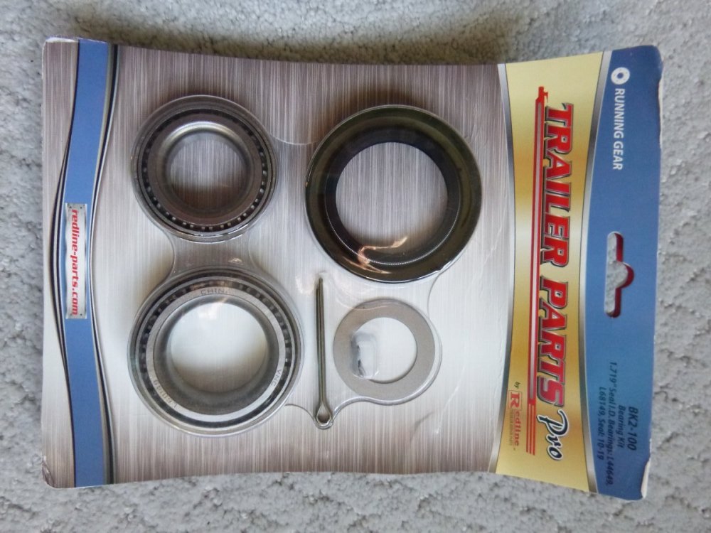

Moderators topgun2 Posted April 28, 2022 Moderators Posted April 28, 2022 Flat tire - I carry a "plug" kit that I can get in WalMart. I've always carried one of these kits - with or without the Ollie in tow. Wheel bearing issue - I carry a set of bearings like this: While I could change out the bearings with this set, that is NOT my intent. It is fairly easy to get the drum off the axle and carry that to virtually any gas station or tire shop that has a mechanic. The issue is not doing the job on the side of the road where it could be fairly dangerous, but, getting to a safe place and NOT having to wait for them to order the bearings. Yes, these bearings are fairly standard, but, I don't want to hear, "I'm sorry, we just sold our last set this morning". I've been carrying two of these sets around for the past seven years - just in case. And, before you ask - yes, they are made in China. However, I figure that they will last long enough to get me home where I can do a proper job with good bearings and good grease. Bill 4 2023 Ford F150 Lariat 3.5EB FX4 Max Towing, Max Payload, 2016 Oliver Elite II - Hull #117 "Twist" Near Asheville, NC
John and Debbie Posted April 28, 2022 Posted April 28, 2022 23 minutes ago, topgun2 said: Flat tire - I carry a "plug" kit that I can get in WalMart. I've always carried one of these kits - with or without the Ollie in tow. Wheel bearing issue - I carry a set of bearings like this: While I could change out the bearings with this set, that is NOT my intent. It is fairly easy to get the drum off the axle and carry that to virtually any gas station or tire shop that has a mechanic. The issue is not doing the job on the side of the road where it could be fairly dangerous, but, getting to a safe place and NOT having to wait for them to order the bearings. Yes, these bearings are fairly standard, but, I don't want to hear, "I'm sorry, we just sold our last set this morning". I've been carrying two of these sets around for the past seven years - just in case. And, before you ask - yes, they are made in China. However, I figure that they will last long enough to get me home where I can do a proper job with good bearings and good grease. Bill "Flat tire - I carry a "plug" kit that I can get in WalMart. I've always carried one of these kits - with or without the Ollie in tow." Bill what's this item? Any pictures of it? John John and Debbie, Beaverton, Oregon, 2017 Ford Expedition EL 4x4 3.5 liter Ecoboost, with heavy duty tow package. Hull #1290, twin bed with Truma package (a/c, furnace, hot water heater with electric antifreeze option), lithium pro package, picked up November 7, 2022 Alcan 5 leaf springs and Bulldog shocks done May 20, 2025 in Grand Junction, Colorado

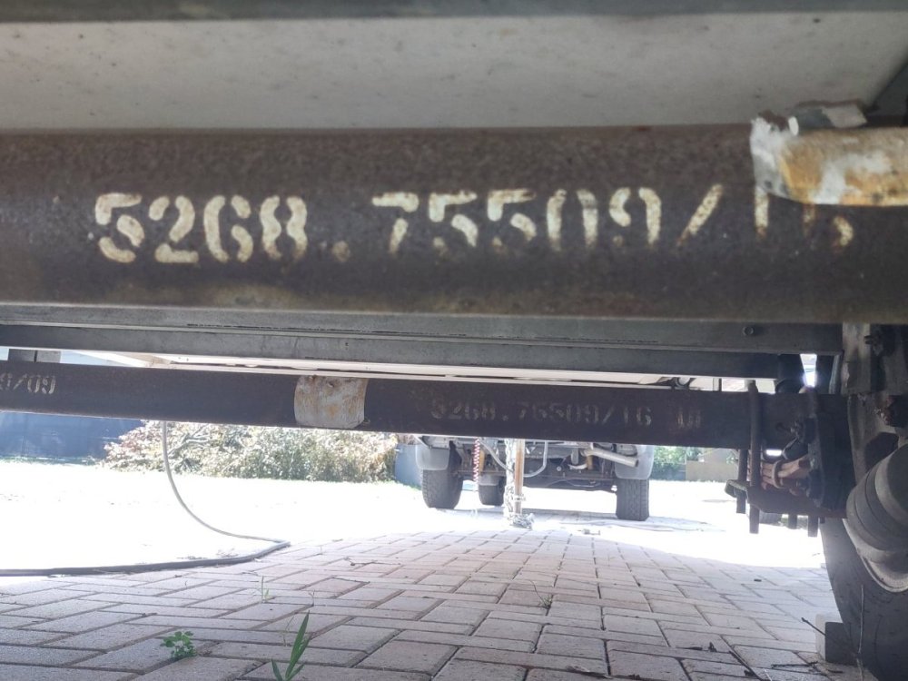

CRM Posted October 9, 2022 Posted October 9, 2022 Looking to buy bearing kits for my Elite II but the factory stickers are far too faded to make anything out. They do have numbering painted on them but they don't come up as a part number on the Dexter site. Can anyone identify what axles I have, or maybe I am just better off pulling one of the hubs off at get the numbers off the bearings? 2010 Elite II, Hull #45. 2014 Toyota Sequoia Platinum 4WD 5.7 with tow package.
Moderators topgun2 Posted October 9, 2022 Moderators Posted October 9, 2022 Unless someone here has the specific details as to which hulls got which axles at which time - there are a few Ollies that received axles other than the 3,500 pound ones that are the norm - I'd suggest a call to the Service Department. They can look up your specific build and tell you what you have. Bill 1 2023 Ford F150 Lariat 3.5EB FX4 Max Towing, Max Payload, 2016 Oliver Elite II - Hull #117 "Twist" Near Asheville, NC
CRM Posted October 9, 2022 Posted October 9, 2022 26 minutes ago, topgun2 said: I'd suggest a call to the Service Department. They can look up your specific build and tell you what you have. Bill Thanks. I'm starting to think that they might not even be Dexter axles since they don't have the Dexter name or model number stamped on them. Just saw on their website that they've been doing that on all axles since 2001. 2010 Elite II, Hull #45. 2014 Toyota Sequoia Platinum 4WD 5.7 with tow package.
bhncb Posted October 9, 2022 Posted October 9, 2022 Look underneath at the end of the axle where the brake assembly attachments. If you see a flange with four nuts in a square pattern, they are 3500# axles. If there are five round stud heads, in a circular pattern around the flange, they are 5200#. Dexter Axle stamps the axle serial number into the steel tube. They should be visible from the rear, just left of center. Email Dexter customer service with this number and they'll provide the axle build sheet with all component part numbers. 3
CRM Posted October 9, 2022 Posted October 9, 2022 15 minutes ago, bhncb said: Look underneath at the end of the axle where the brake assembly attachments. If you see a flange with four nuts in a square pattern, they are 3500# axles. If there are five round stud heads, in a circular pattern around the flange, they are 5200#. Dexter Axle stamps the axle serial number into the steel tube. They should be visible from the rear, just left of center. Email Dexter customer service with this number and they'll provide the axle build sheet with all component part numbers. They have a 5 bolt flange, two on each side and one at the top. No numbers stamped into the axle tubes anywhere though.. Might just have to contact Oliver and/or pull a wheel to get numbers directly off the bearings. Edit- I have much of the original paperwork and just found a list of additional upgrades and it states "upgraded axles" on the list but no part number. 2010 Elite II, Hull #45. 2014 Toyota Sequoia Platinum 4WD 5.7 with tow package.
