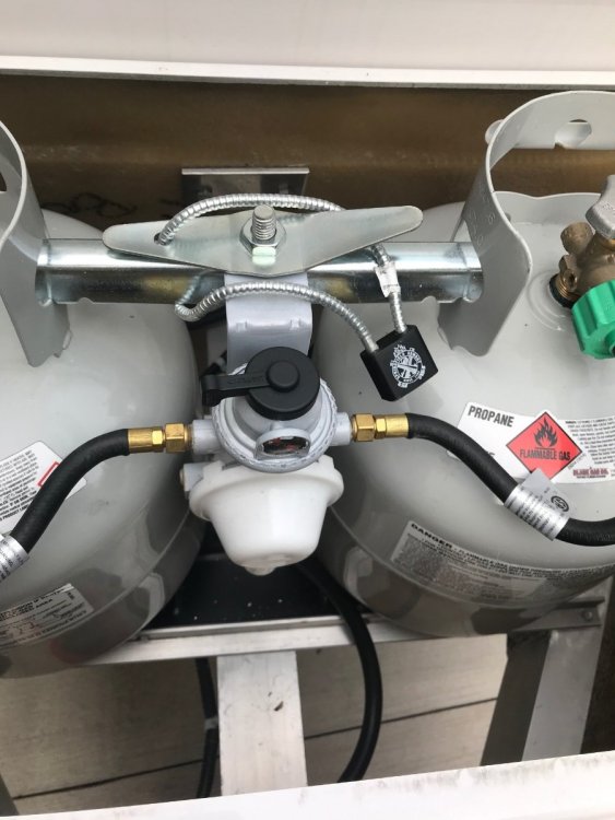

AT $84 for the above lock I opted to go this route.
Well it took a few minutes to drill a pilot hole and then again a little larger to accommodate the cable lock. (I happen to have few firearm cable locks handy😎). Will it prevent a random snatch and grab hopefully and possibly.
Will it stop a determined thief?...absolutely not. But this is what I am rolling with. And the price was right. 😄

4 minutes ago, Mountainman198 said:
Has anyone tried this approach?
I’ve had that same idea, but can the one wing of the big sheet metal wing nut be bent or folded over, by hand or with pliers, to allow the lock to just slide off?
Edited by FrankC
1 minute ago, FrankC said:
I’ve had that same idea, but can the one wing of the big sheet metal wing nut be bent over, by hand or with pliers, to allow the lock to just slide off?
I have not tried it yet either.  Whomever tests it first should post results.  I am not against spending $ to secure the tanks but if a simple solution is possible I'd rather spend the $ on campground fees or gas.

This option only cost me a firearm cable lock and 5 minutes to drill (2) holes. I agree $84 is a lot for the TorkLift tank lock.
Just a thought.
Edited by Patriot
Going to work on Ollie over the next couple days, will give your approach a try!
