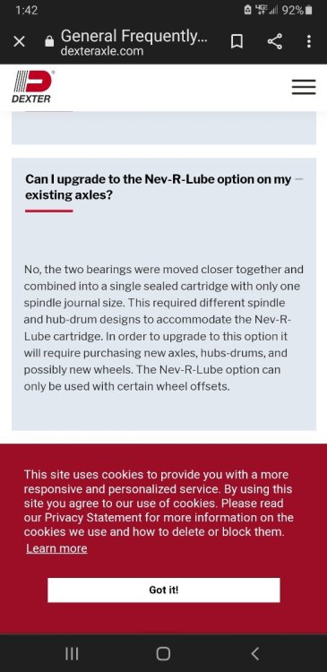

I found this in Dexter faq:
So, the only upgrade is a change-up of axle and quite possibly a lot of other expensive components.

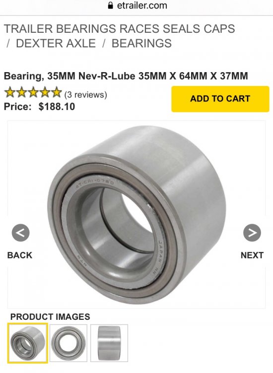

"FYI a replacement Nev-R-Lube bearing assembly itself is extraordinarily expensive and it may require a hydraulic press to install it. So in the event of a failure you will need a tow and a professional automotive or machine shop to fix it - unlike a regular bearing design that can be replaced by a skilled owner with hand tools. A tow will be covered by your roadside assistance insurance, but down time and mental anguish will be high and the shop will charge maybe $100 for labor. You can buy a mechanical puller and do it if you feel capable. Most owners would not be….
http://www.dexterpartsonline.com/files/2036913/uploaded/Nev-R-Lube Bearings.pdf
If the failure is catastrophic, it will trash your brake and perhaps your axle. If you camp in the West in remote areas, the NevR Lube bearings are a huge liability. Some RV shops won’t work on them. They DO fail. If you get this kind of axle, buy and carry a spare bearing, because the parts are not commonly found everywhere. The only way I would want this setup is with disk brakes that have slip on rotors. That way you can carry a complete spare hub assembly and change it yourself in half an hour, and then get the failed bearing replaced at your leisure.
Google “Nev-R-Lube bearing failure”. PS, don’t overload your axles. Do use a TPMS so you will get a heat warning in time.
