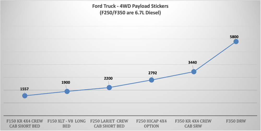

A while back I was trying to understand one key factor in towing, that is Vehicle Payload.
For Ford Truck's I went around to dealers lots and looked at stickers on the door for various configurations.
The ones shown below are all 4x4's but notice how starting at the Left, the F150 King Ranch has much lower payload than a more stripped down F150 XLT.   This payload decreased with increasing luxury happens in all truck lines.
When we started with our new Oliver Elite II , we had a 2018 F150 3.5 Ecoboost King Ranch Crew Cab 4x4... and it had a payload of 1557 lbs.  What we found was after loading bikes, BBQ, camp gear and then added on the trailer tongue weight,  we were always at  or slightly above the payload limit .  We would go to the scales often to double check weights.
On one rather interesting 10% downhill grade in the mountains of Idaho, my wife turned to me and said...do we need a bigger truck.  It feels like we're getting pushed by the trailer. Indeed the trailer and truck weights were very close to each other.
That fall we moved forward in search of heavier diesel truck, and in our case chose an F350 with the 3440 Lb payload.
I love the downhill compression braking capabilities and the stability of this truck and trailer in mountains.   We don't get pushed around on the freeways either.  We have all the payload and tongue capacity so we no longer need the Anderson hitch. (Which is sometimes difficult to get re-attached when at odd angles.)
In any case...good luck making a choice.   Pay particular attention to your style of driving, regions you'll cover (mountains in particular) and how much gear you want to take along as you make a truck selection.
It's important to look at truck Payload as a key indicator of how comfortable your drive will be while towing the Oliver.
CS

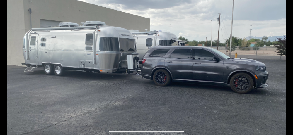

Hi
I don’t have an Oliver yet, but I wanted to share my experience towing my airstream 25fb with both a 2022 F350 tremor and a Dodge Durango Hellcat.
Both vehicles have their pros and cons. For us the Durango is our go to tow vehicle for comfort and roominess.
The only drawback to the Durango is the small fuel tank and inability to tow in the snow (summer performance tires)
