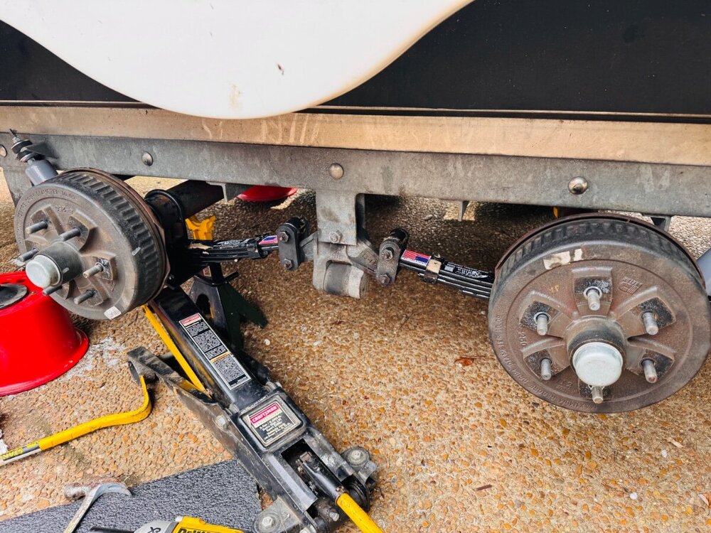

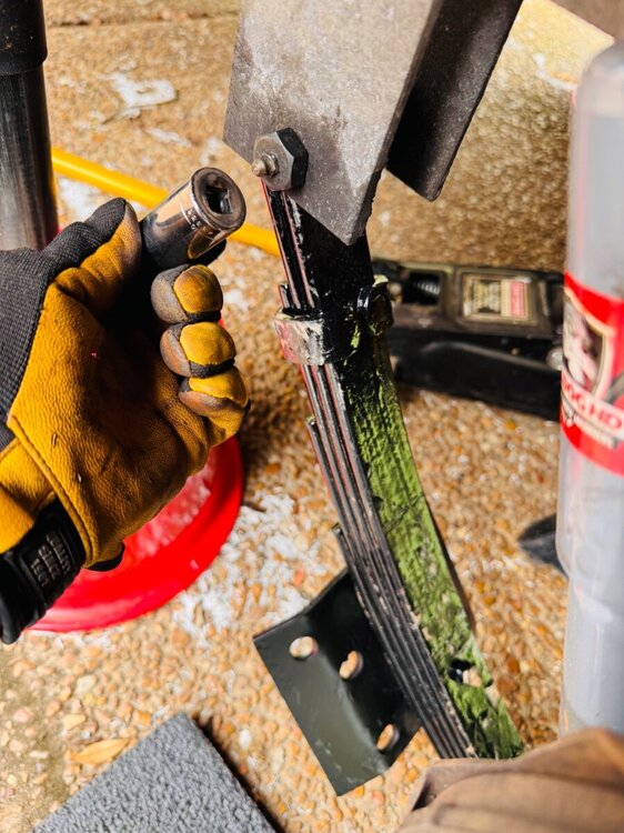

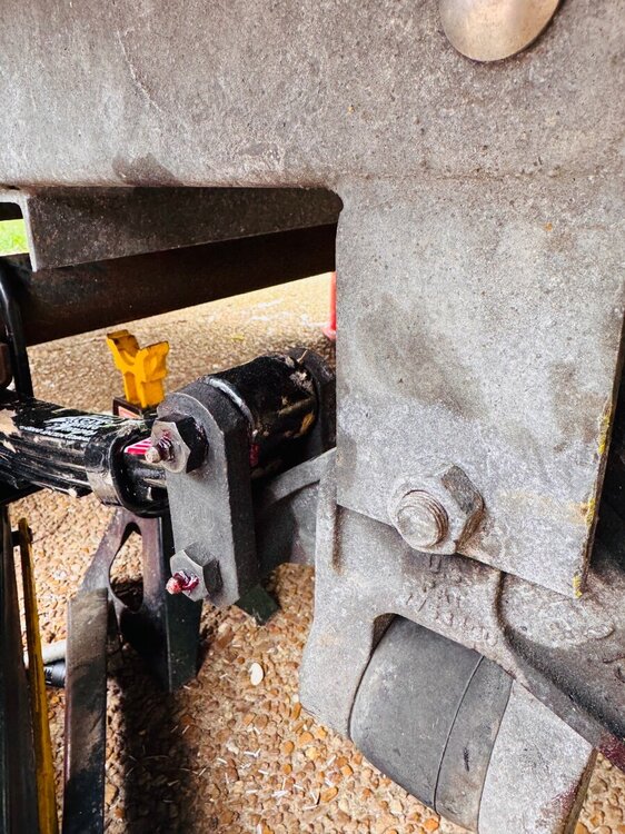

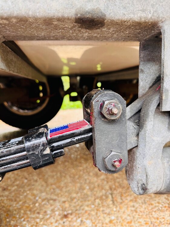

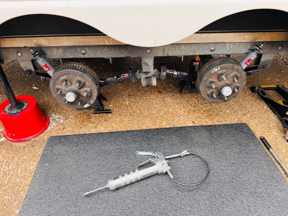

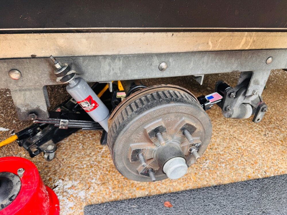

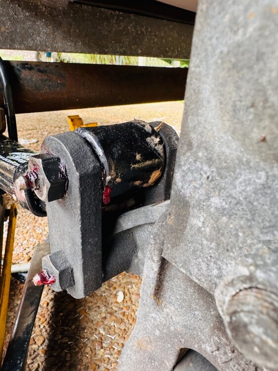

So got the new U-bolts from ALCAN and put the new leaf springs on only to find out the HD 1/2 in. OEM shackles were too short. They are the HD 1/2 in width but 2 in long measured zerk to zerk. The 2nd leaf rides on the suspension arm.
Talked with Lew, figured out the problem and he is sending out new 2 1/4in HD shackles to resolve the problem.
Confirmed Key points:
3500 lb axles use 4 bolts on the backside of the hub and 1/2 in. U-bolts. They can have tube diameters of 2 1/2 or 3 in. Make sure to measure.
5200 lb axles use 5 bolts on the backside of the hub and 9/16 in U-bolts. They typically have tube diameters of 3 in. Make sure to measure.
If you don't upgrade to the shackles Lew sells, make sure even if you have upgraded HD 1/2 in. shackles to measure the length. If it is 2 in they will not work, must be 2 1/4 in. Make sure to measure.
Lew was great to deal with as always. @ScubaRx I did confirm that he does not want his 2/12 in U-bolts back.
Hopefully, this adds to the conversation since both of these issues came up for me.
Cheers,
Mike
