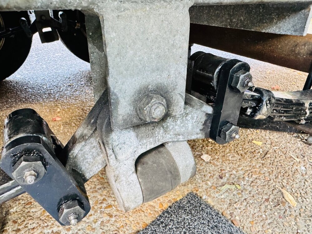

Moderator+ ScubaRx Posted August 27, 2024 Moderator+ Posted August 27, 2024 On 8/25/2024 at 12:16 PM, ScubaRx said: As you are the fourth owner, that may well be the case. I have pictures of yours and another being built for Jim Oliver in 2009. Jim was adamant about there being no such thing as overkill and I know he put 5200 pound axles and the larger five leaf springs under his. Being as all the current models were Elites (at that time) and the only axles and springs they would have had on hand would have been the HD's, I just assumed that yours were too. Jim named that trailer "The Beast" and it had full extension drawers mounted under the hull between the steps and the front axle. Edit: @CRM has located a photo of the underside of Jim's "The Beast." It had four leaf spring packs rather than five so now I wonder if the axles were 5200 pounds when originally built. 1 Steve, Tali and our dog Rocky plus our beloved dogs Storm, Lucy, Maggie and Reacher (all waiting at the Rainbow Bridge) 2008 Legacy Elite I - Outlaw Oliver, Hull #026 | 2014 Legacy Elite II - Outlaw Oliver, Hull #050 | 2022 Silverado High Country 3500HD SRW Diesel 4x4
CRM Posted August 27, 2024 Posted August 27, 2024 3 minutes ago, ScubaRx said: Edit: @CRM has located a photo of the underside of Jim's "The Beast." It had four leaf spring packs rather than five so now I wonder if the axles were 5200 pounds when originally built. The axles tubes look to be a smaller diameter than mine, so maybe? 2010 Elite II Hull #45, the first LE2 sold. 2020 Toyota Tundra TRD Off Road 4WD 5.7 with 38 gallon tank, 4.30 axle and tow package.

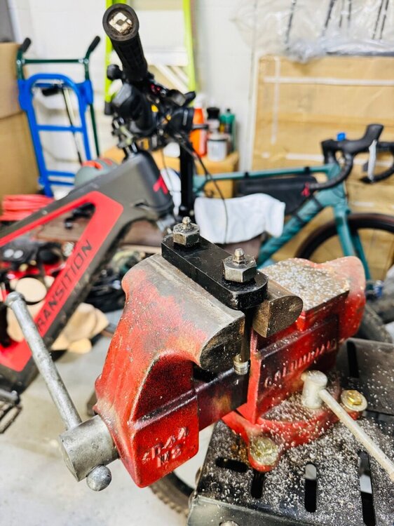

Moderator+ ScubaRx Posted August 27, 2024 Moderator+ Posted August 27, 2024 On 8/26/2024 at 9:52 AM, 2008RN said: Do you press them in place? If so, what is the best way to do this at home without a press? The wet bolt is only pressed into the shackle strap. I don't have a hydraulic press either but I do have a vise and a big ole hammer. Remove the zerk fitting from the end and drop it into the shackle strap orienting the grease exit hole 90 degrees to the strap. Loosely clamp the bolt into the vise and using your big ole hammer tap it down until the backside of the bolt head makes solid contact with the strap. Replace the zerk, or leave it out for now because you're probably gonna have to hit it again to make the shoulder seat against the strap on the other side. DO NOT use tightening the nut in an effort to pull it into place, you will only strip the nut and could damage the threads on the bolt. FYI: In American English, a vice is an immoral habit or practice (or the second in command after the President) and a vise is a tool with closable jaws for clamping things. But in British English, the tool is spelled like the sin: vice. 1 2 2 Steve, Tali and our dog Rocky plus our beloved dogs Storm, Lucy, Maggie and Reacher (all waiting at the Rainbow Bridge) 2008 Legacy Elite I - Outlaw Oliver, Hull #026 | 2014 Legacy Elite II - Outlaw Oliver, Hull #050 | 2022 Silverado High Country 3500HD SRW Diesel 4x4

rideandfly Posted August 28, 2024 Posted August 28, 2024 On 8/26/2024 at 10:52 AM, 2008RN said: Do you press them in place? If so, what is the best way to do this at home without a press? Pins sometimes can be pressed in and out with something like a Ball Joint Service Kit if it will fit within the work space, but it's normally too expensive to justify for one job, unless a friend has one. This Maddox kit from Harbor Freight looks very similar to my Pittsburg kit, it's on sale until 8/29/24 for $44.99: https://www.harborfreight.com/ball-joint-service-kit-for-2wd-and-4wd-vehicles-63610.html 1 Bill 2015 LE2 #75 2024 F350 6.8L
jd1923 Posted August 29, 2024 Posted August 29, 2024 (edited) 5 hours ago, rideandfly said: This Maddox kit from Harbor Freight looks very similar to my Pittsburg kit, it's on sale until 8/29/24 for $44.99: Or you can go to O'Reilly's or most national chain A/P stores and borrow this same tool. They charge the cost of it to your credit card and bring it back in 1-2 days and they will refund/credit your card. We have an O'Reilly's 1/2 mile from home, and I have used their loaner program a good dozen times. I purchased a ball joint press that is much longer required for some applications, but I do ball joint service regularly having rebuilt 3 truck suspensions in just the last 4 years. For the Oliver, just borrow one for free if you need it! Edited August 29, 2024 by jd1923 3 in 4 years, not 2 years (my old body hurts enough!) 5 Chris & John in Prescott, AZ | 2016 EII #113 | '01 Ram 2500 Cummins!
Moderator+ ScubaRx Posted August 29, 2024 Moderator+ Posted August 29, 2024 (edited) Since you (or at least myself) would never try to press the wet bolts into the shackle straps while under the trailer, I can't see this being an issue or a useful tool. If you own a vise and a hammer, you have all the tools you need. If not, this job is probably beyond your capabilities. Edited August 29, 2024 by ScubaRx 1 Steve, Tali and our dog Rocky plus our beloved dogs Storm, Lucy, Maggie and Reacher (all waiting at the Rainbow Bridge) 2008 Legacy Elite I - Outlaw Oliver, Hull #026 | 2014 Legacy Elite II - Outlaw Oliver, Hull #050 | 2022 Silverado High Country 3500HD SRW Diesel 4x4
rideandfly Posted August 29, 2024 Posted August 29, 2024 (edited) 6 hours ago, ScubaRx said: Since you (or at least myself) would never try to press the wet bolts into the shackle straps while under the trailer, I can't see this being an issue or a useful tool. If you own a vise and a hammer, you have all the tools you need. If not, this job is probably beyond your capabilities. When someone makes a different choice on how to do a job does not mean they cannot perform a job. Most folks here probably use a hammer, but there is another way. Edited August 29, 2024 by rideandfly 1 Bill 2015 LE2 #75 2024 F350 6.8L
Geronimo John Posted August 29, 2024 Posted August 29, 2024 On 8/27/2024 at 11:56 AM, ScubaRx said: The wet bolt is only pressed into the shackle strap. I don't have a hydraulic press either but I do have a vise and a big ole hammer. Spot on ScubaRX. Would add well greasing the spring and insert. Also using a deadfall hammer would work a bit better than the big ole hammer. May also cause less damage should we have eaten our Wheaties that morning. 🙂 GJ 2 TV: 2019 F-150 SuperCrew Lariat, 3.5L EcoBoost, 10 Speed Trans, Max Tow, FX-4, Rear Locker OLLIE: 2018 OE2 Hull 342, Twin Bed. OLLIE DIY’s: Timken Bearings, BB LiFePO4's, Victron 712 Smart, 350 Amp Master Switch, Houghton 3400, Victron Orion DC - DC, 3000-Watt Renogy Inverter, P.D. 60-amp Converter, Frig Dual Exhaust Fans, Kitchen Drawer Straps. Front Wardrobe Shelves, Snuggle Shelf. TV DIY’s: 2 5/16" Anderson System, Nitto recon’s, Firestone Rear Air Bags, Bilstein 5100’s, Mud Flaps & Weather Tech all, installed Ham Radio (WH6JPR).
2008RN Posted August 29, 2024 Posted August 29, 2024 17 hours ago, ScubaRx said: Since you (or at least myself) would never try to press the wet bolts into the shackle straps while under the trailer, I can't see this being an issue or a useful tool. If you own a vise and a hammer, you have all the tools you need. If not, this job is probably beyond your capabilities. Yep, I have a hammer and a mounted vice. I use to be a machinist, and sometimes my mind gets stuck in using proper tools. Big ole hammers and vices just remind me of blacksmithing and welding. I almost thought of spending a few hundred bucks on a Table top arbor press that I could get the 10" drums under for pressing the bearings, but then I figured I was starting to get carried away. 1 Early 1999 Ford F250 SD 7.3L Diesel 2020 Elite II Twin - Hull # 648
2008RN Posted August 29, 2024 Posted August 29, 2024 6 hours ago, Geronimo John said: Spot on ScubaRX. Would add well greasing the spring and insert. Also using a deadfall hammer would work a bit better than the big ole hammer. May also cause less damage should we have eaten our Wheaties that morning. 🙂 GJ I like the deadfall hammer I think I have a 2 pounder. I also have a few large brass punches that I could use with the sledge. I am starting to think it would be fun to borrow the Orielly's ball joint press. I have never used one. 2 Early 1999 Ford F250 SD 7.3L Diesel 2020 Elite II Twin - Hull # 648
rideadeuce Posted August 30, 2024 Posted August 30, 2024 Now y’all have given me an excuse to buy another tool - Dead-blow hammer. Although, I don’t think it would be necessary in this situation. I used a regular hammer and a 3/4 in socket to cover the zerk fitting and it seated easily over strong base like a vise. Unfortunately, I am in the process of changing out the 2 1/4 in shackles for 2 1/2 in shackles that Lew sent me. So after 3 subsequent wet bolt installs I have gotten fairly proficient at it. Hopefully, this time it will give me the necessary clearance for the easy flex to work properly. M 5 - Mike Brentwood, TN - 2018 Elite II - Spirit of Adventure Hull #308 - 2016 Toyota Tundra Limited 5.7L Class IV hitch with 12k lb coupler, Weigh safe adjustable trailer hitch, Dobinsons HD 2in Leaf springs, Timbren bump stops, Dobinsons 3in coilovers and UCAs, Mechman 370 amp HO alternator. Oliver upgrades: Starlink, Cradlepoint cellular modem, Victron Multiplus II 12V 3000W, Ekrano display, Orion XS 50amp DC/DC charger with Anderson connections, Toshiba 6-in-1 Microwave oven - air fryer combo, Atmos 4.4 15k AC/12K Heat pump, Nova Kool 5810 fridge, Epoch 460aH x2, 520 watts solar on top, Custom aluminum bicycle rack, Alcan Springs, Bulldog shocks, Falken H/T02 tires, Seabiscuit Metal Designs front storage box and moose rack.
rideadeuce Posted August 31, 2024 Posted August 31, 2024 (edited) Finally, leaf springs do not hit the Easy-Flex. Installed the 2 1/2 in shackles Lew sent me without difficulty. Two jacks, 13/16 socket, 11/16 socket, 13/16 wrench, 3/8 and 1/2 in torque wrench, hammer, vise, Impact wrench, wrags, and LockNLube grease gun. I know I was 2 out 1500 on the coupler issue but I can't believe that I am the only one this was happening to after upgrading to the ALCAN springs. Happy that I did not cut them to fit and theoretically the increase in 1/2 in shackle length should lower the camper by the same. So the first pull up the driveway will be the test but I did cut off about 1/2 in of bolt length on the back of the bike rack to make up difference. Again, just happy that everything is back together and working. Looking forward to fall trip and going on the ALCAN eventually! Best, Mike BEFORE AFTER Edited August 31, 2024 by rideadeuce 8 - Mike Brentwood, TN - 2018 Elite II - Spirit of Adventure Hull #308 - 2016 Toyota Tundra Limited 5.7L Class IV hitch with 12k lb coupler, Weigh safe adjustable trailer hitch, Dobinsons HD 2in Leaf springs, Timbren bump stops, Dobinsons 3in coilovers and UCAs, Mechman 370 amp HO alternator. Oliver upgrades: Starlink, Cradlepoint cellular modem, Victron Multiplus II 12V 3000W, Ekrano display, Orion XS 50amp DC/DC charger with Anderson connections, Toshiba 6-in-1 Microwave oven - air fryer combo, Atmos 4.4 15k AC/12K Heat pump, Nova Kool 5810 fridge, Epoch 460aH x2, 520 watts solar on top, Custom aluminum bicycle rack, Alcan Springs, Bulldog shocks, Falken H/T02 tires, Seabiscuit Metal Designs front storage box and moose rack.

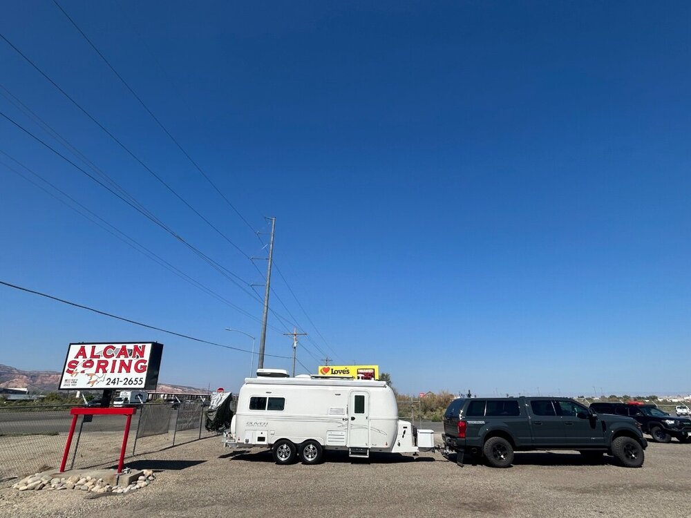

Popular Post Patriot Posted September 6, 2024 Popular Post Posted September 6, 2024 (edited) This morning we had the 5 leaf pack installed on Hull #634 XPLOR at the Alcan shop here in Grand Junction, CO. We had an excellent experience from start to finish. We opted for the upgraded heavier duty wet bolts, nyloc nuts, Alcan HD 2 1/2” shackles. Our Monroe shocks are still in good shape with less than 2500 miles on them. Over all very happy with the work performed by Tucker at Alcan, he has installed the custom 5 leaf pack on a number of Olivers. Lew the owner was excellent to deal with and explained everything in detail. If you have questions about the install, parts or pricing, give Lew a call. Now we can get on with our trip to Utah, Wyoming and maybe Montana. Onward & Safe Travels! Drop off early morning - yes we hit the loves to top off with diesel, saving 76 cents per gallon with our TDS Open Roads Fleet card. We love LOVES. Ha! Thanking Lew 2.5 hrs later after the new leaf packs were installed. Gotta have a little swag.. Decal swag - Optional upgraded wet bolts. Torque specs - Edited September 8, 2024 by Patriot Highlight torque spec for Ubolts and Shackles 5 9 1 2020 OLEII - Hull #634 aka- “XPLOR” 2021 F350 6.7 liter Diesel Lariat Ultimate Tremor aka - “Beast of Burden” Truma Aventa 13.5 AC, Alcan 5 leaf pack, Alcan HD shackles & HD wet bolts, 5200lb never lube axles.XPEL 10 mil PPF front both front corners, 30 lb LP tanks, Sea Biscuit Front Cargo Storage box. ⚡️⚡️11/2025- Lithium upgrade to XPLOR - (2) Epoch 300ah Lithium batteries, Victron 3000W MultiPlus-II, Victron GX Touch 70, Victron Cerbo GX, Victron Smart Solar MPPT, Victron Smart Shunt, Victron Orion XS 1400 DC-DC charger, RV Soft Start. Zamp 90W suit case solar panel for 420W of solar.⚡️⚡️ North Carolina
John Dorrer Posted September 6, 2024 Posted September 6, 2024 (edited) 5 hours ago, Patriot said: This morning we had the 5 leaf pack installed on Hull #634 XPLOR at the Alcan shop here in Grand Junction, CO. We had an excellent experience from start to finish. We opted for the upgraded heavier duty wet bolts, nyloc nuts, Alcan HD 2 1/2” shackles. Our Monroe shocks are still in good shape with less than 2500 miles on them. Over all very happy with the work performed by Tucker at Alcan, he has installed the custom 5 leaf pack on a number of Olivers. Lew the owner was excellent to deal with and explained everything in detail. If you have questions about the install, parts or pricing, give Lew a call. Now we can get on with our trip to Utah, Wyoming and maybe Montana. Onward & Safe Travels! Drop off early morning - yes we hit the loves to top off with diesel, saving 76 cents per gallon with our TDS Open Roads Fleet card. We love LOVES. Ha! Thanking Lew 2.5 hrs later after the new leaf packs were installed. Gotta have a little swag.. Decal swag - Optional upgraded wet bolts. Torque specs - Nice. I will talk to you when we are together to discuss the torquing. I'm a bit confused looking at the drawing. I'm sure when it gets explained to us by Alcan it will make sense. Edited September 7, 2024 by John Dorrer Typo 1 John & Susan Dorrer, 2013 F250, 6.2 gasser, 4x4, 2022 Legacy Elite 2, twin beds, Hull #1045, Jolli Olli -
rideadeuce Posted September 7, 2024 Posted September 7, 2024 (edited) 4 hours ago, Patriot said: We opted for the upgraded heavier duty wet bolts, nyloc nuts, Alcan HD 2 1/2” shackles. Glad to see he used the 2 1/2 in shackles. Now, I am not the only one. 🙂 Great post. Enjoy the rest of your trip! Edited September 7, 2024 by rideadeuce 1 2 - Mike Brentwood, TN - 2018 Elite II - Spirit of Adventure Hull #308 - 2016 Toyota Tundra Limited 5.7L Class IV hitch with 12k lb coupler, Weigh safe adjustable trailer hitch, Dobinsons HD 2in Leaf springs, Timbren bump stops, Dobinsons 3in coilovers and UCAs, Mechman 370 amp HO alternator. Oliver upgrades: Starlink, Cradlepoint cellular modem, Victron Multiplus II 12V 3000W, Ekrano display, Orion XS 50amp DC/DC charger with Anderson connections, Toshiba 6-in-1 Microwave oven - air fryer combo, Atmos 4.4 15k AC/12K Heat pump, Nova Kool 5810 fridge, Epoch 460aH x2, 520 watts solar on top, Custom aluminum bicycle rack, Alcan Springs, Bulldog shocks, Falken H/T02 tires, Seabiscuit Metal Designs front storage box and moose rack.
Patriot Posted September 7, 2024 Posted September 7, 2024 2 hours ago, John Dorrer said: Nice. I will talk to you when we are together to discuss the torquing. I'm a bit confused looking at the drawing. I'm when it gets explained to us by Alcan it will make sense. John, sounds great, it goes without saying, glad to help out. We’ll chat soon! 2020 OLEII - Hull #634 aka- “XPLOR” 2021 F350 6.7 liter Diesel Lariat Ultimate Tremor aka - “Beast of Burden” Truma Aventa 13.5 AC, Alcan 5 leaf pack, Alcan HD shackles & HD wet bolts, 5200lb never lube axles.XPEL 10 mil PPF front both front corners, 30 lb LP tanks, Sea Biscuit Front Cargo Storage box. ⚡️⚡️11/2025- Lithium upgrade to XPLOR - (2) Epoch 300ah Lithium batteries, Victron 3000W MultiPlus-II, Victron GX Touch 70, Victron Cerbo GX, Victron Smart Solar MPPT, Victron Smart Shunt, Victron Orion XS 1400 DC-DC charger, RV Soft Start. Zamp 90W suit case solar panel for 420W of solar.⚡️⚡️ North Carolina
Patriot Posted September 7, 2024 Posted September 7, 2024 16 minutes ago, rideadeuce said: Glad to see he used the 2 1/2 in shackles. Now, I am not the only one. 🙂 Great post. Enjoy the rest of your trip! Thanks! 👍🏻😊 I like the 2 1/2” HD shackles. In fact I like just about everything HD or over engineered. Glad I got this spring/shackle upgrade completed.✅ The Team at Alcan are top shelf! 4 2020 OLEII - Hull #634 aka- “XPLOR” 2021 F350 6.7 liter Diesel Lariat Ultimate Tremor aka - “Beast of Burden” Truma Aventa 13.5 AC, Alcan 5 leaf pack, Alcan HD shackles & HD wet bolts, 5200lb never lube axles.XPEL 10 mil PPF front both front corners, 30 lb LP tanks, Sea Biscuit Front Cargo Storage box. ⚡️⚡️11/2025- Lithium upgrade to XPLOR - (2) Epoch 300ah Lithium batteries, Victron 3000W MultiPlus-II, Victron GX Touch 70, Victron Cerbo GX, Victron Smart Solar MPPT, Victron Smart Shunt, Victron Orion XS 1400 DC-DC charger, RV Soft Start. Zamp 90W suit case solar panel for 420W of solar.⚡️⚡️ North Carolina
SNY SD UP Posted September 7, 2024 Posted September 7, 2024 (edited) On 8/27/2024 at 4:40 PM, ScubaRx said: Edit: @CRM has located a photo of the underside of Jim's "The Beast." It had four leaf spring packs rather than five so now I wonder if the axles were 5200 pounds when originally built. Steve @ScubaRx I copied this pic from @topgun2 "Jim Oliver's The Beast" Post, are we seeing 4 or 5 leaves on Jim's Beast? Or do we not count the one that is rolled with the 'wet Bolts'??? Seriously asking for myself... B~OUT Link to Post for context, Edited September 7, 2024 by SNY SD UP Link to Post for context, Maggie & Bryan | Arnegard, ND | 2020 LE II "Twins" Hull #665 | 2021 RAM 2500 6.4L HEMI Gasser 4dr 6.5' bed
Rivernerd Posted September 7, 2024 Posted September 7, 2024 12 hours ago, SNY SD UP said: are we seeing 4 or 5 leaves on Jim's Beast? Looks like 5 to me... 1 Hull #1291 Central Idaho 2022 Elite II Tow Vehicle: 2019 Tundra Double Cab 4x4, 5.7L with tow package
