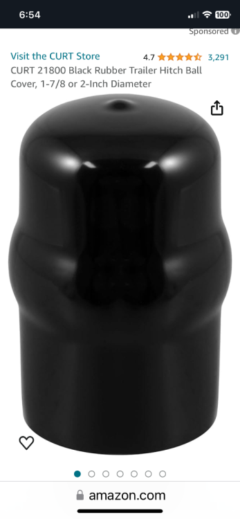

If I am reading that grease inhibits movement, that would not be the case.  For the Bulldog and the Anderson ball, I give both a short spritz from some white lithium grease aerosol.  When I get to the next stop, I wipe out the Bulldog and wipe off the Anderson ball.  The first is to help keep the Bulldog clean.  The latter is to help keep my jeans or leg clean.
One more safety must when on any slope of a camp site:  PLEASE remember to have your TV in Park and Parking Brake Set, and most importantly always keep at least one of your safety chains attached until AFTER you have unhooked and leveled her.  If you have any problem at all, she will not be going far.
GJ
12 hours ago, John Dorrer said:
We will also grease the ball.
I found this product a few year ago and really like it, been using their dielectric grease for 7 or 8 years, as well. It took a couple trips to work all of the old grease off of the Bulldog after initially wiping clean with paper towels, perhaps a thorough cleaning with a solvent would have been a better approach. Most of all, since it is clear/opaque there is no soiling of self or clothes. I also use a hitch ball cover when unhooked to help keep the ball free of dust and debris, as well as a clean hand when handling the hitch.
