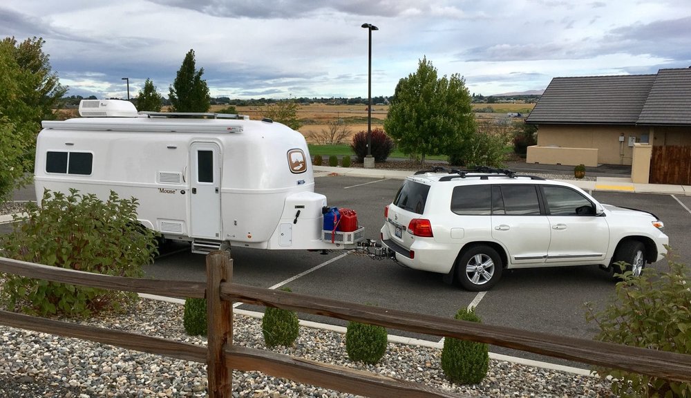

John E Davies Posted September 1, 2017 Posted September 1, 2017 I just threw mine in the trash. All it does is catch junk and it is extremely hard to clean behind. After cleaning the gelcoat (wow it was nasty!) I think the trailer looks way better without it. I don't think I will mind it being gone since it never rains around here long enough for me to worry about spending time under a deployed awning while it was coming down ..... I do plan to add a gutter over the side and back windows this winter. BTW, mine came off in one pull in about five seconds, leaving no glue residue behind, but it had only been on there four months.... Has anybody else intentionally removed it? Any regrets? I think this should be a no charge option, to just leave it off during the build..... and to also leave off the permanent ink guidelines the tech drew on the fiberglass as an installation aid! Maybe polishing compound will get them off. ;( John Davies Spokane WA SOLD 07/23 "Mouse": 2017 Legacy Elite II Two Beds, Hull Number 218, See my HOW TO threads: Tow Vehicle: 2013 Land Cruiser 200, 32” LT tires, airbags, Safari snorkel, Maggiolina Grand Tour 360 Carbon RTT.

John E Davies Posted September 25, 2017 Author Posted September 25, 2017 No seal: We haven't been rained on yet but I still like it. If it rains really hard we will just stay indoors. My wife has no opinion on the seal.... John Davies Spokane WA 1 SOLD 07/23 "Mouse": 2017 Legacy Elite II Two Beds, Hull Number 218, See my HOW TO threads: Tow Vehicle: 2013 Land Cruiser 200, 32” LT tires, airbags, Safari snorkel, Maggiolina Grand Tour 360 Carbon RTT.

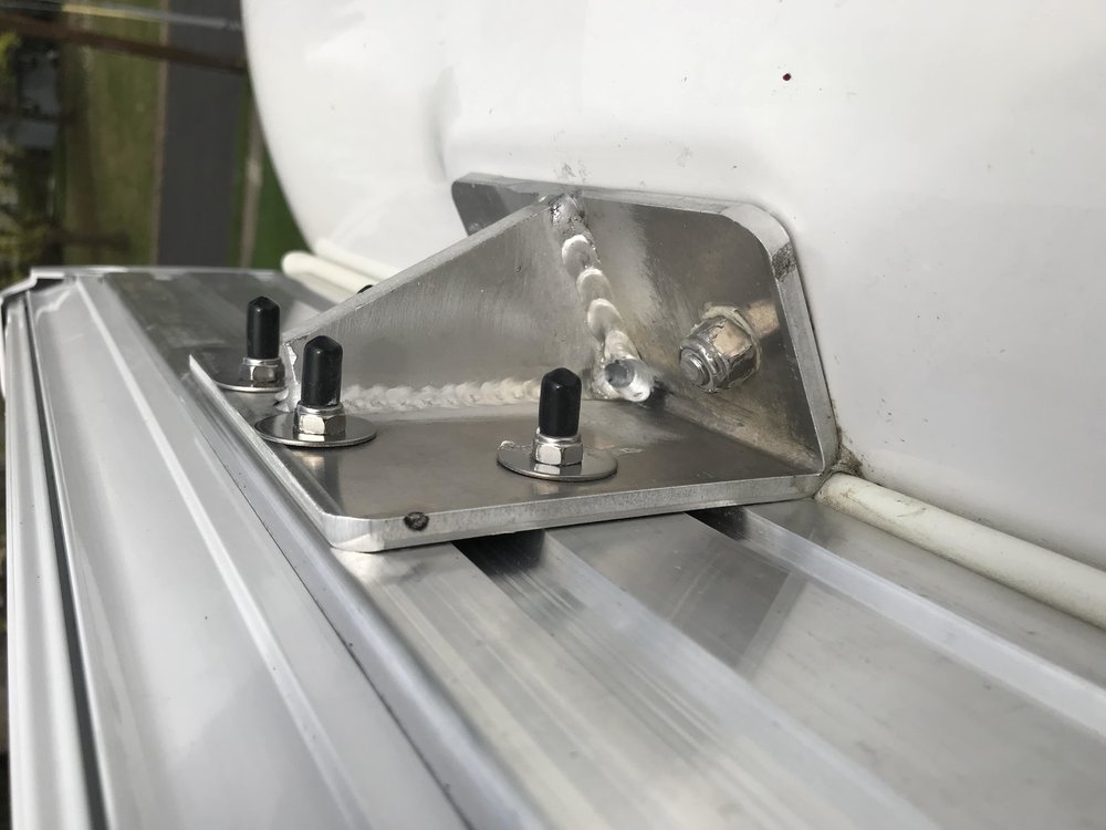

mdernier Posted April 14, 2019 Posted April 14, 2019 I'm resurrecting this thread because I just picked up my rig (on 04-11-2019) and see that water pools behind the awning when the seal is in place (see pic #1, IMG_6248). Although I like the idea of preventing rain from running down the entire side of the rig, I don't like 2-3 inches of water pooling back there. The water pools around the awning brackets and much of the bracket is submerged. I suspect that the holes for the bracket bolts go all the way through the outer shell, thereby presenting 8 potential leak points. There is evidence of sealant on only some of the mounting brackets and bolts, so I would assume a steady diet of pooled water would find its way into the rig up there. I'm trying an alternative to removing the seal altogether, which is to slide in a small drain tube in each "pool basin" (see pic #2, IMG 6250). We'll see. 1 3 Looking forward to years of exploring in our 2019 LE II, pulling with an F150, V8, 3.73 rear, 4x4 Off Road, tow package . . . All I need to do is retire first! Matthew <><

Overland Posted April 14, 2019 Posted April 14, 2019 Interesting - your bracket design is new. Mine doesn't have the vertical stiffener, and that looks like why yours is holding so much water. I wonder what's the reason behind changing the bracket, and I'm thinking that no one in the design process realized they were building a small dam. 1 2
mdernier Posted April 14, 2019 Posted April 14, 2019 I agree with you, Overland. That design is just a non-starter for me. 1 Looking forward to years of exploring in our 2019 LE II, pulling with an F150, V8, 3.73 rear, 4x4 Off Road, tow package . . . All I need to do is retire first! Matthew <><
Moderators Mike and Carol Posted April 14, 2019 Moderators Posted April 14, 2019 Interesting – your bracket design is different than mine. Mine doesn’t have the vertical stiffener, and that looks like why yours is holding so much water. I wonder what’s the reason behind changing the bracket. At some point they change awning vendors and quit using the Fiama awnings and went to another brand. Maybe the brackets changed then. I pulled my seal off after a couple of years, it was starting to crack in a few places, didn’t look good and was a big collector of pine needles, leaves, dirt and other gunk. I guess it’s a personal preference thing. Mike 3 Texas Hill Country | 2016 Elite II #135 | 2020 Ram 2500 6.7L

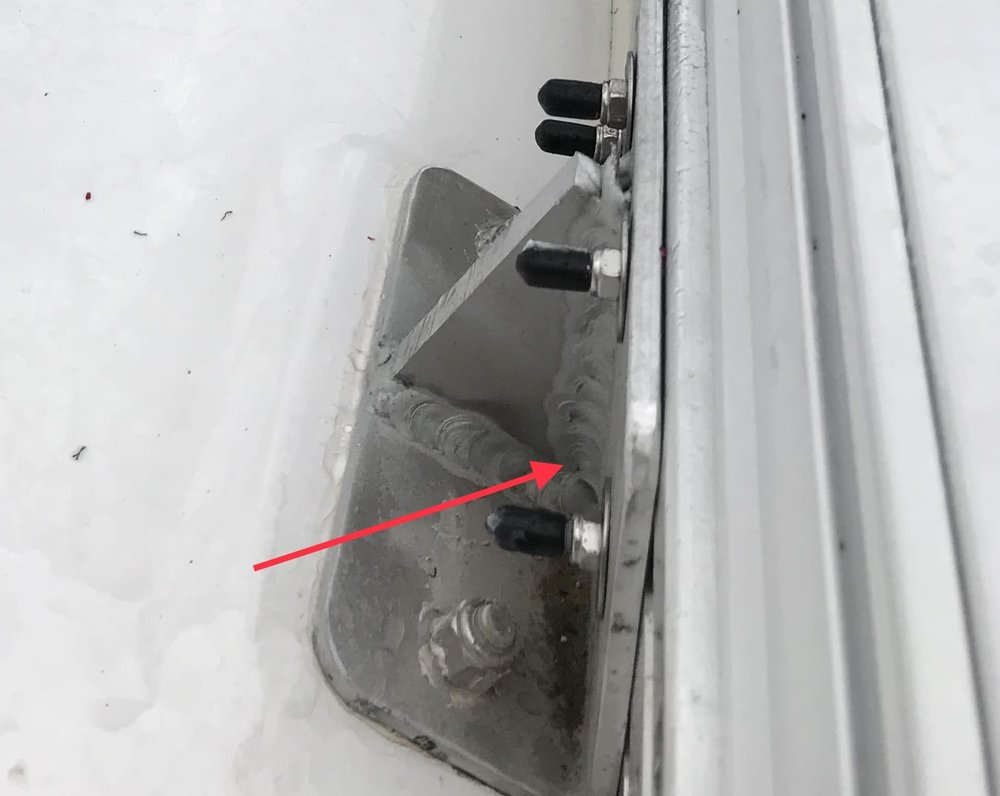

John E Davies Posted April 14, 2019 Author Posted April 14, 2019 The folks that assemble these trailers do not always think about drainage. The cabin steps trap lots of water when folded and need some holes. My suggestion before you remove the rubber seal is to drill a couple of 1/4” or larger drain holes as indicated. They need to be large enough so that tree droppings won’t plug them up. In winter that may not be enough. If you store it outside the seal should be removed entirely or you will get a large ice dam. Since I started this thread I have had no regrets about taking it off. Well, one regret. The tech who installed it used a permanent blue ink pen to lay out some guide lines and they won’t come off! Have you alerted the factory about this issue? It is not something minor and they need to know. John Davies Spokane WA 1 2 SOLD 07/23 "Mouse": 2017 Legacy Elite II Two Beds, Hull Number 218, See my HOW TO threads: Tow Vehicle: 2013 Land Cruiser 200, 32” LT tires, airbags, Safari snorkel, Maggiolina Grand Tour 360 Carbon RTT.

mdernier Posted April 14, 2019 Posted April 14, 2019 John, thanks for the idea. I may wind up doing that in the long run. I kind of like the idea of removing the seal altogether, except for over the door and as many of the windows as possible. I plan on informing the factory but have not yet done so. 2 Looking forward to years of exploring in our 2019 LE II, pulling with an F150, V8, 3.73 rear, 4x4 Off Road, tow package . . . All I need to do is retire first! Matthew <><
Overland Posted April 15, 2019 Posted April 15, 2019 Ideally, they'd add a 1" or so spacer between the mount and awning. Then they could lower the awning back down to meet the roof with a seal, just 1" further forward, and there wouldn't be any obstruction from the mounts at all. Even though I don't have the vertical dam on mine, it's still the mounts that collect the garbage. I think a clean, unobstructed seal would collect far less gunk, and be much easier to spray out with a hose. I also think that they could use a stiffer and easier to clean L-shaped gutter rather than trying to seal it with the soft gasket. 1 3
BackofBeyond Posted April 15, 2019 Posted April 15, 2019 I agree the seal really holds an inordinate amount of trash behind the awning, as do the mounting brackets (as JD shows), but I think I'm going to live with ours for awhile. I'll just hit the area with a good strong water blast when Ollie gets a bath. At some point it may become history, but for n0w, not. At some point, I've got to just use the Oliver, and stop re-engineering stuff...…… well, that and buying more chairs....and, and, and... RB 2 Cindy, Russell and "Harley dog" . Home is our little farm near Winchester TN 2018 Oliver Legacy Elite II - 2018 GMC 2500 Duramax "Die young - As late as possible"
mdernier Posted April 18, 2019 Posted April 18, 2019 Well, John, I opted to drill drain holes through the bracket webs as you suggested. See attached pic (sorry, but the Forum software always seems to turn my pics 90 degrees). I went with a 5/16 diameter drill bit. I'm sure that debris will clog the holes from time to time, but I'll just have to keep after them (along with the other 1,000 items that I'm keeping after). I'll let everyone know how/if it works. 2 2 Looking forward to years of exploring in our 2019 LE II, pulling with an F150, V8, 3.73 rear, 4x4 Off Road, tow package . . . All I need to do is retire first! Matthew <><
mdernier Posted April 23, 2019 Posted April 23, 2019 John, Thanks for the idea - which I implemented. (See attached pic.) I used a 3/8 drill bit on about half of them until it broke, then completed the rest with a 5/16. A hose test just after completing the drilling process passed with flying colors. But that test was sterile, i.e., there was no "gunk" from overhanging trees on the roof which would flow and lodge within the holes. Alas, it's spring, so I've allowed said gunk to build - and indeed it gets lodged at the entrance to each hole. Yet, the water still drains off, albeit a bit slower than when the holes are completely clear. So, keeping up with the debris on the roof is (another) maintenance item. P.S. I plan to apply some Dicor lap sealant to the bracket as water will obviously get behind the bracket (and do bad things, especially in the winter). In fact, I've applied Dicor to all of the roof components. 1 2 Looking forward to years of exploring in our 2019 LE II, pulling with an F150, V8, 3.73 rear, 4x4 Off Road, tow package . . . All I need to do is retire first! Matthew <><

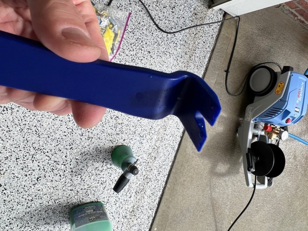

Jps190 Posted March 24, 2022 Posted March 24, 2022 The Girard awnings have the same type of seal. I removed mine today. It left some residue behind that I removed with an auto trim removal tool. 2 3 John and Kim 2021 GMC Sierra 2500 AT4 6.6L Duramax 11350 GVWR 3048lb Payload 2021 Oliver Elite II. Hull #887

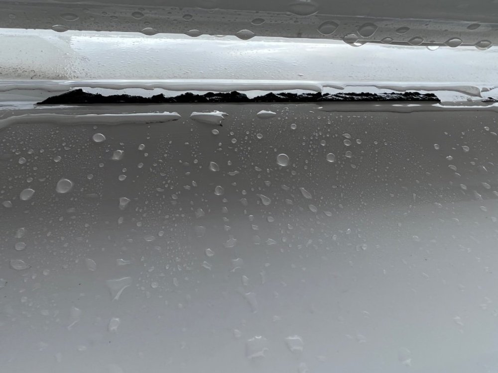

VBistro Posted March 24, 2022 Posted March 24, 2022 On 3/3/2022 at 12:50 PM, Steph and Dud B said: Will be interesting to see what the new Girard awnings have for a seal. Not a good one, so far. 🙂 We picked up VellOllie last November and she's been under wraps until yesterday. When we took the cover off, we noted that about two feet of the seal on the rear street-side was hanging loose, as well as about a foot on the front curb-side. We're going to attempt to re-attach today with some alien tape (unless someone has a better suggestion). We get lots of afternoon showers where we camp, so having a dry patio/entry is one of our favorite things -- and one of those things we missed dearly with our awning-less sprinter van. 1 1 2 MaryBeth Boulder, CO 2022 Elite II #953 TV: 2021 Ford Expedition Max Platinum, Max Tow Package
Moderators topgun2 Posted March 24, 2022 Moderators Posted March 24, 2022 Since you are still under warranty, I'd email, call or submit a Service ticket and see what they recommend for reattaching that seal. Bill 3 2023 Ford F150 Lariat 3.5EB FX4 Max Towing, Max Payload, 2016 Oliver Elite II - Hull #117 "Twist" Near Asheville, NC
