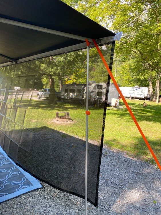

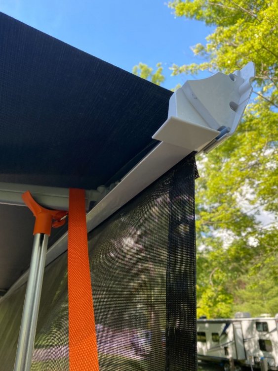

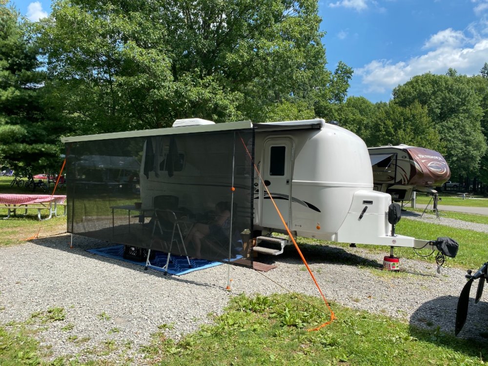

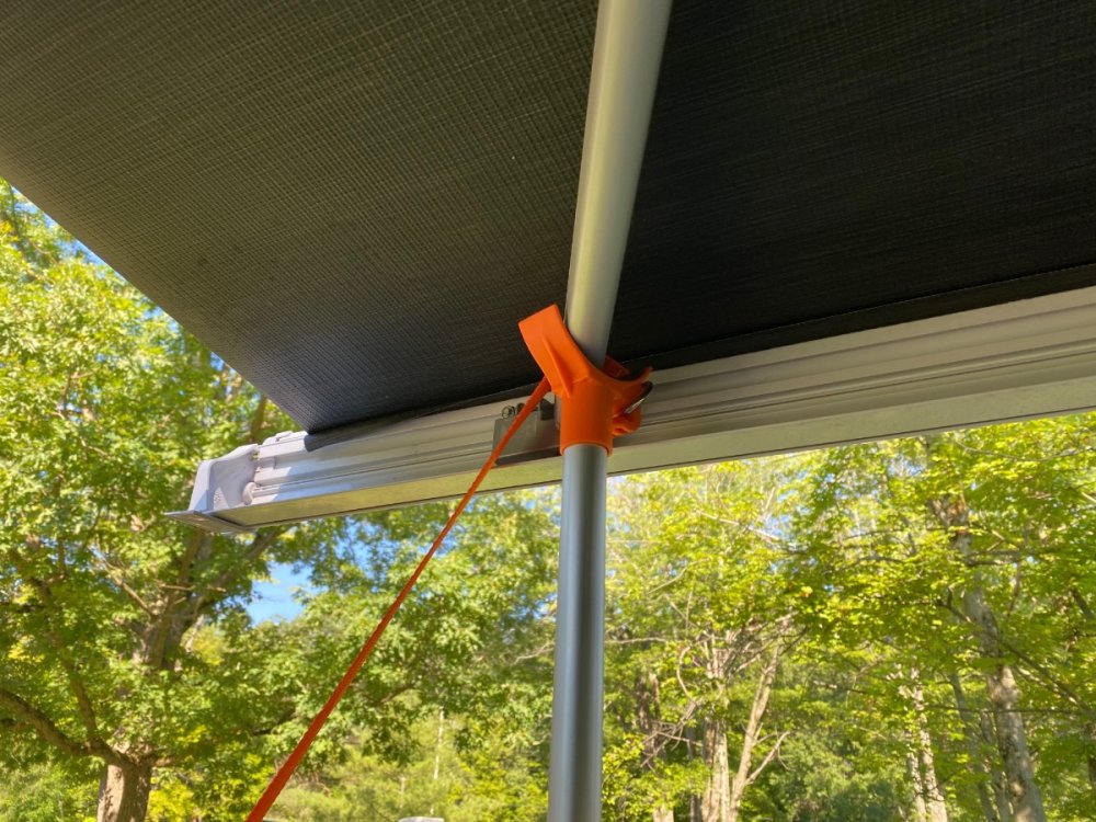

Donna and Scott Posted March 11, 2021 Author Posted March 11, 2021 Thanks 3 minutes ago, FrankC said: The carefree poles have a cradle and strap setup to attach to the awning. Here are some pics of our setup with the poles. We have the Dometic power awning. We shut off the awning power when using the poles and straps so we don’t accidentally try to retract it when it’s anchored down. And then turn the power back on when it’s time to retract. Carefree HD Stabiliz’r Awning Support Pole Kit - R019399-002 https://www.amazon.com/dp/B08528L363/ref=cm_sw_r_cp_api_glt_fabc_7WGPCPPHQ46HZ5NZ6FXZ?_encoding=UTF8&psc=1 Thank you, this is perfect #837 started this new traveling experience in the summer of 2021 and loving it. TV is 2020 Durango Citadel or 2021 Dodge 1500 diesel V6. 2021
Overland Posted March 11, 2021 Posted March 11, 2021 I'd use a little bit of caution when using tie downs at just the ends. With a decent breeze, we can see the outside rail of ours visibly bending when we've only staked out the two outside points. Another strap in the center prevents that; and with that setup, we've weathered some pretty intense winds. We use REI awning poles with ours. They're sturdier than the Carefree ones, but require you to drill small holes in the bottom of the rail to accept the pin on the end of the poles. 1 1
Frank C Posted March 11, 2021 Posted March 11, 2021 (edited) 9 minutes ago, Overland said: I'd use a little bit of caution when using tie downs at just the ends. With a decent breeze, we can see the outside rail of ours visibly bending when we've only staked out the two outside points. Another strap in the center prevents that; and with that setup, we've weathered some pretty intense winds. We use REI awning poles with ours. They're sturdier than the Carefree ones, but require you to drill small holes in the bottom of the rail to accept the pin on the end of the poles. Even with the poles I’m still very cautious (paranoid?) with the wind levels, and will stow the awning if things get above “mouse fart” level wind gusts. 🙂 And ALWAYS stowed away if we are away from the campsite. Edited March 11, 2021 by FrankC
Jairon Posted March 11, 2021 Posted March 11, 2021 10 minutes ago, Overland said: We use REI awning poles with ours. Do you know if the REI poles you use are still being sold? Don't worry about trying to hunt them down if you don't remember the name. Thanks! 2019 Toyota Land Cruiser 2021 Oliver Elite II, Hull #748
Overland Posted March 11, 2021 Posted March 11, 2021 I think they were just called awning poles and they came in two sizes. They’re orange. 1

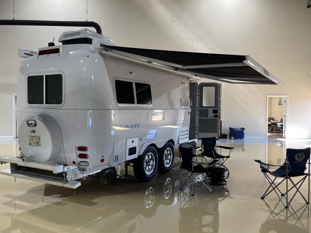

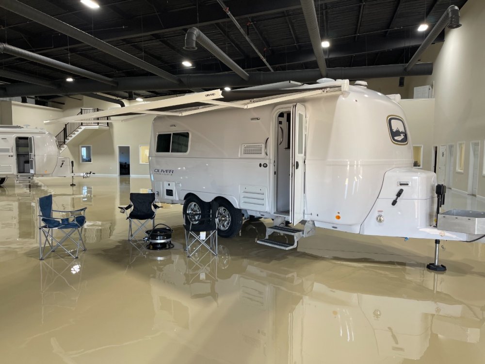

Time2Go! Posted March 11, 2021 Posted March 11, 2021 2 hours ago, DonnaScott73 said: Does the edge of the awning have a place for attaching poles? We get our trailer in July and have to travel to Montana that same month. I want to ha e poles purchased before then I’m pretty sure the 2021 Grard awnings do not have a place to attach poles. I do not remember that on ours we just picked up. Here are a couple of photos of a showroom model if you zoom in you can see the underneath. Cindy 1 1 Charlie & Cindy / Cleburne, TX / 2021 Elite II Hull #743 / 2013 Ford F250 Diesel 4WD Supercab States we've camped in our Oliver:
Overland Posted March 11, 2021 Posted March 11, 2021 Is that Oliver's new showroom? That, my friends, is a shiny floor. 2
Overland Posted March 11, 2021 Posted March 11, 2021 3 hours ago, Time2Go! said: I’m pretty sure the 2021 Grard awnings do not have a place to attach poles. I do not remember that on ours we just picked up. Looks very similar to the Fiamma or Carefree. I'd bet that either the Carefree poles attached like FrankC showed, or the REI with holes drilled in the bottom of the awning rail would work.
Moderators SeaDawg Posted March 11, 2021 Moderators Posted March 11, 2021 3 minutes ago, Overland said: Is that Oliver's new showroom? That, my friends, is a shiny floor. My thoughts, as well. Looks really great! 2008 Ram 1500 4 × 4 2008 Oliver Elite, Hull #12 Florida and Western North Carolina, or wherever the truck goes.... 400 watts solar. DC compressor fridge. No inverter. 2 x 105 ah agm batteries . Life is good.
Moderators topgun2 Posted March 11, 2021 Moderators Posted March 11, 2021 8 minutes ago, Overland said: Is that Oliver's new showroom? Yep. When I was there back in early September, Scott Oliver was in discussions with contractors as to how far this floor would extend - i.e. would the Service/delivery area get the same treatment or not. Bill 2023 Ford F150 Lariat 3.5EB FX4 Max Towing, Max Payload, 2016 Oliver Elite II - Hull #117 "Twist" Near Asheville, NC
Patriot Posted March 11, 2021 Posted March 11, 2021 That is a beautiful show room! The floor shine reflection is impressive, Wow factor!! 2020 OLEII - Hull #634 aka- “XPLOR” 2021 F350 6.7 liter Diesel Lariat Ultimate Tremor aka - “Beast of Burden” Truma Aventa 13.5 AC, Alcan 5 leaf pack, Alcan HD shackles & HD wet bolts, 5200lb never lube axles.XPEL 10 mil PPF front both front corners, 30 lb LP tanks, Sea Biscuit Front Cargo Storage box. ⚡️⚡️11/2025- Lithium upgrade to XPLOR - (2) Epoch 300ah Lithium batteries, Victron 3000W MultiPlus-II, Victron GX Touch 70, Victron Cerbo GX, Victron Smart Solar MPPT, Victron Smart Shunt, Victron Orion XS 1400 DC-DC charger, RV Soft Start. Zamp 90W suit case solar panel for 420W of solar.⚡️⚡️ North Carolina
Jairon Posted March 12, 2021 Posted March 12, 2021 6 hours ago, Overland said: They’re orange. Maybe these in 8 ft? https://www.rei.com/product/845322/rei-co-op-adjustable-tarp-pole-single 2019 Toyota Land Cruiser 2021 Oliver Elite II, Hull #748
BackofBeyond Posted March 12, 2021 Posted March 12, 2021 4 hours ago, Time2Go! said: I’m pretty sure the 2021 Grard awnings do not have a place to attach poles. I do not remember that on ours we just picked up. Here are a couple of photos of a showroom model if you zoom in you can see the underneath. Cindy So far the awnings have never failed inside the showroom - floor shine and all! The sensors for retraction would be a few nanoseconds to late in most sudden gusts. As the awning curls up and over the solar panels - the retractor motor strains to understand why it is struggling ''''''' I'll put mine up. RB 1 1 Cindy, Russell and "Harley dog" . Home is our little farm near Winchester TN 2018 Oliver Legacy Elite II - 2018 GMC 2500 Duramax "Die young - As late as possible"
