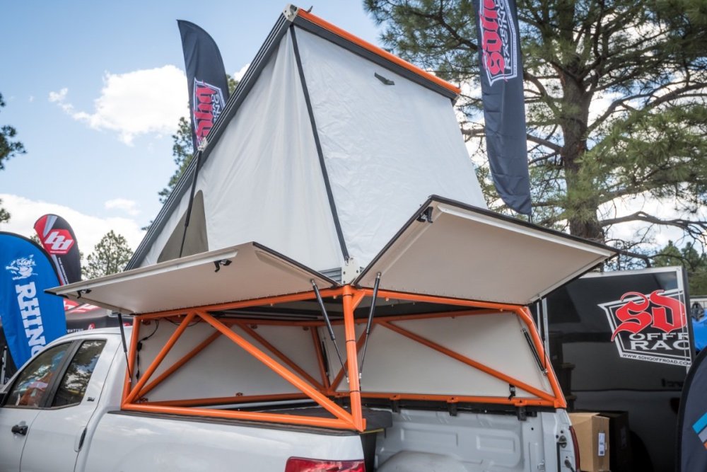

What is that structure -- I like it!

In an alternate future I would have a Power Wagon with a Go Fast Camper on it, so I could boondock a couple of nights in the rooftop tent when exploring the back country, while “Mouse” is safely parked at a more developed base camp campground. The last I heard, GFC was backlogged forever, but recently they have been hiring and working extra shifts to meet the demand.
https://gofastcampers.com/
