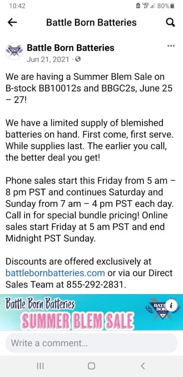

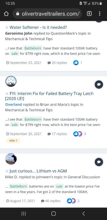

My plan is to start with the standard battery and upgrade to 3 Battle Born batteries in the fall. Ideally BB will have their BF deal again ($670) depending on demand etc.
The Lithionics OTT uses are heated. Battle Born offers heated batteries, but you have to specify you want those. I believe the Battle Born will last longer, according to their data. I considered getting Battle Born for our trailer. However, even with removing the slide out drawer, you cannot get as many amp hour in that space as you get with the two 315 Lithionics for a total of 630 amp hours. The way batteries are advancing, if I ever need to replace the Lithionic, I am sure there will be better options at a later date.
