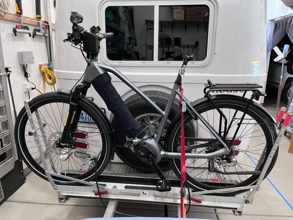

Other than dealing with the "extra" 6 inches or so that the adapter will add I don't see any reasons why it wouldn't work.
A reducing hitch adapter also reduces the max cargo load for the rack by 50%. This is a very bad idea on the back of a trailer, but OK on a car if it has plenty of reserve tongue weight capacity. Plus an adapter will add even more slop in your connection.
Also those Maxx Haul carriers are screwed together, do you really think it has a 500 pound capacity? Look for a fully welded rack like a Pakmule or Northbound. It will cost up to ten times as much, for a reason, it won’t fall apart at 60 mph…
Vic:
From an Engineer's perspective, the ultra long moment arm of the assembly loaded with two heavy E-Bikes gives me concern for even good highway use.  However, with the G-Forces induced by rough roads, and worse if taken off-road, my concern rises to grave.
Under such conditions, be advised that:
  • Due to the moment arm length and heavy load, that it would be prudent to counter balanced (by additional front of trailer loads) to somewhat restore your Ollie's great antisway characteristics somewhat.
  • There is a significant potential for your added hitch, and/or the OTT components supporting it to unexpectently fail.
I highly recommend your shortening the moment arm to a minimum and reduce the load if possible.  As pictured this design IMHO is an accident looking and waiting for the worst possible opportunity to fail.

35 minutes ago, Geronimo John said:
Vic:
