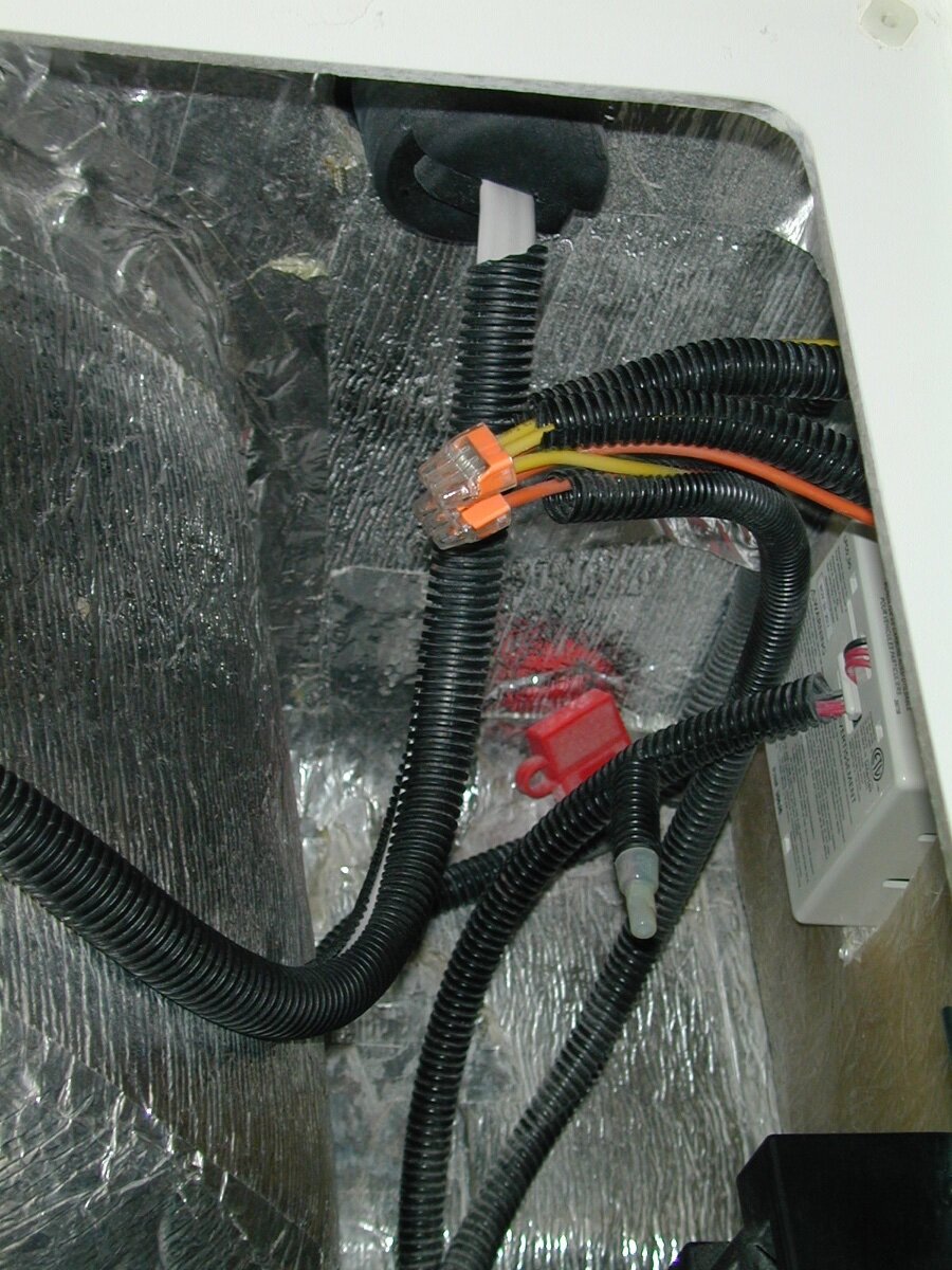

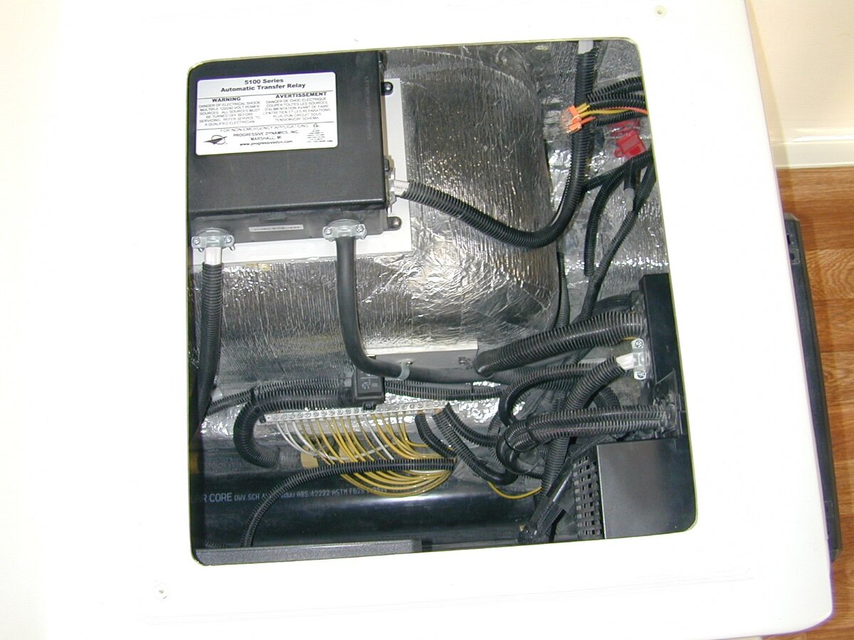

There is a 2-wire pair (mine looked like old brown table lamp cord) which travels through the front and rear axles that bring the current for electric brakes from the Drivers side to the Pass side.  It is a common way RV manufactures do it.  That wire has slack and sits inside and rubs inside those tubes.
Ours rubbed/abraded to bare wires on a couple of surfaces, causing an intermittent short that soon became a constant short.
I basically just cut the old wires off and ran a larger insulated 2-wire pair 12awg across the outside of the back of the axles at the rear so to prevent rock strikes, once I had it all connected. WE HAD BRAKES AGAIN…
I found that removing the wheels made it easier to get in and work at each hub, where green brake wires go into back of the plate to get to the brakes.
Before you cut your wires, maybe test the green wire going into brakes with a meter to make sure.  If you pull the "Brake break-away" cable and then measure the current where the brake wires come in (inside driver side wheel well) you might get a reading, but I am not sure what an electrical short might do to that reading.

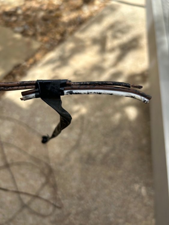

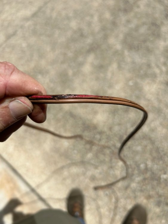

OK, just back from the RV repair shop, again.  They pulled the brake wires from inside the axles and attached new wires, zip tied to the outside of the axle. They gave me the old wires.  One was about 11’ long, the other about 9’.  The excess was stuffed into the axle.  One had a spot where the insulation was rubbed through showing bare wires.  The other had about 6” of electrical tape wrapped around the end where it connected to the brake.  When I took the tape off I found a weird situation that makes no sense to me.  This appears to be the same issue SNY SD UP was experiencing (his photos above).
First, here’s the rub:  (brown insulation worn to the red then to the copper.
Then here’s the end that was taped.  The tape extended from the end of the wires to where my fingers are, making it look as though it was one set of wires.  The ends of the brown pair on top were completely covered with tape and the left end of the bottom brown and white pair was also covered, leaving only the ends of the brown and white pair showing.  So, it appears they were not connected to anything?  The tech simply cut the wires off when he was replacing them which are the brown/white pair.  The top pair has one wire stripped and one is a few inches shorter than the other.  I’m not sure what this was all about.
They zip tied the new wires to the axle.  I will add a few more to what they used.
I had no “trailer brake disconnected” messages on the way home.  We leave tomorrow for our fall trip for some cooler weather and fall leaves.  Hopefully the problem is solved.
I will close out my ticket with Oliver service.  Their only offering was that when they’ve encountered this issue it’s almost always the tow vehicle.  Not in this case.
