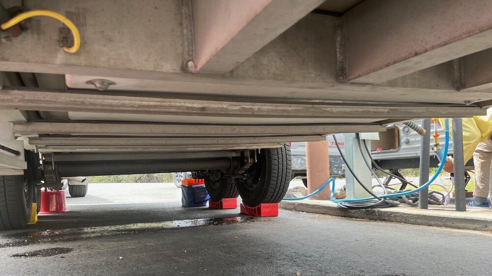

I have a related issue with some frame crossbeams.  I have four and maybe more crossbeams that are sagging (have a belly in the middle). When putting a straight piece of bar stock across the bottom of the trailer's crossbeams, you can see about one inch +/- bow / belly in these crossbeams. Interesting that the beams that are bent are located in the front 1/3 of the trailer ( behind the bathroom and in front of the axles) and the back 1/3  (behind the axles and in front of for the cabinet between the twin beds.  The bent crossbars have no apparent other damage other than the belly. I am a big guy, regardless these beams should not be bent.  Does anyone  have knowledge  or experience with bent crossbeams?
  • Wow 6

On 4/29/2024 at 6:38 PM, taylor.coyote said:
Bent / sagging crossbeams
I have a related issue with some frame crossbeams.  I have four and maybe more crossbeams that are sagging (have a belly in the middle)...
This piqued my interest, and I would like to see a picture of yours too. I got under our Oliver today after reading this. I see 4 crossbeams front of the suspension. 3 of 4 of ours have NO sag. The have an intentional arc but are fully supporting the hull left to right. The front one has a 3/8" gap at the center. The true front of the hull is held up by the heavy frame ahead of these 4 beams, so the first one looks to have no weight on it and merely holds left to right. I don't see much wrong with this, but yours may be worse if all four beams have sagged. It's certainly not the weight of cargo or a person on the inner shell.
Edited by jd1923
Added picture
Exactly right, John.  Our's front cross beam has the same gap with what looks like a rubber gasket between the aluminum and the fiberglass hull...FYI

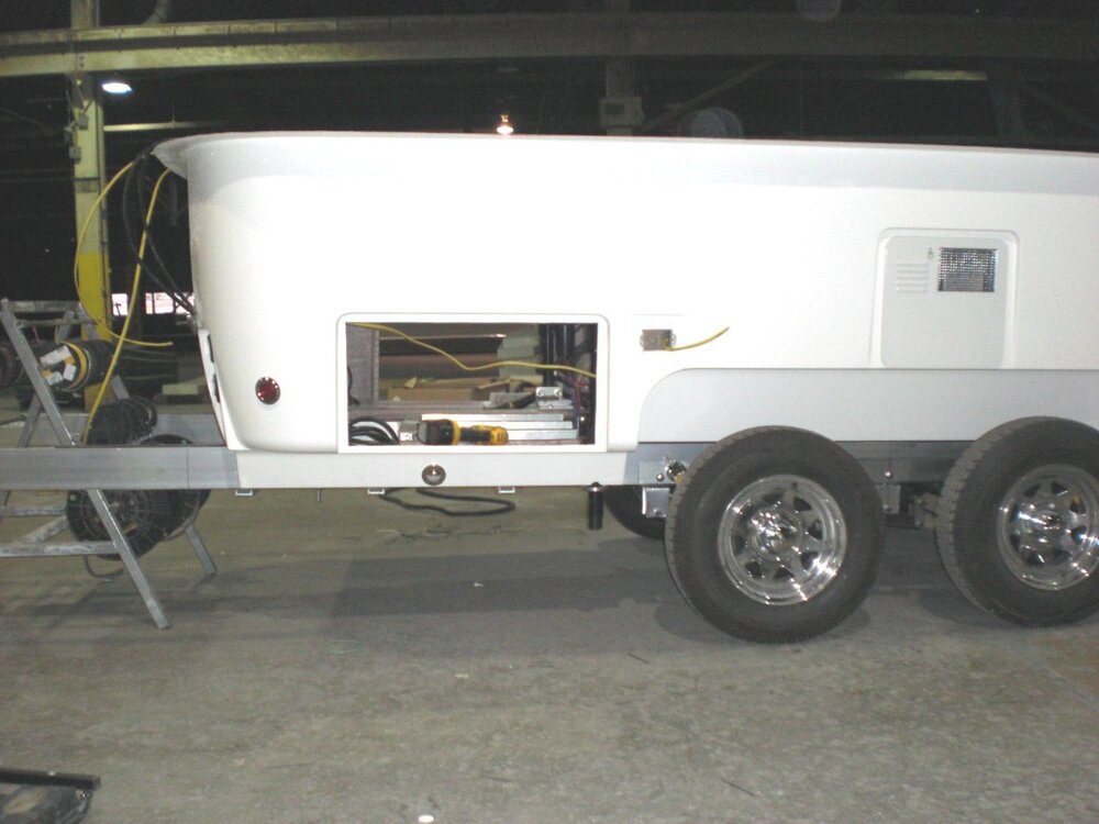

I think I see where the difference in cross members count may be. I have the original brochure for the E2's that came out before the shutdown and they show the rear bumper almost flush with the back of the hull. Maybe 2 or 3 extra cross members added when they extended the bumper and storage area out further? The first one or two E2's that that Oliver's kept must have been built as shown in the brochure and then the design was changed for the one I currently own since my dimensions match the current dimensions.
2010 Elite II Hull #45, the first LE2 sold.  2020 Toyota Tundra TRD Off Road 4WD 5.7 with 38 gallon tank, 4.30 axle and tow package.
2 hours ago, CRM said:
My 2010 has 6 cross members from the rear axle back. Do later models really have 12 of them?
No, but originally there were only four. Like mine, the belly behind the axles started to sag and more were added. Yours was likely repaired prior to your acquisition.
You are correct that the frame's were shorter and the bumpers were almost flush with the back of the hull when the first two 22 footers were built in 2008-2009. They were likely done this way because that's the way the 17 foot Elite rear storage area had been designed.
In 2014, after the hiatus, the decision was made to lengthen the frame on both the models. This was done for looks and since there was no other fiberglass travel trailer this big it made for good marketing. The length of a travel trailer is defined by the distance from the tip of the hitch to the back of the bumper, so the 17 foot Elite became 18.5 feet long and the 22 footer became 23.5 feet long and was finally given an official name, becoming the Elite II.
Even though the rear of the frame was lengthened by 1.5 feet the number of cross members remained the same as before. This 22 foot trailer were built during late 2008 and early 2009 although it was not sold right away. Another unit  was built for Jim Oliver and it was completed. He named it "The beast". A third unit was planned but the company decided to shutter the trailer line and it was never started. Here are a few construction pictures taken during that time period. Some were taken by myself and some by Robert Partee, the sales manager at the time.
Here you can plainly see the frame rails extending far beyond the rear of the body and the cross members welded below the belly.
Edited by ScubaRx
  • Thanks 4
Thanks for the info! One thing that confuses me is that mine was built in 08-09, and titled as a 2010, but is also the 23.5 extended version.  Were there two 22' models built before mine, and if Jim Oliver kept one, what happened to the other?
