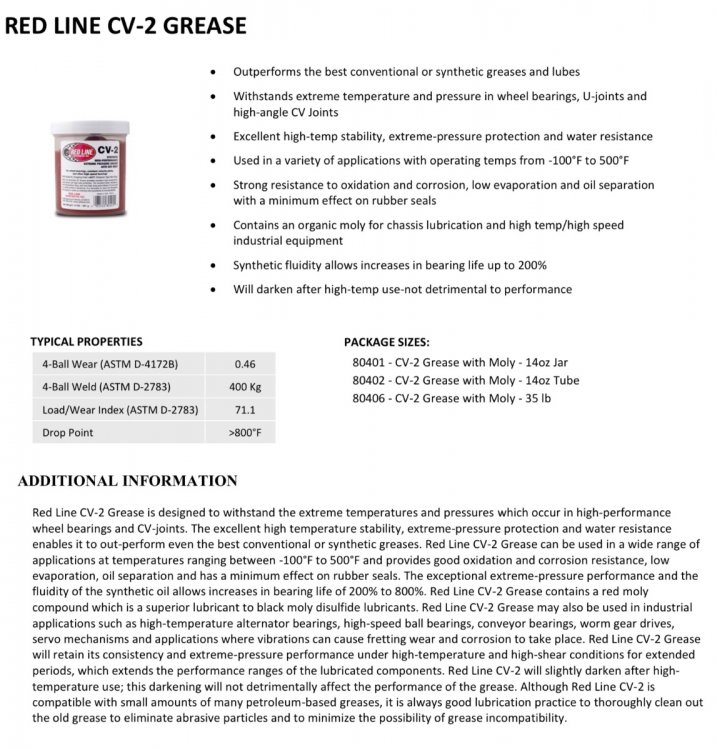

I am sure the Timken grease is really good, and also really expensive. But it is still a regular lithium based product, with all the limitations that come with that kind of chemistry.
If you are going to invest in a premium brand of lubricant, you should probably get the most premium one available.
I have been using CV2 in just about everything for several years now, and I am not going back. I used to pay $14 for a dinky 3 ounce tube of special Phil Wood  bicycle bearing grease, for just $2 more I get 14 ounces, so now I just use the Redline.

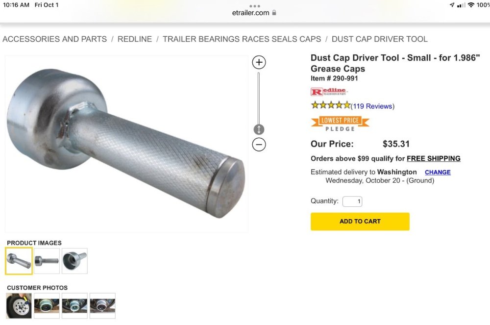

FYI you can remove and drive in races and seals with a big hammer and an old screwdriver, but proper tools make the job SO much easier, and you will not swear nearly as much. A seal puller, bushing driver set and an axle cap tool are great to have, if you have room to carry them.
Buy this for sure, check prices because they vary wildly: …
If you also buy a water heater pressure relief valve removal socket, you can nest the two parts, wrap them in movers stretch wrap (U-Haul), and they don’t take up much space at all.

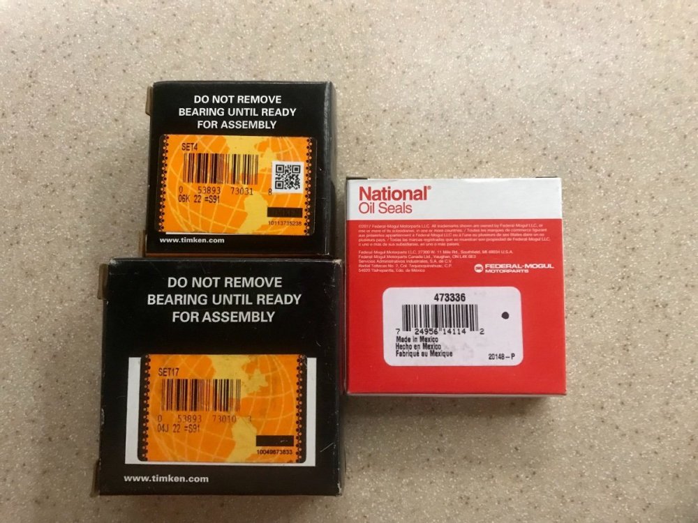

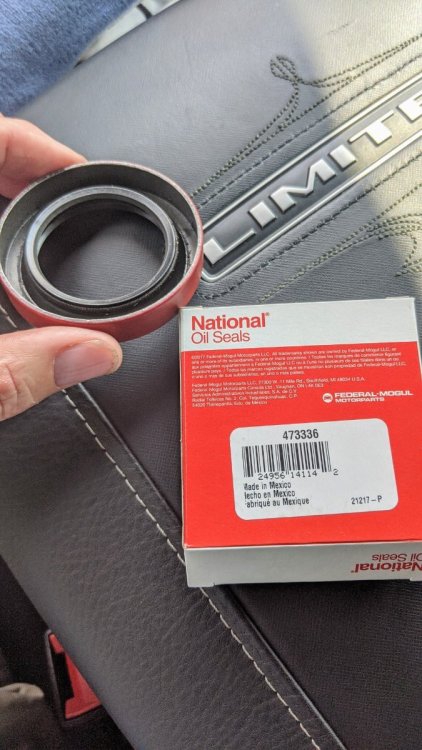

Finally. I have a part number to the seal. I leave in a week and needed to find local.
O'Reilly Auto Parts had what I needed. But again, they only had four left in stock. I bought all of them. These seals are heavier duty compared to what I took out.
National Oil Seals
Part number 473336
Approximately $12.50 each

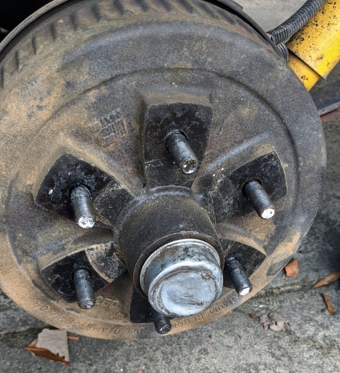

Also, I took the second tire off and discovered a very abused grease cap. I mean, good grief, how hard do you have to hit a aluminum cap to get it back on. Mechanic must have had anger issues. PXL_20211001_203928575.thumb.jpg.9e3b478803a7c8dc904539dce63f22df.jpg
