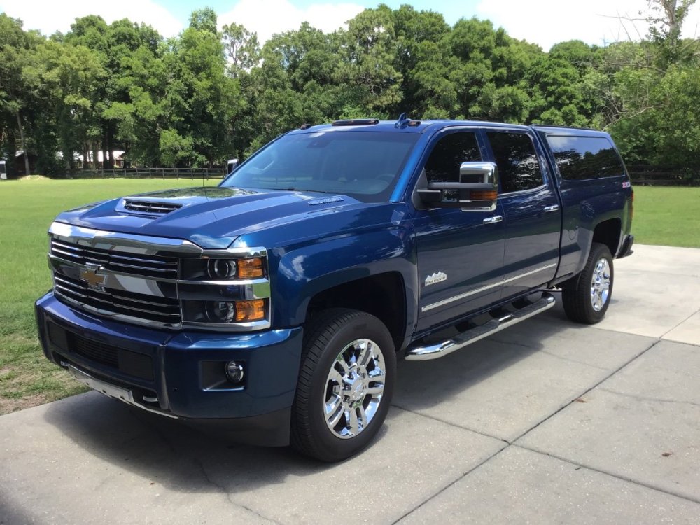

Here's my two cents...I've owned 4 diesel P/u over the years.  All have been good trucks.  Currently, have a Ford F-350 diesel.  My last was a 2005 duramax with over 300,000 miles.  I've  hauled hvy farm equiupment with them in the past.  However, will only be hauling a jet boat and an Oliver now.  I wouldn't be without a 4X4 P/u  and if your just hauling an Oliver a diesel might be over kill.  However,  I enjoy pulling my boat out of steep and rough ramps with my current diesel TV.  I tow the boat to various lakes in my area that have grades, you can't beat the breaking with a diesel. Mine has a 10 speed transmission and turns under 1500rpm at 55.  Mileage is fine if you can keep it under 60mph.  And, a 47 gal. fuel tank makes finding a pump, not an issue.  With that said, most would do fine with a 4X4 2500 gas, IMH0.  Get what suits your needs.
And they look bad ass too. 😬
