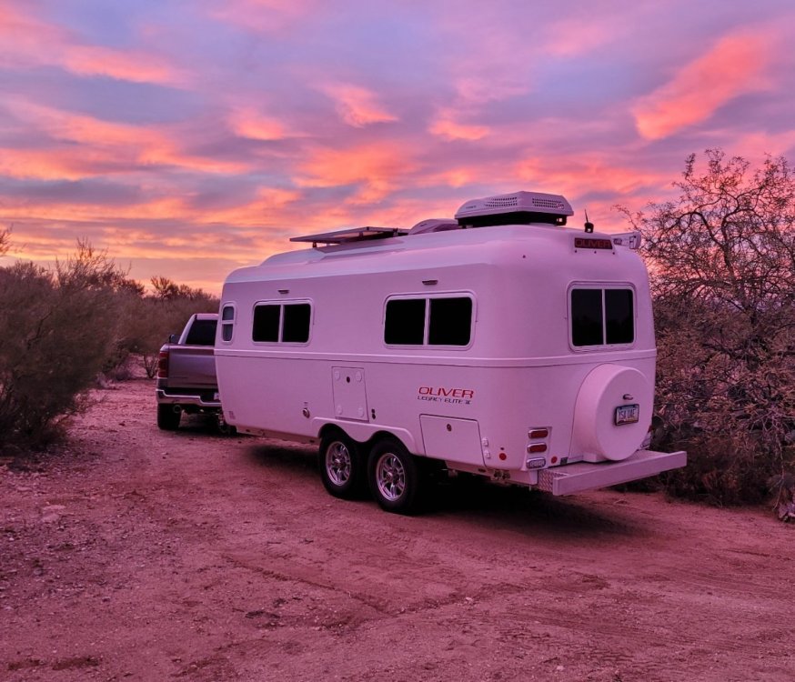

Oliver is upping their game as far as off grid / boondocking ability are concerned.  Mostly due to improvements in solar / battery / components etc.  I think they can nibble around the edges of the overland market.  Not the hard core expedition guys...   who will go the 4x4 van, Earthroamer, jeep with rooftop tents, and the like.  But the folks who want to get out into BLM land away from the crowded campgrounds.  And still have the creature comforts that the Oliver brings to the table.   Serious off grid / road capability puts you into a whole new category of vehicle, with a whole new price tag.    Any choice you make will involve compromise as to capability, components and price.   Do your research.  Read and consider everything.  I think you'll find yourself coming back to Oliver.
We "boondock" in our E2.  The hitch, ground clearance, tire size and suspension system make our Ollie very maneuverable in the rolling desert hills.  Amen.
Charlie
Charlie
Charlie, awesome photo. Calendar quality. Please forward to @MDuncan
