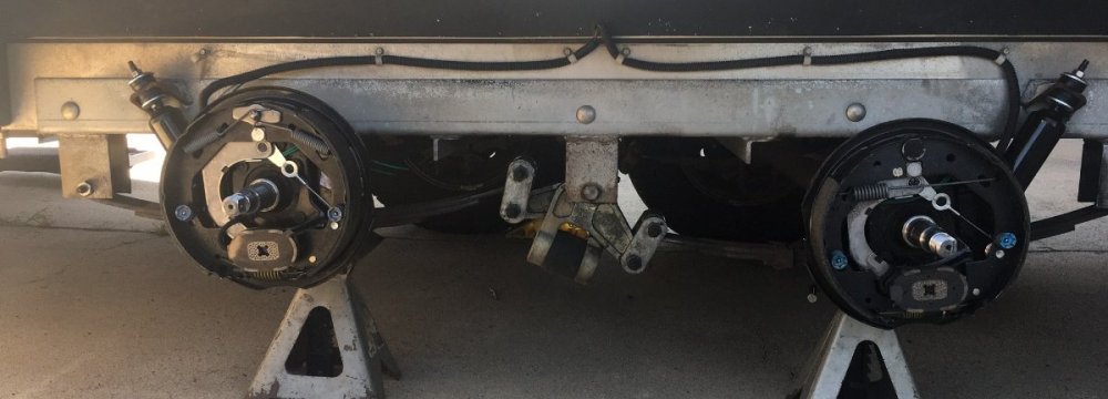

Best to call them and ask. Their specialty is custom leaf springs, based upon owner provided specs. You will need to provide them with msmts, loaded weight, likely gvwr and perhaps more details. I would be surprised if they would be unwilling to make something custom to meet your specs

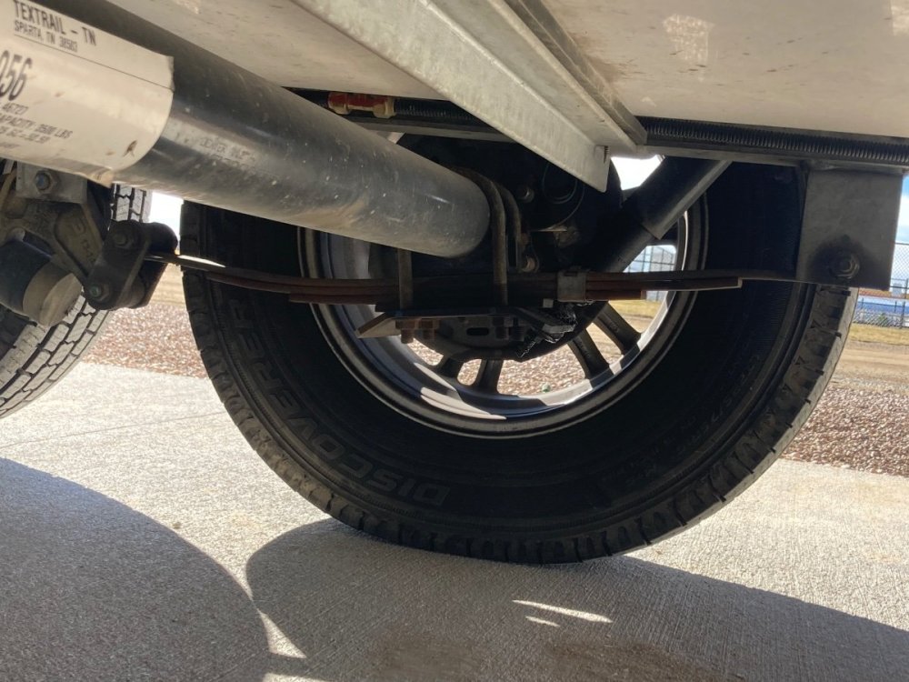

On 3/5/2024 at 4:54 PM, Mountainman198 said:
The curb side rear spring was in the process of failing as well. Starting to flatten with the rearward end starting to invert.
Checked under ours today. I inspected all 4 leaf springs and was happy to see all four, in 8 locations front and back, were as straight as can be. Straight meaning an equal symmetrical arc front to back, no sag of the main leaf on the ends, as the example clearly seen on the right side of this picture. It appears that our Oliver sits a good 1-2" taller without the leaf bends shown here.
This doesn't mean they cannot fail in the future, but the leaf will likely bend some at this location prior to failure. Looking at the cross-section of the steel in the leaf that had failed, it does not look to have been hardened properly. Our Oliver has lived life in the SW and our leaf springs only have very light surface rust. Given this inspection, I will drop replacement leaf springs to the bottom of my to-do list. Though I'm still very interested in this supplier, and the installation and road test of @Mountainman198 and others here.
