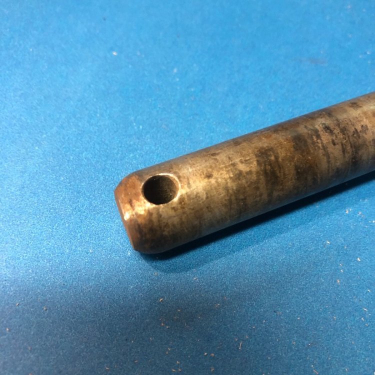

Blum-Anderson Posted August 1, 2021 Author Posted August 1, 2021 I rounded the end of mine. If necessary, I tap with a rubber mallet.
