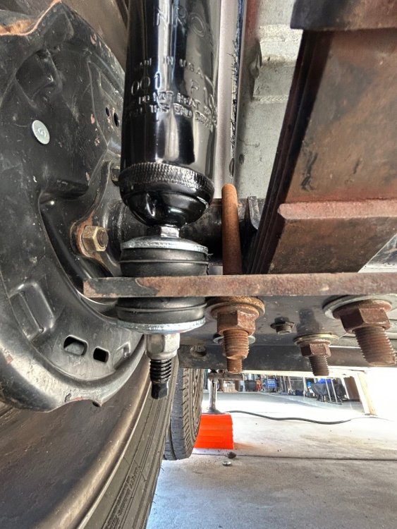

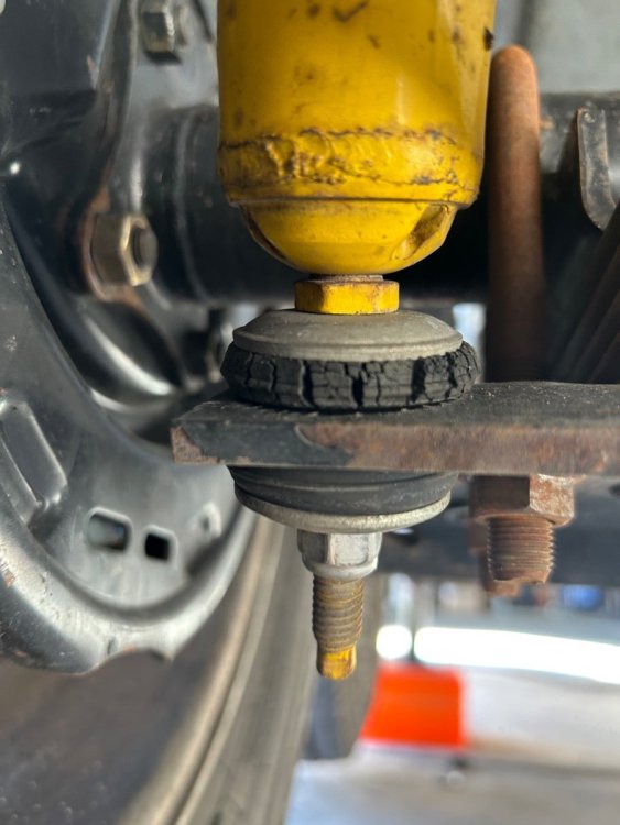

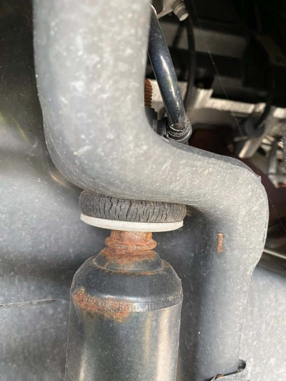

I opened a ticket on this topic with Oliver early last week.  I sent them these two photos from our trailer, and commented that I would like assurance that the shock absorbers are properly mounted and safe (it does not look like the best of designs when the rubber gasket and mounting plates overhang the frame bracket).
I received the following answer: " I looked under a couple of the camper and the spacing looks to be the same on all of the units as it is on yours. The cracking is normal as well."
While the shock absorber mount may be the same on all of the current units, it is clearly installed so that only a portion of the rubber bushing is doing its job—the other portion doesn’t touch the frame mount.  While this is probably safe enough, the shock absorber bolts might not need to be tightened as much if the entire bushing had contact with the frame mount, and in which case the rubber bushings might not be cracking so early in the life of the shock.  In any case, the shock absorbers would not come with a full rubber bushing if the manufacturer intended for only a portion of the bushing to have contact with the frame.
My next step was to send an inquiry to the shock absorber manufacturer, but without removing and inspecting the shocks closely, I do not see a brand or manufacturer's name.  Does anyone have more information on these black shocks with no apparent brand name?

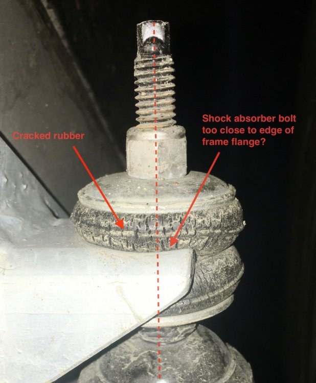

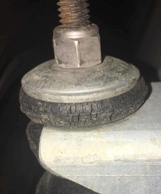

Yeah, apparently making shock bushings that don’t degrade & split is an unknown science that seems to elude most companies. 🙄 Here’s a pic of the shock bushings on my 2 year old F-250.
But at least the bushings on the F-250 appear to be fully supported, not hanging off the edge of the support bracket.  I hope Oliver takes steps soon to get the holes for the shocks drilled more accurately (further inboard) so the bushing is fully supported by the bracket.

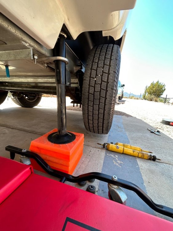

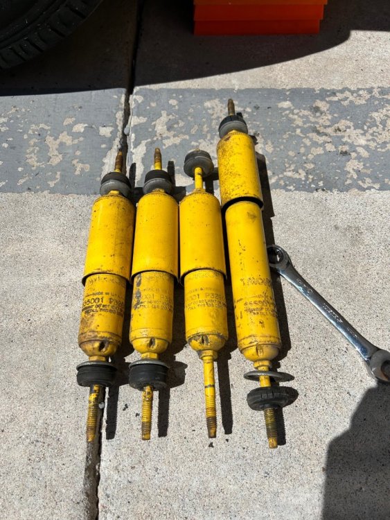

Back story:  I noticed last week that we may have a couple of leaky Monroe shocks after doing a fairly major undercarriage power wash of our Ollie's running gear.  That said, I ordered 4 Monroe replacements last Thursday and we wandered off for an extended Easter weekend at a lakeside state park in southern NM to get into some warmer climes.  Anyhow, that was a 380+ round trip drill, right?
So, as I was cleaning the rig this morning, FedEx arrives with the replacements - perfect frigg'n timing.  I jacked-up and jack-standed the Ollie and commenced the shock R&R drill many of you have done over the years.
Here's the deal...  I'm fairly certain the shocks I removed on this drill were originals from the Oliver factory.  The R&R went smooth as it could have.  The only modification was adding fender washers on the upper and lower brackets and fresh nyloc nuts.
At the end of the day - uplifted peace of mind regarding the running gear package.  As it turned out (see pix) 3 of the four Monroes were Tango Uniform - they were just along for the ride and not providing any stability to the overall suspension system.  A functional shock when compressed will expand to its fully extended length.  The pic shows 3 of the removed Monroes compressed and not extending.  Only one was marginally operational.  Not good, IMHO.
RECOMMENDATION:  I believe these units were at least 5+ years old.  So, if any of y'all out there are kinda like me and can't sleep at night when you know something's "not quite right" - and you may have 5+ year old vintage shocks, take a couple hours and check 'em out before your next road trip.  Granted the Ollie suspension isn't "bomb proof" but it is somewhat robust as compared to other SOBs.  With dual leafs and the Dexter coupler, the shocks contribute to stabilizing g-forces and actually aid in reduceing tire wear while being towed.  That is... if the shocks are working as designed and not blown out.

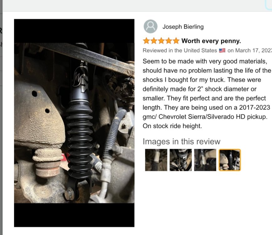

@rideandfly@MAX Burner
When the time comes for our shocks to be replaced I will consider a set of these for the new shocks. They are likely to last a lot longer than the cheap rubber bushings   - https://www.summitracing.com/parts/ens-9-8101r?seid=srese1&gclid=CjwKCAjwrdmhBhBBEiwA4Hx5g1EmNbsDrEQeAq0_LONOYG_UhdlvY6ePhChw2orxOwCvV5eUD0qi7hoCoC0QAvD_BwE

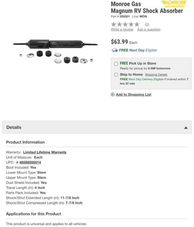

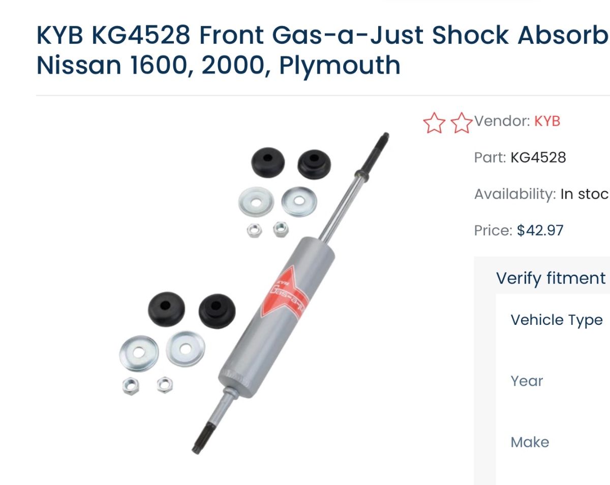

In my quest to find something better than the Monroe shocks I was given this part from KYB but I've learned that it might not be suitable because of the exposed rod and the beating the underside of our trailers take from rocks, road debris, etc.  This shock suggestion came from Shockwarehouse.com
This part could be a consideration if there was some sort of protective sleeve for it but I'm not sure that one exists.
I was not able to find a cross reference to other manufacturers like Bilstein.  This shock was all I found that was reasonably compatible with the Monroe specs.
I've read comments from Monroe buyers that some of their shocks never extended properly but there was also feedback from RV owners that used the Monroe's and they had good luck with them.
Could you rob the shield off the Monroe shocks and use it with your KYB's and reuse the old Monroe cupped washers too?
GJ
GJ
I might order both shocks and see what kind of a mess I'd get into if I tried to retrofit the shield from the Monroe.
It's unfortunate that there isn't a better option out there.  Ultimately, I'm sure I'll end up ordering the Monroe's and keep my fingers crossed that I get 4 decent ones.
Thanks for the clever idea GJ!
I am fairly certain that it is welded at the upper mount. You might have better luck fitting rubber motorcycle fork or 4x4 shock booties.
https://www.amazon.com/Supreme-Suspensions-Universal-Lifted-Trucks/dp/B07K4CSQSD/ref=sr_1_18?crid=FQ28L7L7JFB6&keywords=motorcycle+suspension+rubber+boot&qid=1681360885&sprefix=motorcycle+suspension+rubber+boot%2Caps%2C211&sr=8-18
Clamp the top to the upper mount with a plastic bushing, cut off the bottom and let it dangle down over the shock body. leave the bottom open for drainage. I’m not saying that would work, but I think changing the steel ones is a non starter…unless you are a skilled welder.
