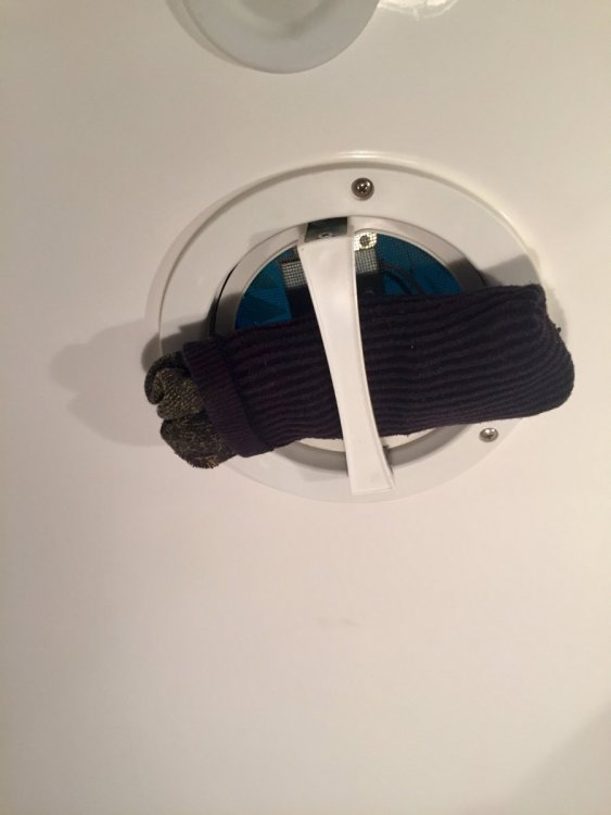

 I noticed this happening on our last trip. My temporary fix was obviously to stuff a sock in it.

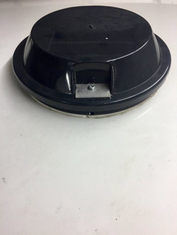

 When we were back  home I found that the plastic hood was deformed around the screw that mounted it to the inside handle. So this caused a small air gap around the plastic hood where it made contact to the frame. This resulted in wind getting underneath and lifting it open. The remedy was to use a heat gun and warm the plastic around the screw hole and then form it flat again. Once the plastic cooled off it stayed flat. I then added a flat piece of stainless steel as a back up plate. I did use some silicone sealant between the hood and the plate. So far it has cured the problem.

The only additional thing I would have done (and maybe you did it but it is hidden under the SS plate) would be to apply a bit of sealant around that screw just to make sure that it would not leak.  Great solution and nice work!
p.s.  I also liked the sock and stick as temporary fixes.
We have a microfiber towel hanging in the bath that we use to wipe down after showering.  When we travel, we roll it and put it in the handle to keep it closed when driving.  It works well.  Mike

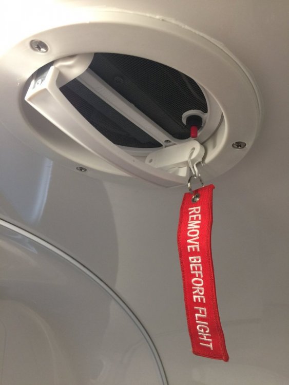

My interim solution is a pair of the ever popular RV magnetic catches. Fit perfectly.

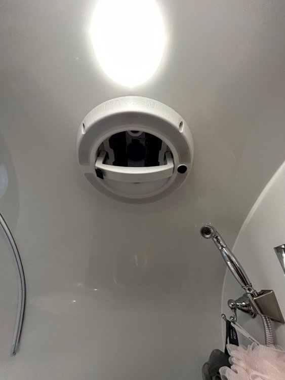

We're on our 2nd road-trip since installing the MaxxAir Dome fan and just realized it won't pop-up enroute unless the "thumb latch button" fails...  It's the black button on the left side of the push/pull handle in pic below:
