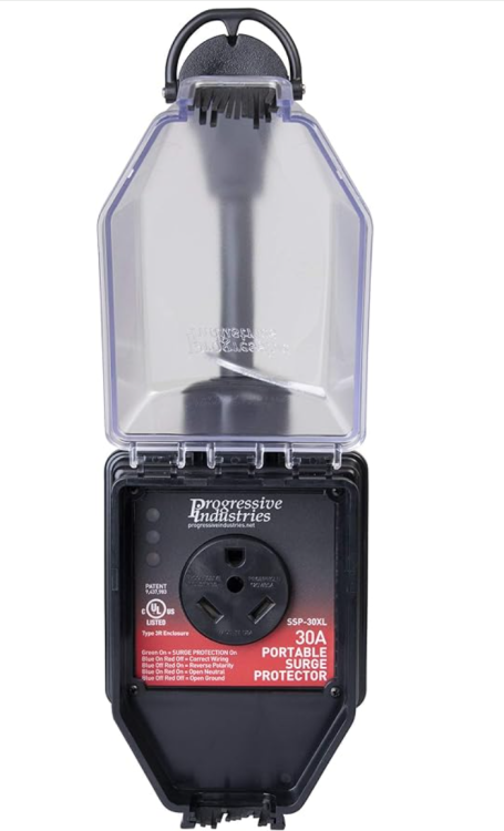

I am a belt and suspenders guy so I think I will get one.  No special hurry but I would value knowing what brand you have.   I am looking at this one.
https://www.progressiveindustries.net/ems-pt30x
29 minutes ago, Dave Mazone said:
That's the one we have. Didn't buy it for the Oliver, we already had it from a previous trailer, but figured we'd use it since we had it. I check the LEDs on it before I plug the Oliver into it as a quick check on the power status.

The top 3 portable EMS surge protectors are Southwire Surge Guard, Hughes Watchdog EPO, and Progressive.
I can only speak for the Hughes Watchdog. It has the EPO feature which will shut off power to the trailer if there is an issue, and turn back on when all is well at the post. It also has Bluetooth so you can see the current status.

The Hughes Watchdog EPO is a great unit. One thing to consider if you're also using a Hughes Autoformer is that the EPO unit should be installed downstream of the Autoformer. If not, when voltage drops to 104 volts the EPO will cut off power completely and and the Autoformer won't be able to do it's job of boosting voltage 10% and keeping it at a safe level.  Ask me how I know!😄
