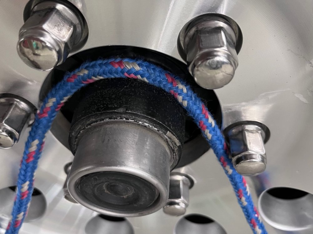

One thing I like about eliminating the chrome hubcaps is that you can install marine style caps with rubber inspection plugs, you can pop off the plugs and easily see if the grease is still in good condition. This lets you extend your service intervals. You must seal the perimeter where they go into the hub with silicone sealer, or they will seep grease and sling it out onto your pretty wheels.
