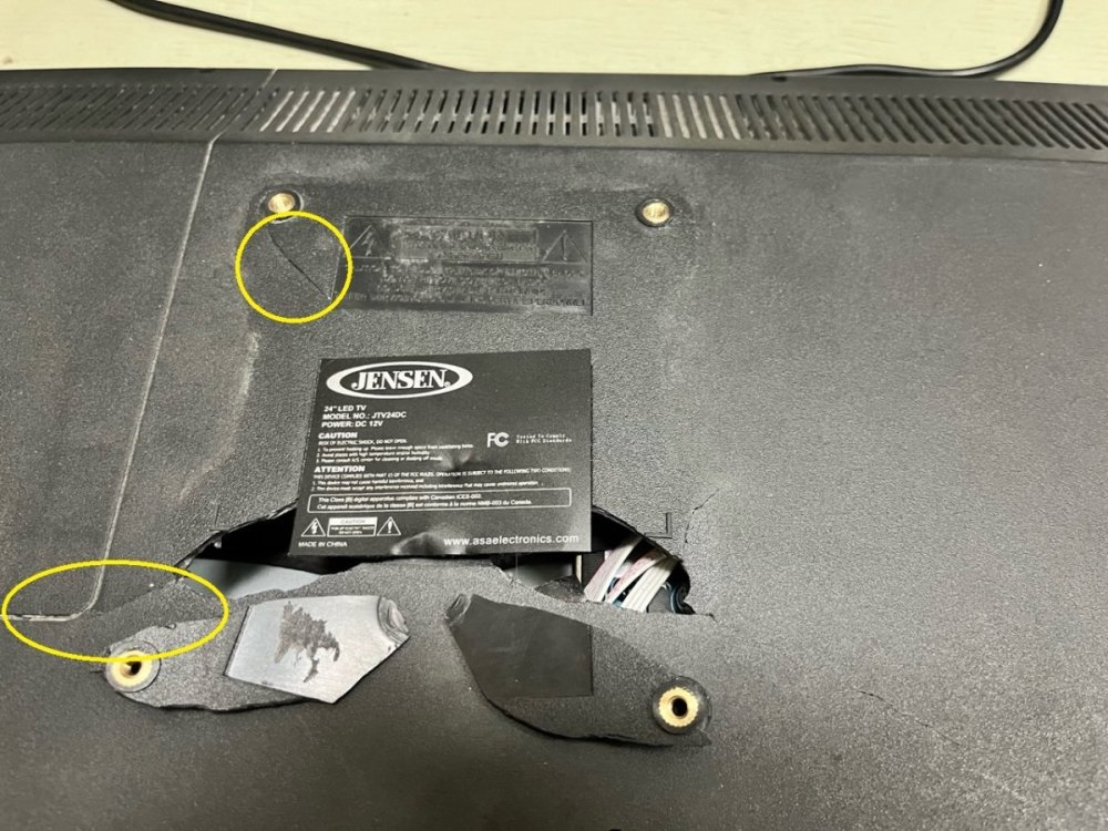

SNY SD UP Posted November 10, 2022 Share Posted November 10, 2022 Our TV actually broke at 2 of 4 attach points (see picture, with yellow circles on addtl fractures) and started to come apart at the back where the bracket attaches to it, so I have removed the TV. Sometimes we would find the TV down when we entered the trailer while stopped between setups. I always pushed it back up to the catch, sometime it was down again, when we arrived at our final destination. I say sometimes, but not always. We would then put it up when we were setup and inside unless we were actually viewing TV, which was like not very often. Possibly caused - by starting out with trailer tire psi of 80 (at delivery) and we did not change that for about the first 10,000 mi, until I started to read threads on recommended tire pressure, then we dropped it to 65psi. It would still come down, but not always, and then we lowered our trailer tire pressure to 55psi. By then I noticed it was beginning to pull apart at the back of the TV. If I had to do over, I would leave it down when under tow, and then raise it up to catch, when we are setup and inside. I never did put in pool-noodle sections to act as shock absorbers. Before our next outing, I will repair the broken area and re-attach it in the trailer. We will however leave it down while under tow... and put it up when setup and Willis (KamperKat) wants to lounge on top of the nightstand. i will also look at any adjustment that can/need to be made on the bracket as mentioned above. Regards, 1 3 Maggie & Bryan | Arnegard, ND | 2020 LE II "Twins" Hull #665 | 2021 RAM 2500 6.4L HEMI Gasser 4dr 6.5' bed Link to comment Share on other sites More sharing options...

John Dehne Posted November 11, 2022 Share Posted November 11, 2022 We travel with ours down to take stress of the tv mounts and have tightened the hinges bolt also. Running 55# tire air pressure differently helped. It would be nice if there was a tv setting to invert the picture so you could watch it while it was up. 😀 1 John & Chris Dehne Manchester, MD. 2021 Elite II twin Hull# 901 “Fiberbeergrass” 2021 Ram 2500 Cummins 4x4 Life is good! Link to comment Share on other sites More sharing options...
Steph and Dud B Posted November 11, 2022 Share Posted November 11, 2022 20 minutes ago, John Dehne said: We travel with ours down to take stress of the tv mounts I've been thinking about this. It does seem that the raised position puts more stress on all the mounting points than the lowered position would. Right?? Stephanie and Dudley from CT. 2022 LE2, Hull #1150: Eggcelsior. Tow vehicle: 2016 GMC Sierra 6.0 gas dually 4x4. Our Oliver journey: Steph and Dud B's RV Screed Where we've been RVing since 1999: Link to comment Share on other sites More sharing options...
Geronimo John Posted November 12, 2022 Share Posted November 12, 2022 (edited) On 11/11/2022 at 11:41 AM, Steph and Dud B said: I've been thinking about this. It does seem that the raised position puts more stress on all the mounting points than the lowered position would. Right?? In the down position, It would put the mounting screws in more sheer. With it up, the TV is resting on the mount. That should take off most of the stress of travels. So my pea-brain says it should be up on rough travels. That said Thanks Seph and Dud B for the oops. If my mount looked like the below, I would consider adding an aluminum plate between the TV and the rack to stiffen up the TV side of things. Edited November 13, 2022 by Geronimo John Corrected tech error by Steph and Dud B. :-) 1 TV: 2019 F-150 SuperCrew Lariat, 3.5L EcoBoost, Max Tow, FX-4, Rear Locker OLLIE: 2018 OE2 Hull 342, Twin Bed. OLLIE DIY’s: Timken Bearings, BB LiFePO4's, Victron 712 Smart, 350 Amp Master Switch, Houghton 3400, Victron Orion DC - DC, 3000-Watt Renogy Inverter, P.D. 60-amp Converter, Frig Dual Exhaust Fans, Kitchen Drawer Straps. TV DIY’s: 2 5/16" Anderson System, Nitto recon’s, Firestone Rear Air Bags, Bilstein 5100’s, Mud Flaps & Weather Tech all, installed Ham Radio (WH6JPR). Link to comment Share on other sites More sharing options...
Steph and Dud B Posted November 12, 2022 Share Posted November 12, 2022 1 hour ago, Geronimo John said: With it up, the TV is resting on the mount In the up position the TV hangs down from the mounting screws. I'd expect the TV case design to account for shear, since they normally hang vertically on a wall, but not for loads applied pulling against the back of the TV. 2 Stephanie and Dudley from CT. 2022 LE2, Hull #1150: Eggcelsior. Tow vehicle: 2016 GMC Sierra 6.0 gas dually 4x4. Our Oliver journey: Steph and Dud B's RV Screed Where we've been RVing since 1999: Link to comment Share on other sites More sharing options...
