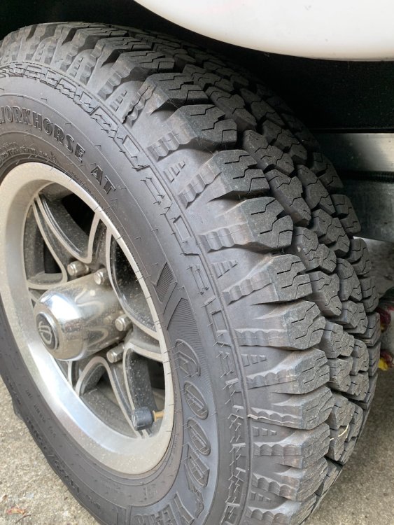

5 hours ago, John E Davies said:
Is Oliver still supplying LT tires on new trailers?
Goodyear Wrangler Workhorse A/T Tires, in LT225/75R16
