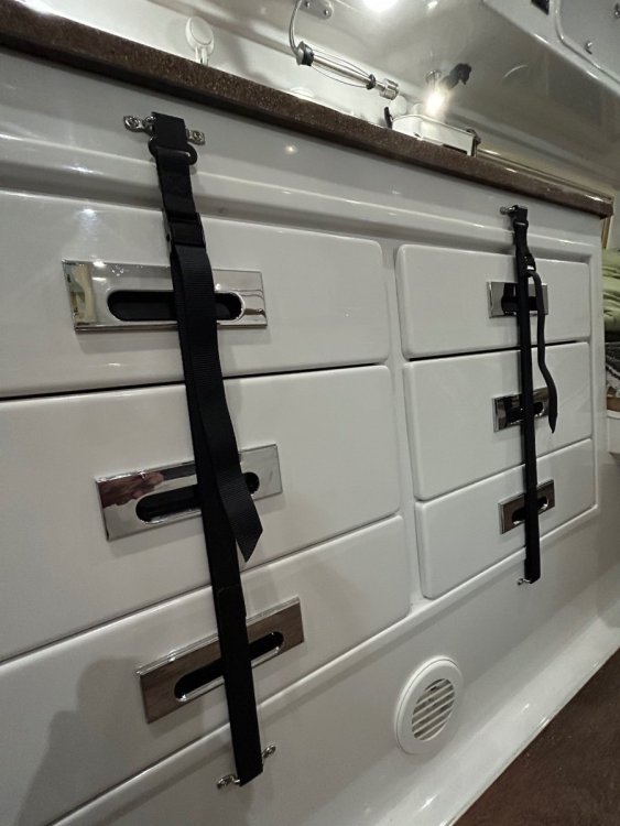

The drawer problem is common in earlier trailers and is easily fixed.  I installed some stainless steel strap loops (from Amazon) at the top an bottom of each bank of drawers, run a tie down strap through them when traveling and they won’t open again.  Is your city water failing or just lose?  It can be tightened with the proper size wrench inserted into the connection.  The shower hose kinking might involve taking off the front of the bath sink to access it.  Not hard to do, you just need to cut the caulk and remove 4 screws.

For example here's a couple ideas for keeping drawers closed while towing:
1. Search for this title - this fix uses bungees and stainless steel tie-downs:
"Kitchen drawers. - keeping closed"
2.  This one uses Raingly tie-downs and nylon straps:

@JRK, I see you have a 2021, so it should have the extra latch on the drawers. Silly question, but do you give the drawers a little push in before you leave - to engage the latch? Also, we had one drawer that opened. It was my wife's plates/bowls drawer. The contents were too heavy. After we redistributed the load all the drawers stay closed now.

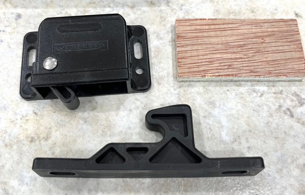

A few months ago, we experienced the launching of our middle right galley drawer onto the deck after perhaps taking a few windy curves a bit too fast and having WAY too many cooking pots/pans inside of it.  The forces ripped the locking mechanisms from their mounting positions underneath the drawer held there by two (IMO) very small wood screws.
The "toothpick temporary" fix was executed in situ while camping that afternoon.  Until just yesterday, we removed all the drawers to inspect for potential water damage as suggested by another forum thread, only to find that the toothpick fix was not holding.  So we removed the short factory-installed drawer screws and replaced them with 3/4" wood screws that reach into the drawer fronts.
It's suspected that the factory builds the drawers, installs the rail hardware before they attach the drawer fronts - makes sense to use shorter screws that don't penetrate the drawer box.  But who knows?  The longer attachment screws are just another effort to achieve a "peace of mind" knowing they'll last a bit longer.  IMO, the longer screws with the Raingly Footman Loops/straps make the drawer system more bomb-proof when towing.
Are you referring to the release handle used to remove the drawers?  The reason I ask is because Oliver has been installing an additional locking devise, as pictured in a post above, to their drawers for several years.
@mossemi:  Yes, the orange and black release handle…
