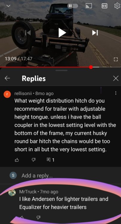

Somewhere in the comments, Mr Truck said this, though he didn't specify what he considered to be light or heavy trailers:
After reading Mr Truck's WDH preferences, I also wondered how he distinguished a light or heavy trailer.  But that really doesn’t matter as long as I know the GVWR/TWR.  My SUV has a 14400 GCWR and a 8100 lb. GVWR/TWR and it requires trailer brakes if the GVWR/TWR is more than 1000 lbs., a sway control device if the GVWR/TWR is over 2000 lbs. and a WDH if the GVWR/TWR is over 5000 lbs.
My utility has a TWR of 3500 lbs. and no brake's, so I break rule #1 and #2 every time I use it.  Ollie left the factory at a slim 5180 lbs. and a GVWR/TWR of 7000 lbs., so I can add 1820 lbs. of cargo to the trailer.  And following the 80/20 rule, that's 80% for her and 20% for me.
So I think the difference between a light and heavy trailer depends on your tow vehicle.  And in my case, both of my trailers are heavy.
